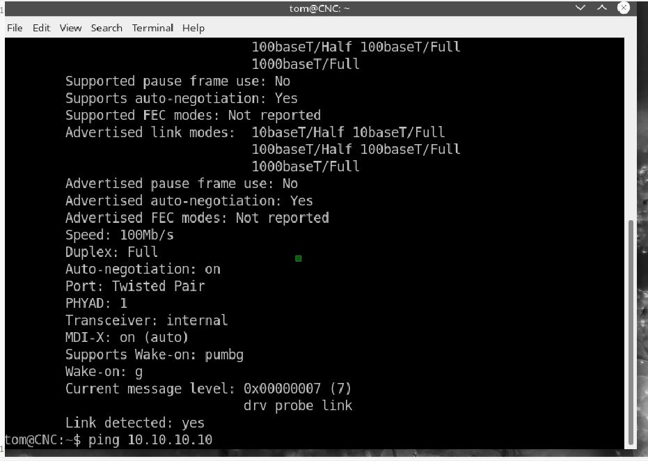

Thanks for your reply, understand I am a newbie with Linuxcnc. After searching the web (and search here) to seem if I could understand the IRQ coalescing disable.
You had suggested using the command sudo ethtool -C enp0s25 rx-usecs 0 to see if that cleared up the problem. I understand that is not a real fix, just a test. I will do that, also other info talks about disabling
vitualization in the BIOS of the PC may help as a fix
If I am incorrect please elaborate

Yes,
will only change the IRQ setting until the next reboot
But it should improve network latency, which you can test by pinging the FPGA card
before and after the ethtool command
To make the fix permanent, you add the command to the interfaces file as described
in the hm2_eth manual page

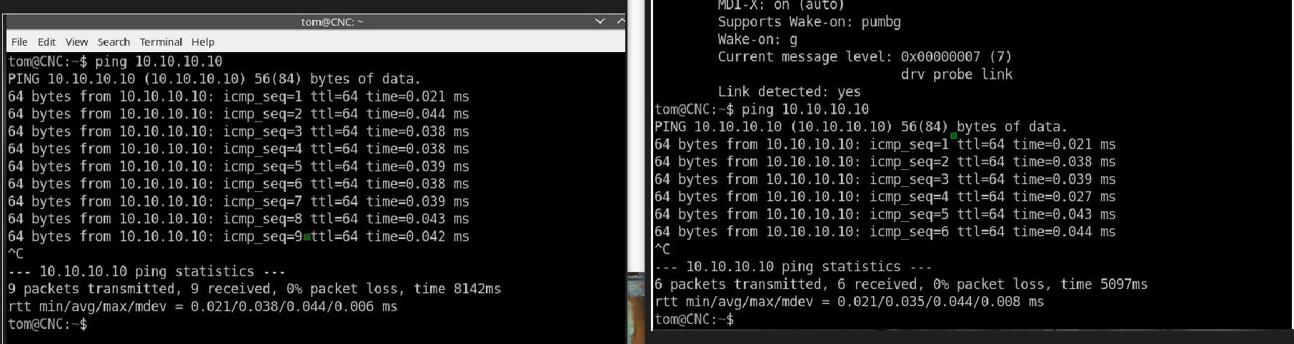

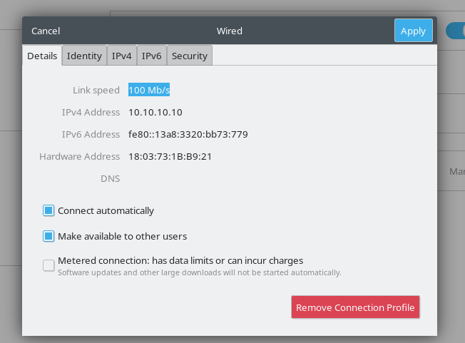

Those ping times suggest that you are not pinging the FPGA card but the host itself
(that is you have the host IP address set to 10.10.10.10 rather than say 10.10.10.100)

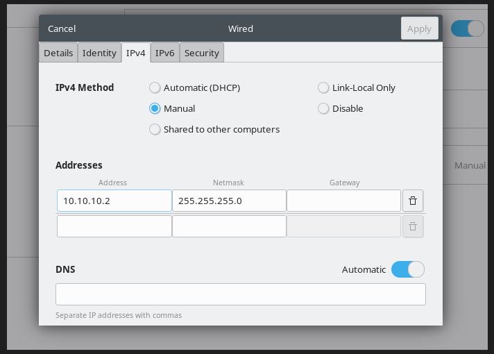

In the IPV4 tab, set the IP address to 10.10.10.X
Where X is not 0, 1, 10, or 255
Also disable IPV6 addressing
Last edit: 16 Jan 2023 17:43 by PCW.

Do I need to remove and enter it as a new connection???
- Posts: 18080
- Thank you received: 5316
16 Jan 2023 18:50 #262153
Replied by PCW on topic I need an answer
No, you edit the existing connection
