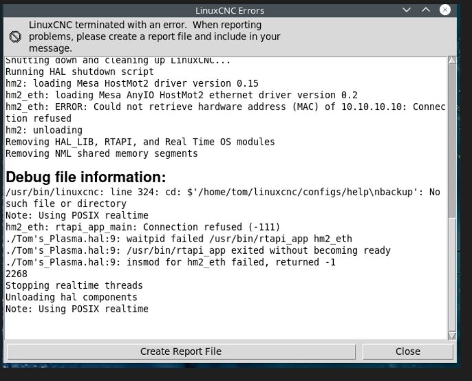

Maybe these will help to see what is going on, I cannot start any GUI after I entered the command (sudo ethtool -C enp0s25 rx-usecs 0)Here is the error and report from that.

Well, you managed to change is to 10.10.10.1...
Its a bit hard to give help as it seems the GUI network configurators differ quite a bit depending on what's included with the specific Linux distribution you are using...
The alternate way (shown in the hm2_eth man page) allows you to set the ethtool option
and ip address in a way that is permanent (but not so friendly as the GUI network configurator)

The error you have means you cannot communicate with the FPGA card
(perhaps because the host IP address is still 10.10.10.10)

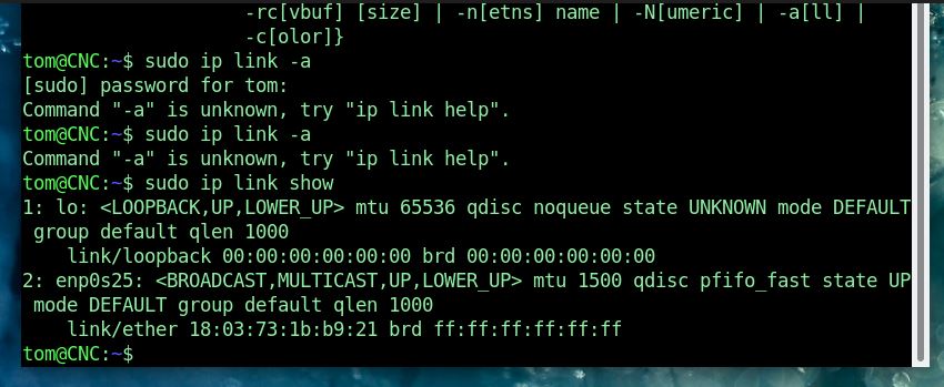

What does the command:
ip a
report?

16 Jan 2023 21:18 - 16 Jan 2023 21:21 #262169
by acourtjester
Replied by acourtjester on topic I need an answer
Last edit: 16 Jan 2023 21:21 by acourtjester. Reason: edit

Yeah enp0s25 does not have a static (10.10.10.x) ip address setup so cannot
You either need to beat the network GUI into submission or use the alternate method
of setting the IP address in the interfaces file
