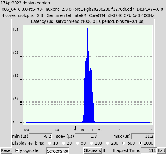

17 Apr 2023 10:38 #269293 by rodw
Replied by rodw on topic error finishing read
I have just tested the 6.3-rc5-rt7 kernel and it has improved Ethernet latency
At least on my test machines, it seems as good as 4.19
I can confirm this. Latency from 6.1-7 kernel currently shipping with the latest Debian 12 (Bookworm) has improved by 265% with the custom built 6.3.0-RC5-8 kernel from pristine sources. Error Finishing Read seems to be eliminated
on this Resltrk R8111 NIC which has always proved problematic. This is still with the default R8169 driver as I was unable to install the R8168-dkms driver on the custom kernel. I m hoping Debian have added improvements to the default driver.
A short test but I've previously done tests overnight with youtube.

28 Apr 2023 22:08 #270140 by rodw
on at least 2 of my test systems: ~4 days LinuxCNC running with YouTube videos
and no more that ~300 usec read tmax and 0 dropped packets at a 1KHz servo thread.
