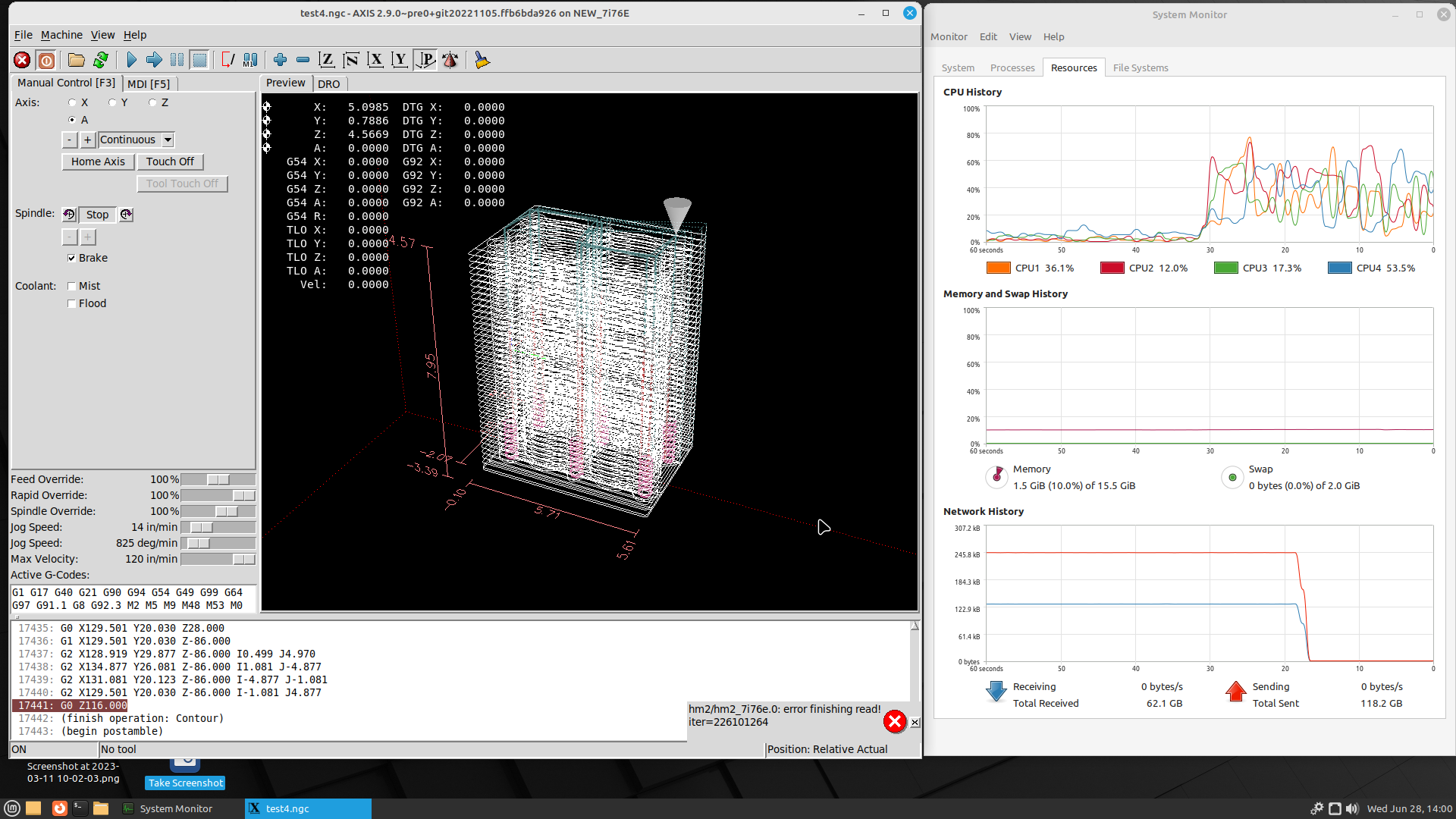

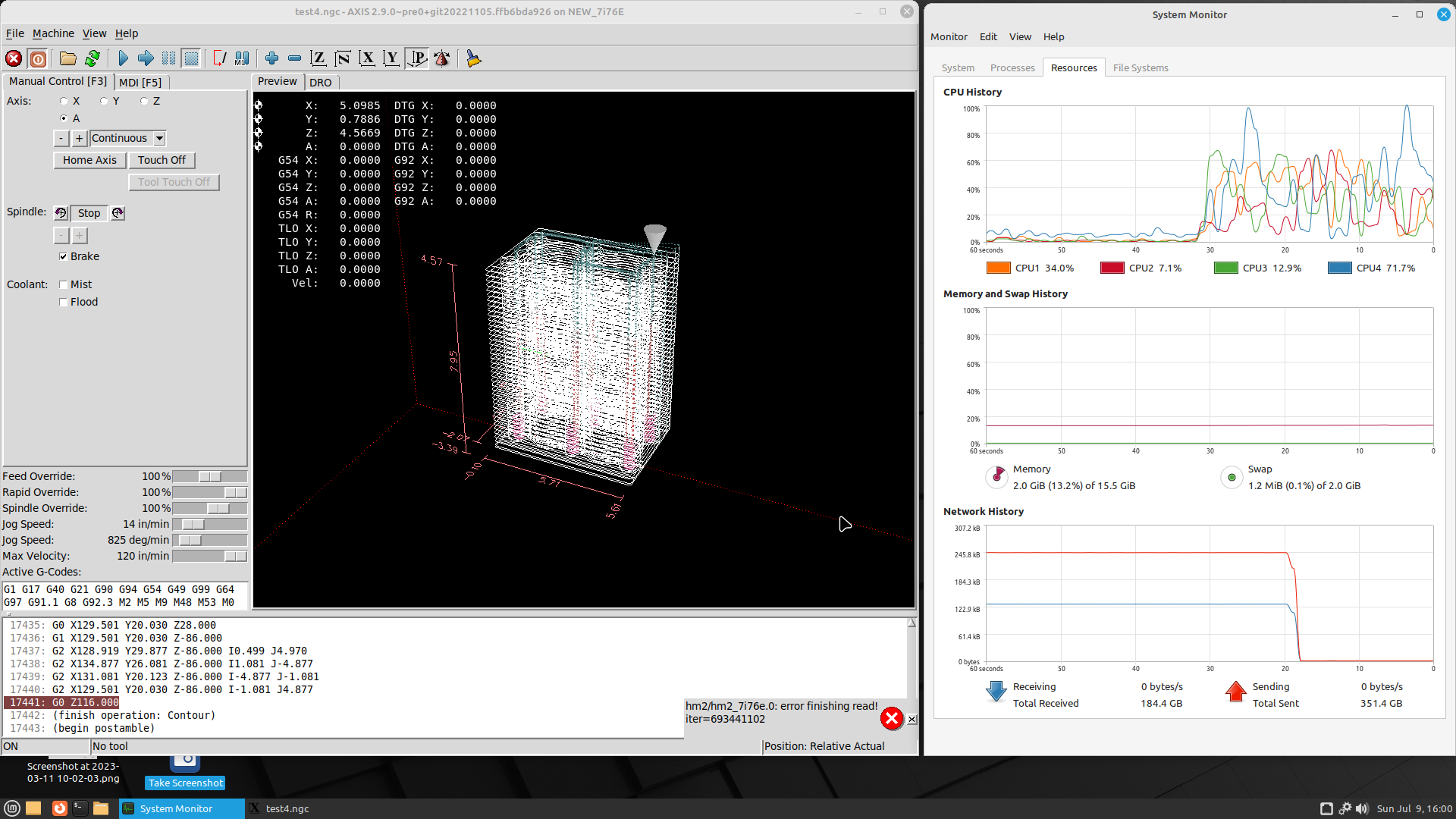

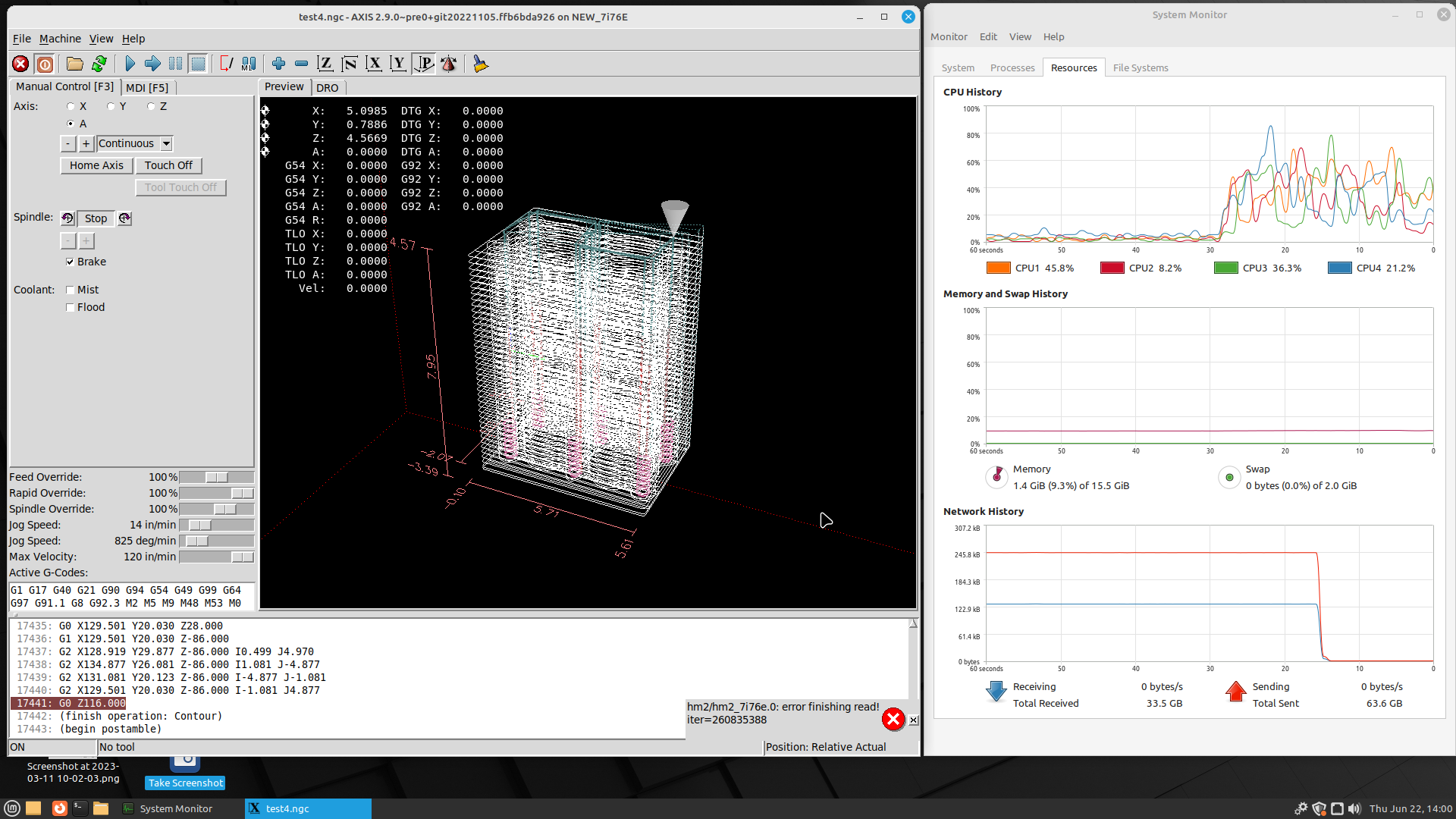

Anyone have any ideas on this? Failure only happens on the hour and then days or weeks apart. Look at the time and date on failure.
- scotth
- Posts: 242
- Thank you received: 61
09 Jul 2023 21:40 #275088
by scotth
Replied by scotth on topic error finishing read
And the machine is normally not running.

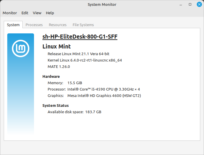

What Ethernet card do you have? Follow these steps to find out
linuxcnc.org/docs/2.9/html/getting-start...ltek_network_drivers
And read it all if it's a Realtek
If it's an Intel NIC, be sure to add the coalescing settings as per: man hm2_eth
- Posts: 21901
- Thank you received: 7465
09 Jul 2023 22:10 #275093
Replied by tommylight on topic error finishing read
2 things:
Use only the original power brick for that PC, never cheap ones
Check if it has an add on graphic card and remove it.
- Posts: 18080
- Thank you received: 5316
09 Jul 2023 22:25 - 09 Jul 2023 22:39 #275095
Replied by PCW on topic error finishing read
In addition to what rodw said about disabling IRQ coalescing:
1. Are you using the 10.10.10.10 address? (you should)
2. On that hardware make sure you disable AMT in the BIOS.
(Don't want Intels management engine doing random accesses
to the Ethernet hardware)
I have more than 1 month uptime on identical hardware with not only no
"error finishing read"s but 0 timed out packets.
(You need 5 timed out packets in a row to trigger an "error finishing read"
error with default settings)
Last edit: 09 Jul 2023 22:39 by PCW.
