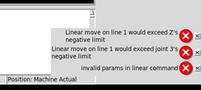

Error: Program Exceeds Machine Maximum, but gcode looks fine

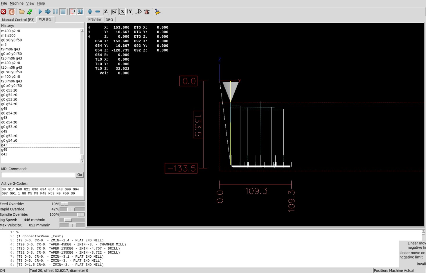

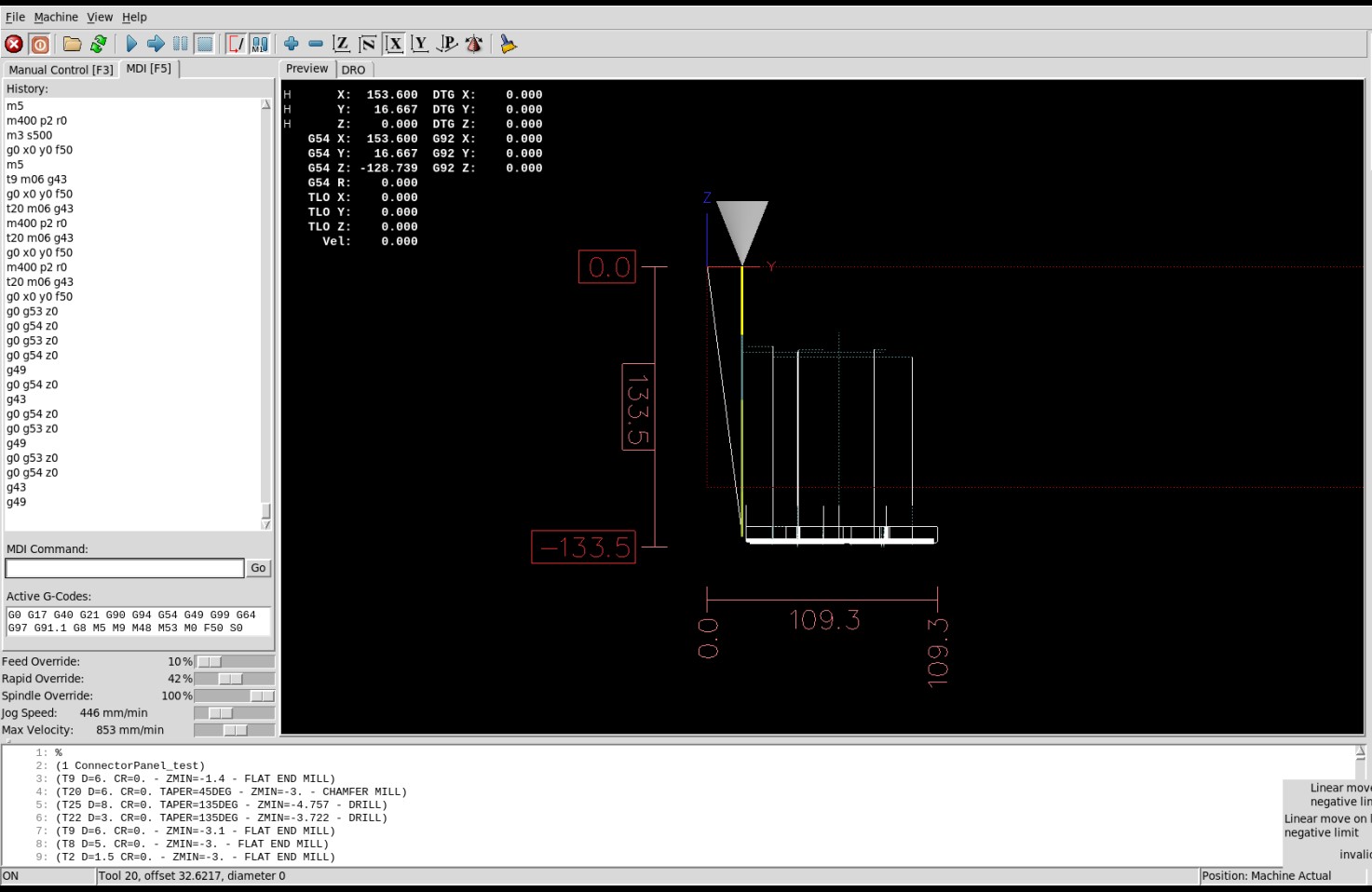

05 Jun 2023 23:51 #272985
by re_relentlessly
Replied by re_relentlessly on topic Error: Program Exceeds Machine Maximum, but gcode looks fine
interesting results
results in the z axis moving all the way down (closest to table)
results in an error
Also you can see in the screen shots that g49 results in no z offset of the gizmo
while g43, results in a gizmo offset equal to the tool length offset
results in the same error about exceed both z min and z max
g0 g54 z0results in the z axis moving all the way down (closest to table)
g49
g0 g54 z0Also you can see in the screen shots that g49 results in no z offset of the gizmo
g49
load gcode

Ok, so my limit switches and home switches might be configured oddly, and my accelerations may be high, but this still doesnt help me understand my original issue with the linuxcnc gcode preview not showing any out of bounds moves, but it still complaining about z axis limits being exceeded.
