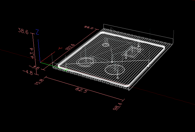

If you post the g-code, i can have a look at it

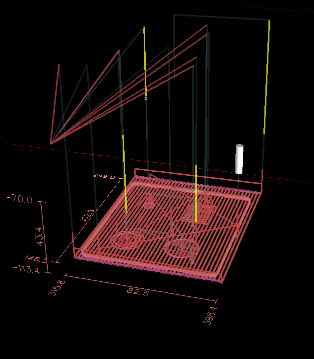

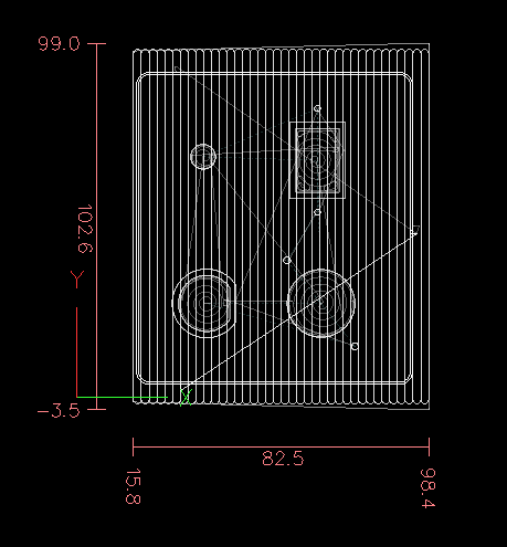

In your file, there was before toolchange 'M6 G43' which produced an error 'no tool prepared'. I replaced that by G0 G53 G49 Z0.
The simulation finished without problem. The x and y offset of the part is a bit off, maybe difficult to touchoff.
Maybe your workflow with offset / toollength has a fault.
In my environment when i start a new job:
- G49
- Touch off first tool Z
- G43
- Touch off Z to workpiece, G54
- Touch off X and Y also
Last edit: 07 Jun 2023 22:22 by MaHa.

Ok, i will go test that out, but before I do
1. the x,y,z gizmo should be at the g54 touch off point? (after touching off the x,y,z 0 of the part the gizmo should be located at g54 0,0,0)
2. how do you load tools without T20 M06 G43? (which for me also invokes the auto tool length measuring)
3. I do x,y g54 first because I have to load a edge finder into the spindle, and then load the tool (which means re measuring tool length), would the touch off order matter?
