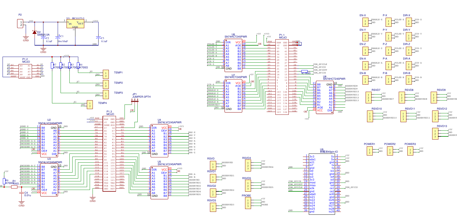

26 Jun 2023 13:12 #274274
by Donno
Replied by Donno on topic Schematics for 7c81
I think i will design the Port one as a Parallel out and port 2 as a Parallel in and use 74HCT245 as output IC's and 74LVC245 as the input IC's. As per these schematics :
The 74 245 are quite plentiful:
www.lcsc.com/search?q=74HCT245
www.lcsc.com/search?q=74LVC245
And then output with terminal screw that resemble my breakout board i posted.
Port 3 will i leave as through hole for later development or prototyping.
I see there are a lot of SP491 available from this supplier so i will just copy the RS-485 Schematics www.lcsc.com/search?q=SP491

21 Jul 2023 09:28 #275954
by Donno
It is going good, manage to fuse the 7c81_5abobx2d.bit to spartan 6 and playing around with Xilinx ISE 14.7 for custom builds. I have ordered some IC SP491 and 74lv04 that i am waiting for to test modbus, also waiting for 7I92TH from mesa.
After testing and playing around i will complete circuit with EASYEDA, in the end i will probably have FGPA with 2 x Parrellel ports(16 output/18inputs) and 2 x Serial/modbus ports replacing the PI5C16211 with SN74HCT245N
This is a really steep learning curve for me because i am new to FGPA's but i will try and get this done

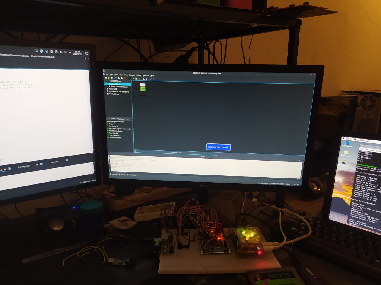

- Donno
- Posts: 137
- Thank you received: 17

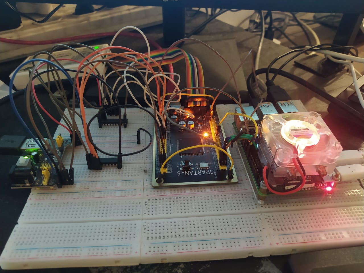

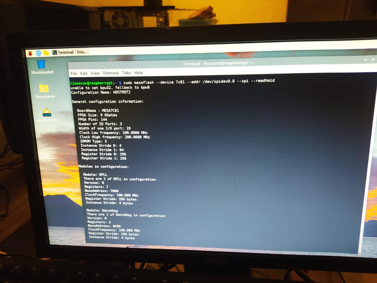

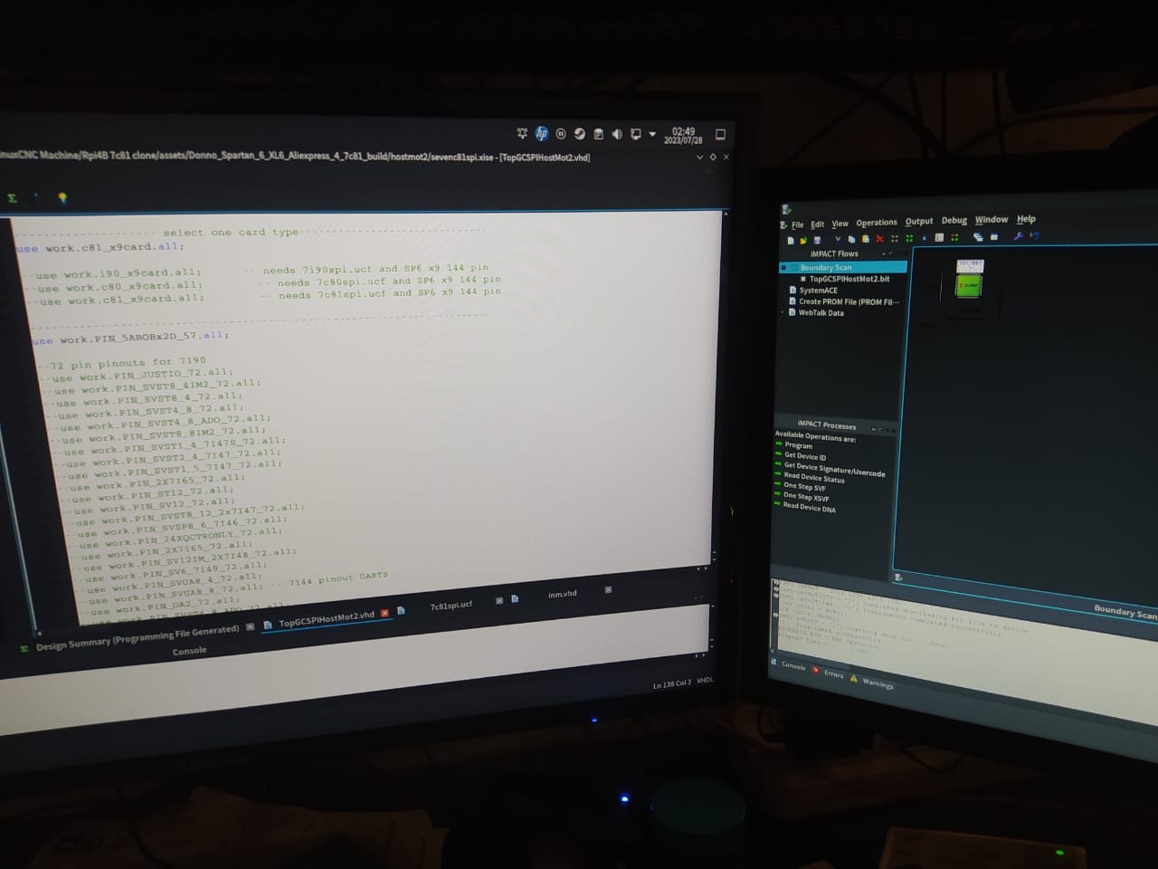

27 Jul 2023 20:09 #276415
by Donno
UPDATES
I manage to compile bit file and write it to Spartan 6 xl9. I did try to use a generic bit file (7c81_5abobx2d.bit) but my clock pin is different than on the mesa 7c81 board (P50 -> P55) so had to first figure out how to do that. I used Xilinx ISE 14.7 and this link Making bitfiles for MESA Hostmot2 boards added missing source file and got it compiled.
I can now play around with the electronics

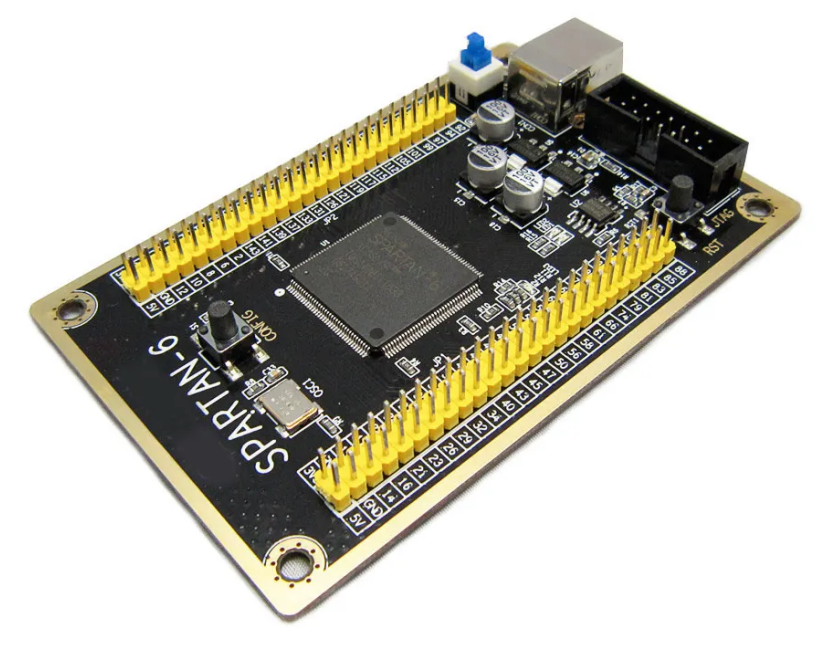

27 Jul 2023 20:59 #276420
Replied by Cant do this anymore bye all on topic Schematics for 7c81
Thanks for the link
Is that your FPGA board or a dev board (any more info on it)?
- Donno
- Posts: 137

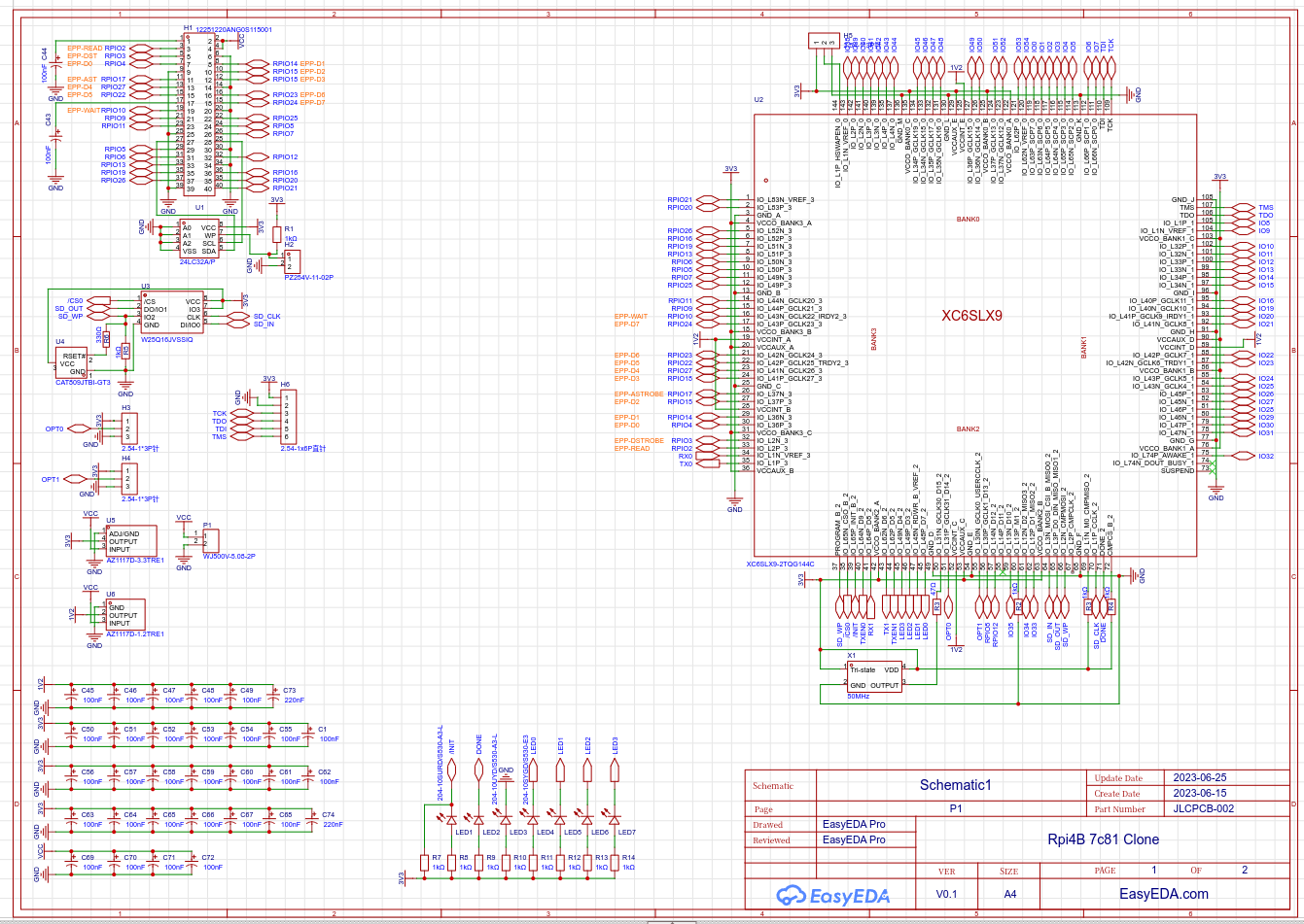

28 Jul 2023 01:04 #276434
by Donno
I bought it on
Aliexpress
I have also added the schematics and PCB layout. NOTE on the schematics it says 25Mhz Oscillator it is actually 50Mhz.
If you are new to FPGA's buy this JTAG Cable it works really great DLC10 Xilinx Platform Cable
