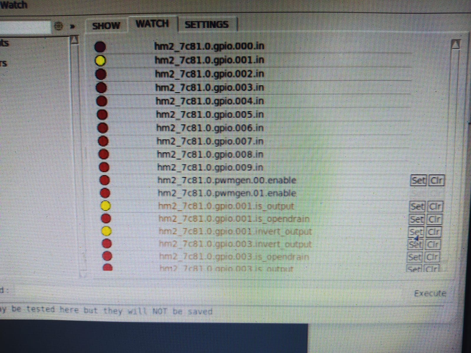

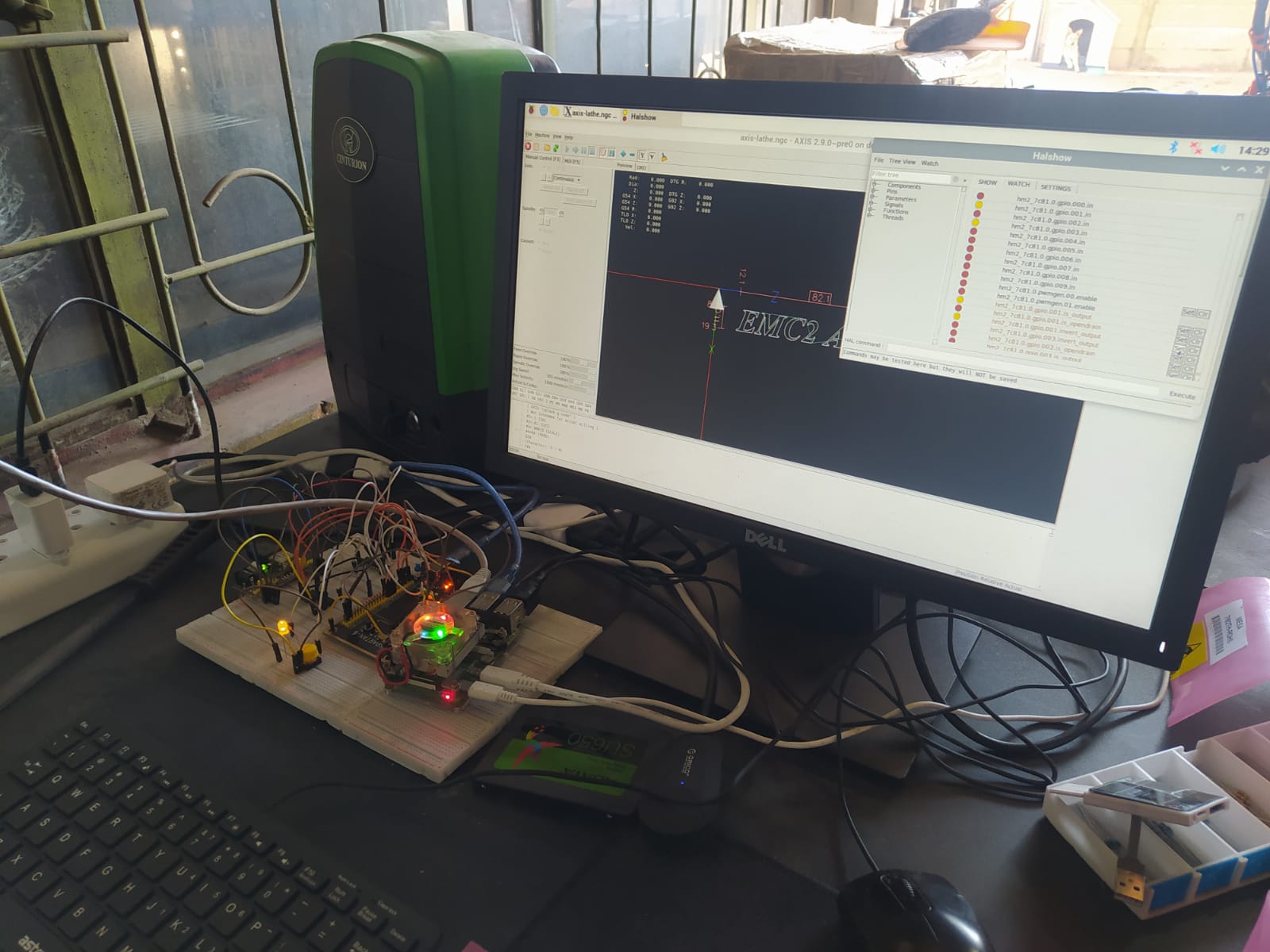

UPDATE
I made progress setting up LinuxCNC 2.9 with the 7c81 on my Spartan 6 dev board :
WARNING The Breakout ain't pretty
I will be abandoning this project because of a few factors :
- I received my 7i92TH's from mesa and will be focusing on connecting my custom breakout board
- The shortage of SN74CBT16211 as to using the 74 254 for a more specific breakout
- Cost as JLCPCB as a min of 5 PCB to order.

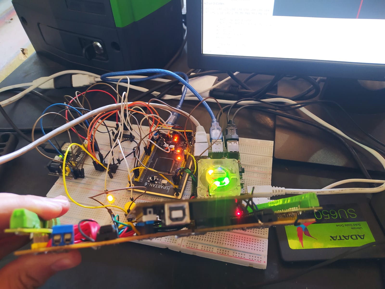

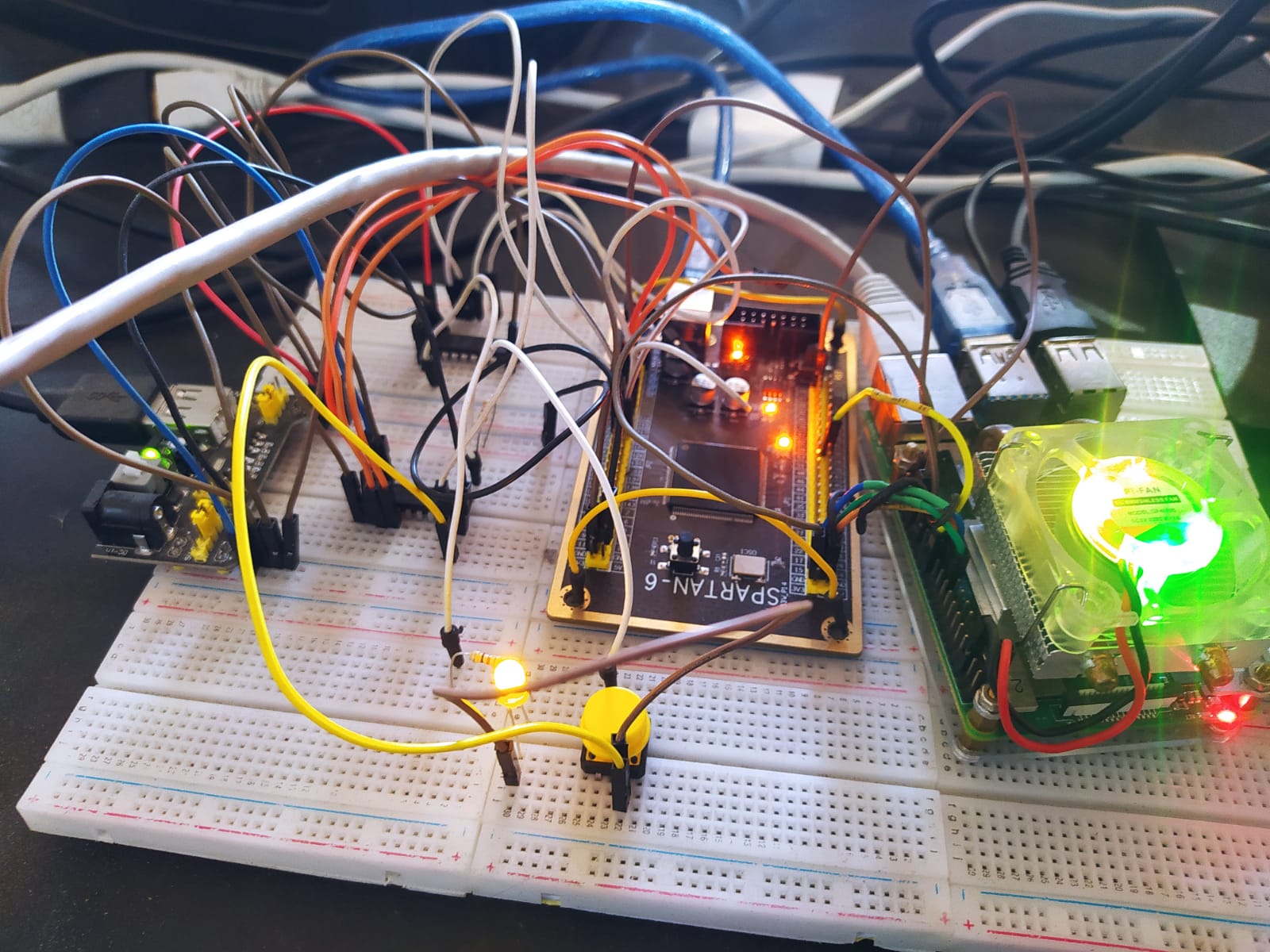

Replied by Cant do this anymore bye all on topic Schematics for 7c81
I've just got the 7c81 firmware running on a Mimas Spartan-6 dev board. Got some let over breakout boards I used when I was running MK on a BeagleBone Black, so the 5v/3v3 translation isn't an issue.
Just over the weekend I ordered the dev board you linked to earlier.
Current setup for experimentation.

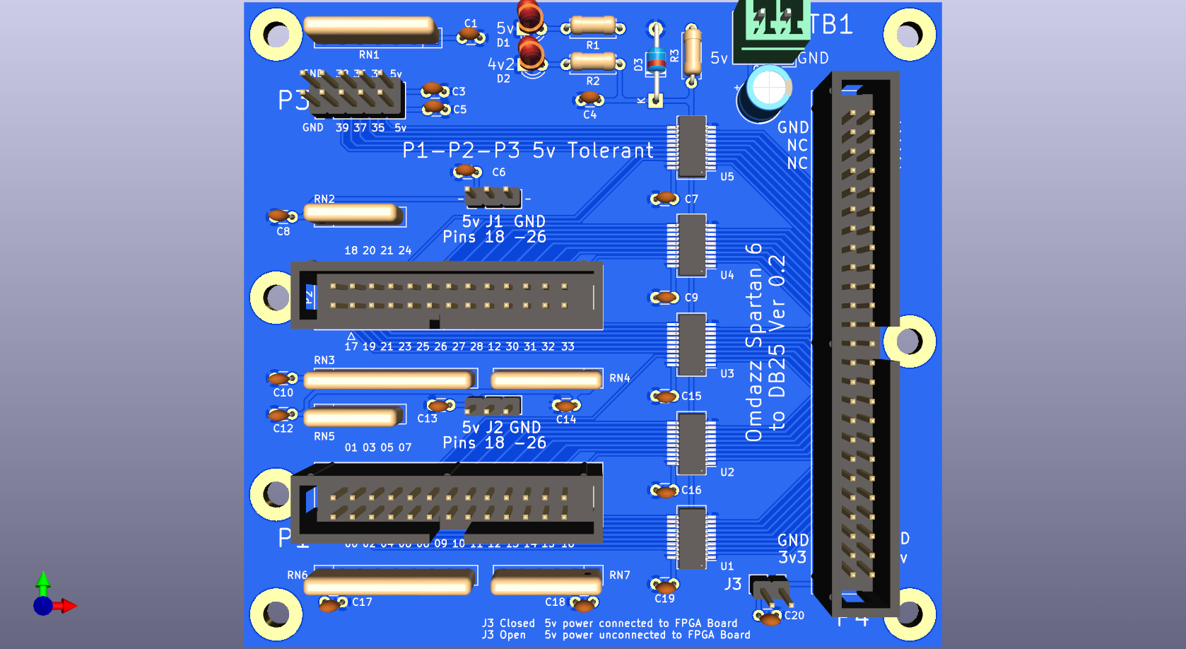

28 Sep 2023 20:15 - 30 Sep 2023 19:50 #281829

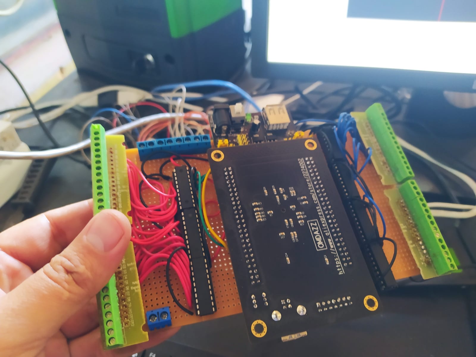

Further to my adventures with the Omdazz Spartan 6 dev board as discussed in this thread I've been designing a interface board to make life a little easier.
- It uses SN74CBT3245DBQ to perform level shifting, zener used to provide 4.2v voltage.
- 2 DB25 connectors which can be used with generic Parallel Port BoBs or MESA DB25 daughter boards (I recommend genuine Mesa products, but my situation pushes me this way forward).
- 6 extra I\Os on a 2x5 pin header includes 2xGND 2x5v (smart serial ports or whatever).So essentially 40 pins to use.
- Through hole components except for ICs.
- Pictures tell 1000 words, board is reasonably labeled IMHO.Still need to design another board to use the 32 other pins that 7i90HD allows (72 pins all up), and for the SPI connection.

29 Sep 2023 00:33 #281837
by Donno
Replied by Donno on topic Schematics for 7c81
- Posts: 1200
- Thank you received: 426
29 Sep 2023 01:23 #281838
I'm not in the habit of mounting the electronics to the machine itself. So unless there's gunna be an earthquake in Sydney....
