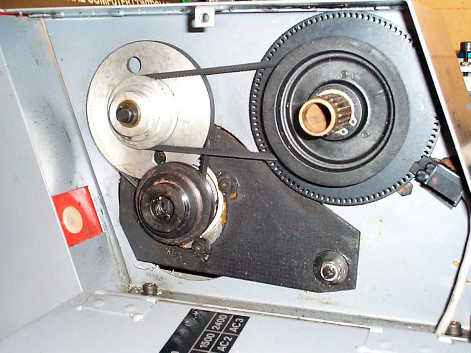

06 Jul 2023 08:56 #274891
by spumco
Replied by spumco on topic First 7i96s/lathe build question: AC Servo driving spindle
OP -
If the picture of a Compact 5 I found is accurate, you don't need anything complicated to thread.
This appears to be the Compact 5's spindle-mounted encoder wheel, and the original spindle motor appears to be a simple brushed DC motor, which I believe was rated at 440w.
Assuming you wish to pursue the servo motor path, the servo's encoder can be used as a (much) higher resolution feedback, and the original spindle plate replaced with one that has a single slot. Or fill one of the existing slots and use LCNC's "missing-tooth" function to trigger the index signal (search forum for 'missing tooth')
On the other hand, if you have the original DC motor drive LCNC can almost certainly control it as-is - probably using the 7i96s analog output. No further hardware or sensors would be required for threading as the encoder plate output can be connected to LCNC.
The article I found indicates the Compact 5 had a spindle range of 50-3200rpm, accomplished with a 3-position step pulley. As I mentioned before, if you switch to an AC servo you probably want to also change to a ~1.5:1 belt ratio and skip the multi-step pulley arrangement.
I'm pretty sure a 1kw servo driven at 1.5:1 should perform the same or better than the 400w DC motor with more reduction - and no fussing with belt changes.
