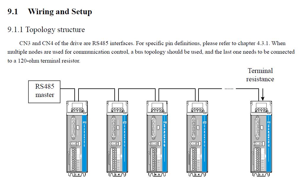

To add to the massive amount of questions, i just had the manual for the AC servos I am considering sent to me by the seller from Aliexpress (Lichuan). Under "Chapter IX MODBUS Communication", I find the following written (see attached picture).
Does this mean I can control all AC servos (1x 1kW for the spindle, plus 2x 200W for X and Z) with only the RS485 interface? Or is it to be intepreted like the RS-485 interface on the drivers is only there to aid setup and tuning by means of a computer?

A 7I84 or 7I73 are common Serial expansion devices used with the 7I96S
It sound like the drive support Modbus. There is experimental Modbus support
for the 7I96s (and most Mesa cards) but it still has a few known bugs

It works, i have seen it used on industrial machines for automated food and drink lines, but never on a cnc machine to actually control machine axis, it is used on some ATC, vacuum hold downs, some hydraulic stuff, spindle feedback, etc.
Replied by tommylight on topic First 7i96s/lathe build question: AC Servo driving spindle
This is my personal opinion, so take it as such, i would never use RS485 to control a cnc machine, ever.Does this mean I can control all AC servos (1x 1kW for the spindle, plus 2x 200W for X and Z) with only the RS485 interface?

I will definitely move away from that idea.
