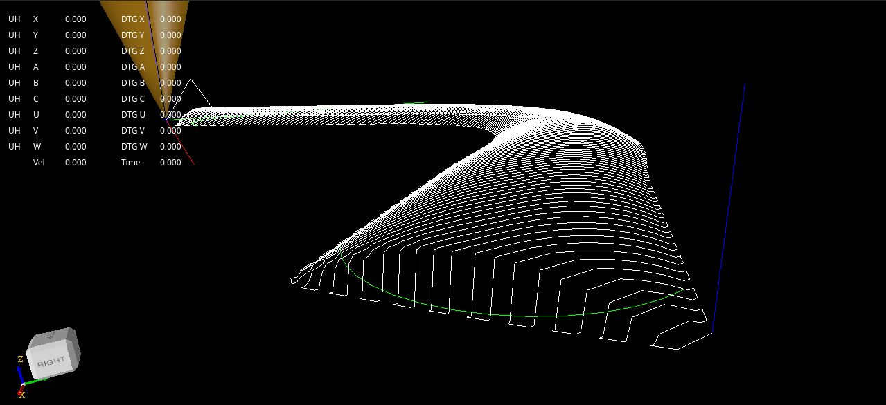

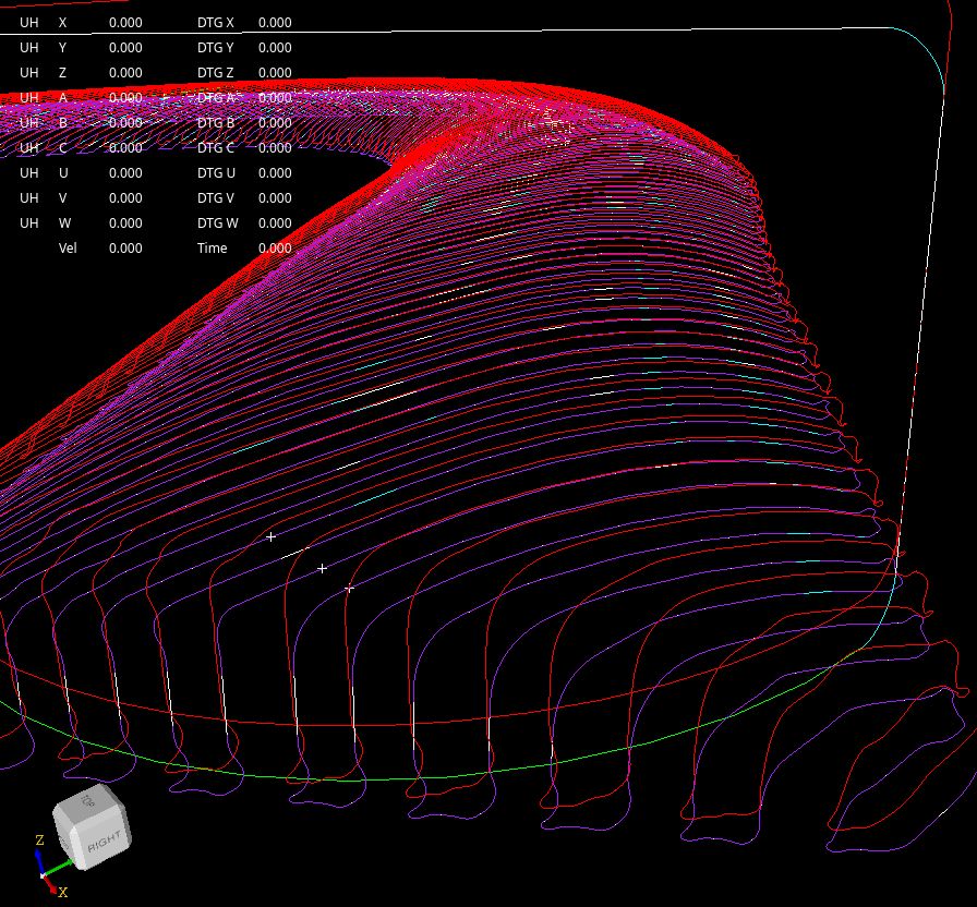

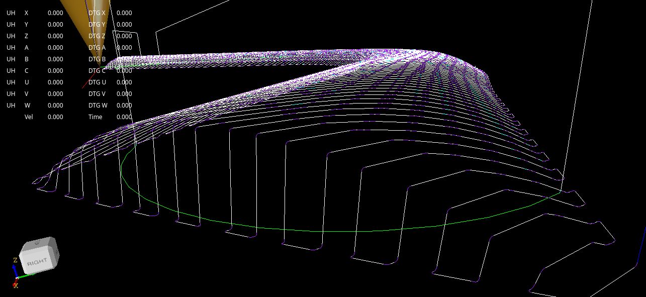

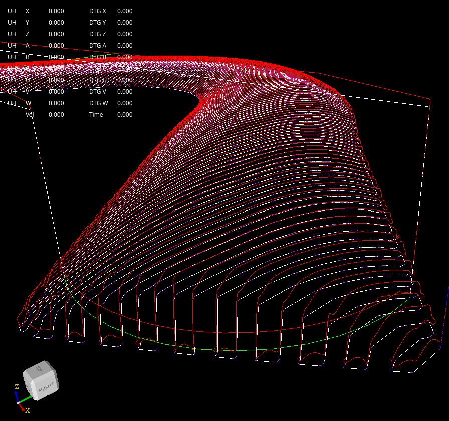

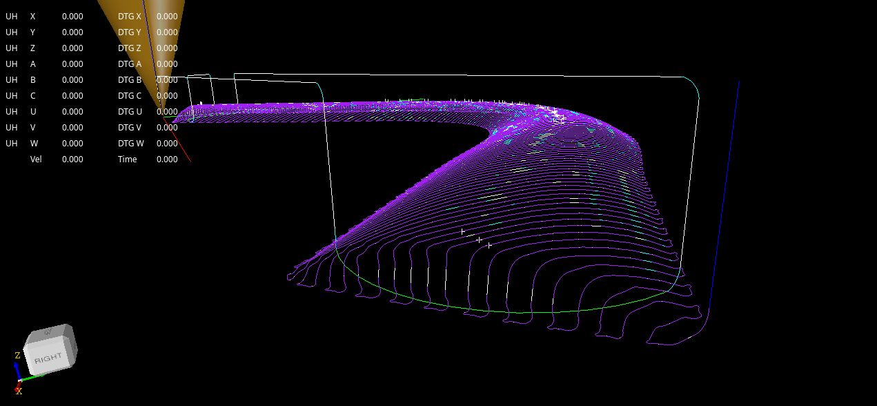

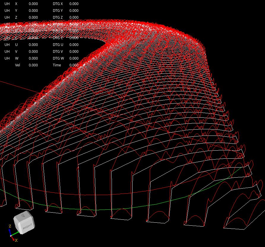

01 Aug 2024 20:32 - 01 Aug 2024 20:39 #306670 by Grotius
Replied by Grotius on topic Trajectory Planner using Ruckig Lib
A boomerang test file :
fillets 0.01mm
fillets 0.1mm
green is an arc, its a cut off for the boomerang tip shape.
purple is clothoid fillets.
cyan is spline fillets.
white is line.
vel profiles G64 P0
vel profiles G64 P0.01
vel profiles G64 P0.1
