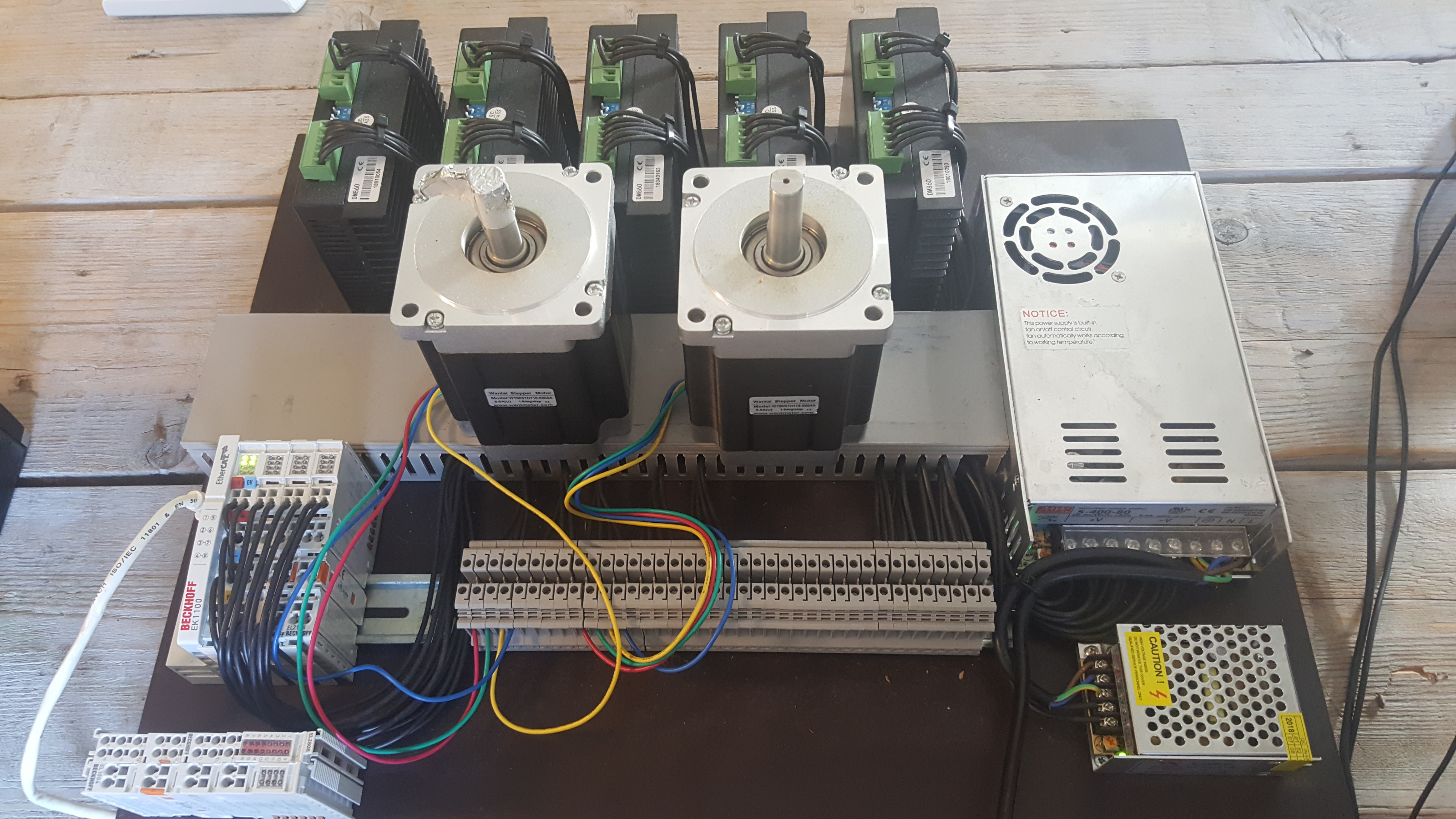

I found out the problem.
This is a test board i made a few years ago. It uses ethercat and drives stepper motors.
I found out that i can run the testboard on hal-core with a sample script.
This scripts only load's the stepgen.so and the lcec.so. It drives just one motor.
When i set a new position using halcmd : ./halcmd setp stepgen.0.position-cmd 1000
It runs to that position, as it should. The stepper sounds nice, and is quick.
So the underlying problem is the trajectory planner of halcore. This consumes too much time as it
is also added to the servo update thread. It slows down the servo update thread. I think this is the cause
that the production machine on the parport also run's not good.
So i will qreate a chrono timer, to first measure the total time of the trajectory planners cycle.
I expect it will exceed the 1ms time of the servo update cycle, but i don't know for sure at the moment. We will find that out.
Then we have to pin point where the time consumers are located in the trajectory planner.
So far i am happy that the ethercat works ok.

I spent a few day's finding the problem of my current situation, where the production machine was not
working as should, both on parport as on ethercat.
The problem is that the stepper motors where rotating very slow and hickey on ethercat.
Where this normally should run with more speed then a parport.
I did a few iso install's including the linuxcnc iso. 4 day's of trying to figur out the problem and no luck.
I even thought yesterday, maybe i have got infected by Stuxnet. Because the ethercat test board has worked without
any problems a few years ago and now it was not working good at all.
In previous post a was able to run a script to run the ethercat steppers on hal-core. So this morning i extended the
succesfull script to finally run the cnc program with it without any problems anymore.
To run the ethercat test board along with the cnc app :
Warning: Spoiler!
So this start first the "runtest_4_axis_state_machine", this is a script that starts the hal environment with the components.
Then it start the cnc program.
Now this is working as should be.
In the previous i was starting the cnc program as first, then loading the hal environment. Maybe this was causing trouble.
I have readed that user db1981 has also mentioned, first load the important hal stuff.
So in the end, the problem was not a compromised debian iso or a stuxnet or a zero day. It was just loading the
hal & program in wrong order.
Now the ethercat board also failed on a fresh linuxcnc installation yesterday, it moved the motors very slow and hickey,
maybe i have to look what was going wrong there as i now know it runs ok on halcore.
