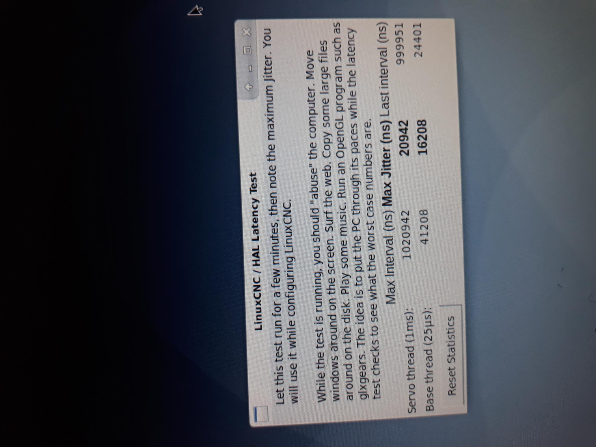

08 Nov 2023 21:36 #284904
by jarcysgru
Replied by jarcysgru on topic Please how should I install new realtime new kernel for linuxcnc 2.8.4
Attachment not found

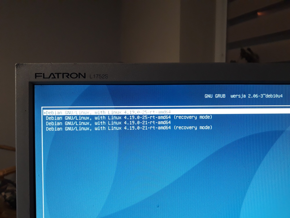

- jarcysgru
- Posts: 104
- Thank you received: 6
08 Nov 2023 21:39 #284905
by jarcysgru
- Posts: 12138
- Thank you received: 4141
09 Nov 2023 10:17 #284928
Replied by rodw on topic Please how should I install new realtime new kernel for linuxcnc 2.8.4
Download and install the latest Bookworm ISO from the linuxcnc Download page

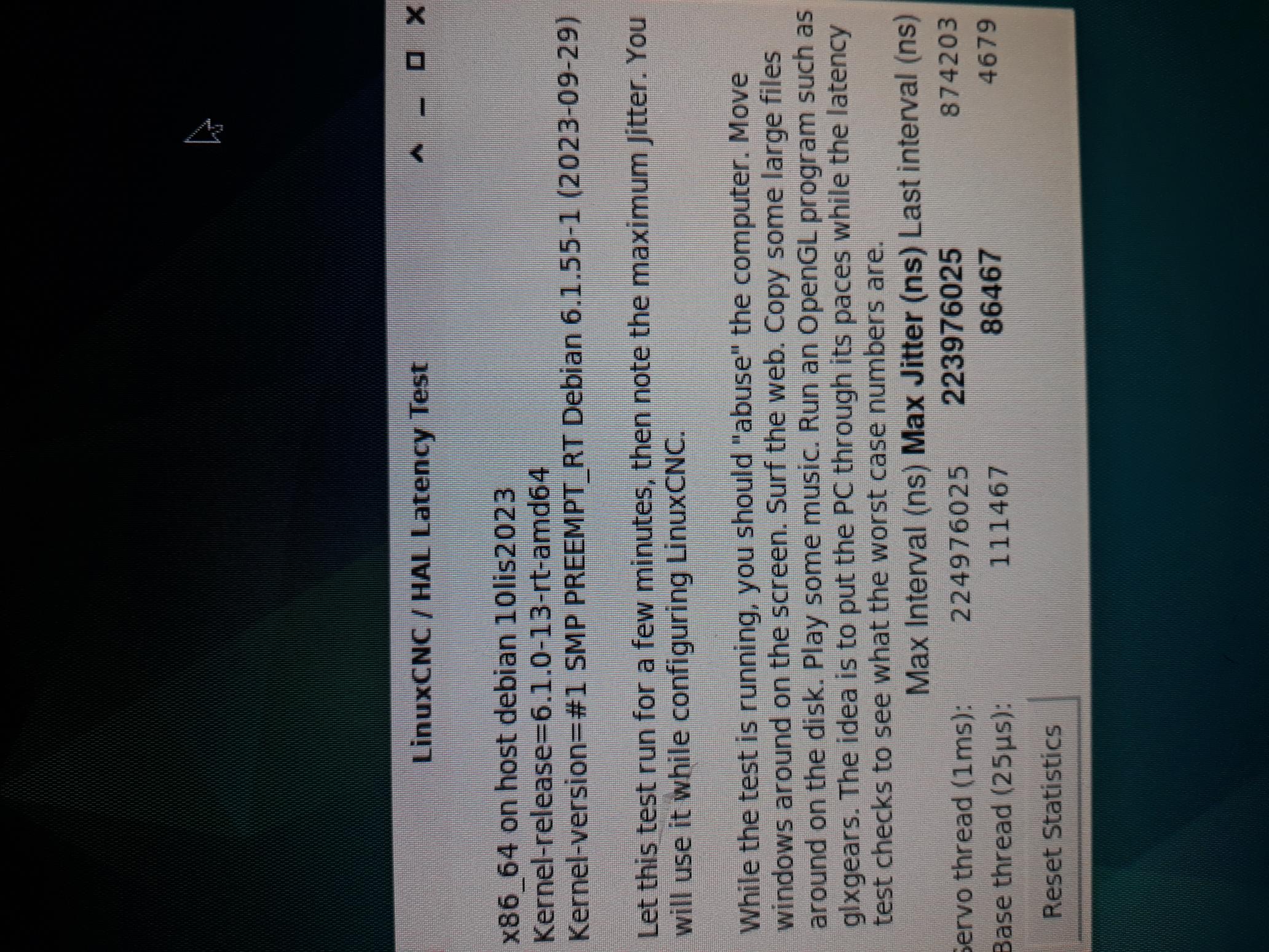

10 Nov 2023 19:22 #285039
by jarcysgru
- Posts: 21901
- Thank you received: 7465
10 Nov 2023 19:31 #285040
Replied by tommylight on topic Please how should I install new realtime new kernel for linuxcnc 2.8.4
That is terrible latency, so pretty sure the PC is near it's demise, but do give this a try
forum.linuxcnc.org/18-computer/40285-bios-settings-pictures

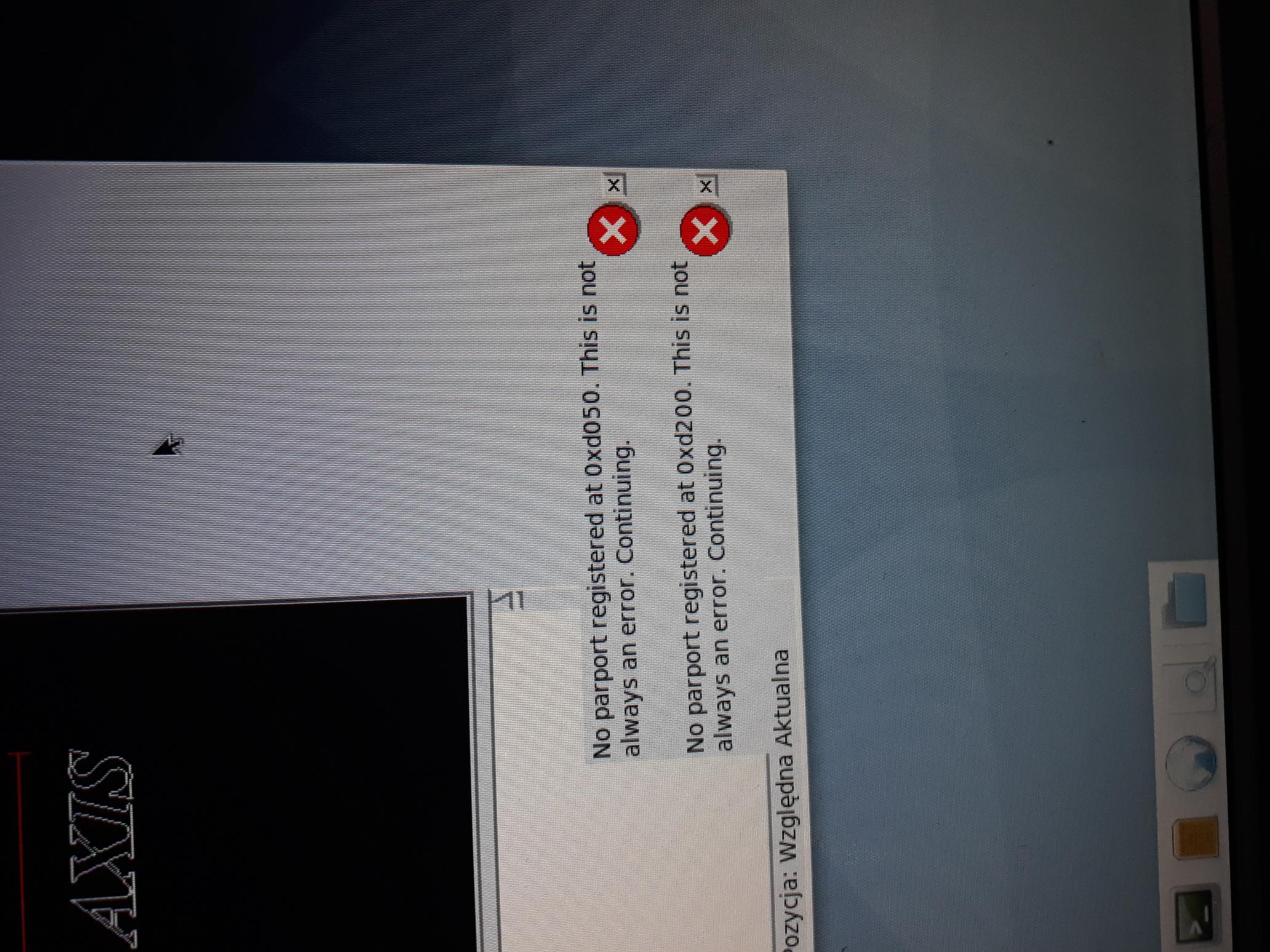

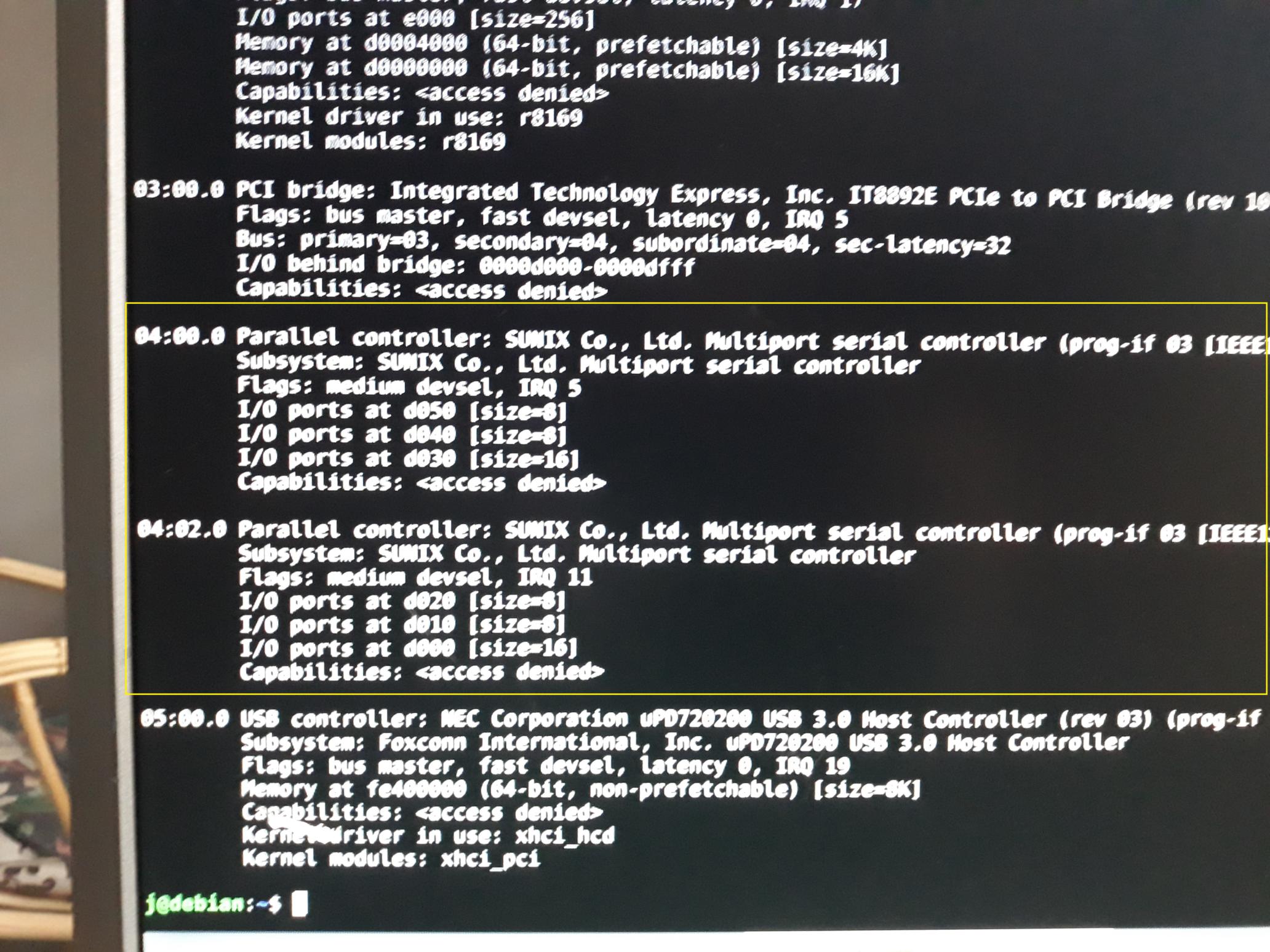

- jarcysgru
- Posts: 104
12 Nov 2023 16:45 - 15 Nov 2023 10:40 #285179
by jarcysgru
Tylko ta płyta nie portu LPT i myślę podłączyć dwie ( bo tyle potrzebuje) karty LPT do dwóch gniazd PCI , czy to będzie działać ?
Kontroler 1 x LPT (IEEE1284) PAR5008AL / Sunix SUN1989 mam w starym PC i działa
allegro.pl/oferta/kontroler-lpt-ieee1284...i-profil-11350742454
I tak po podłączeniu kontroler LPT Sunix 1989 lspci -v widzi LPT , ale po uruchomieniu linuxcnc ma taki komunikat .
Czy na tej płycie to zadziała FOXCONN H67A
