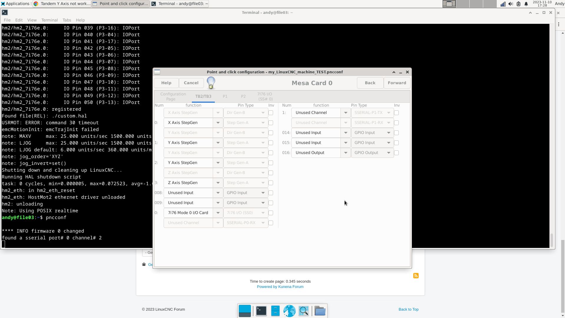

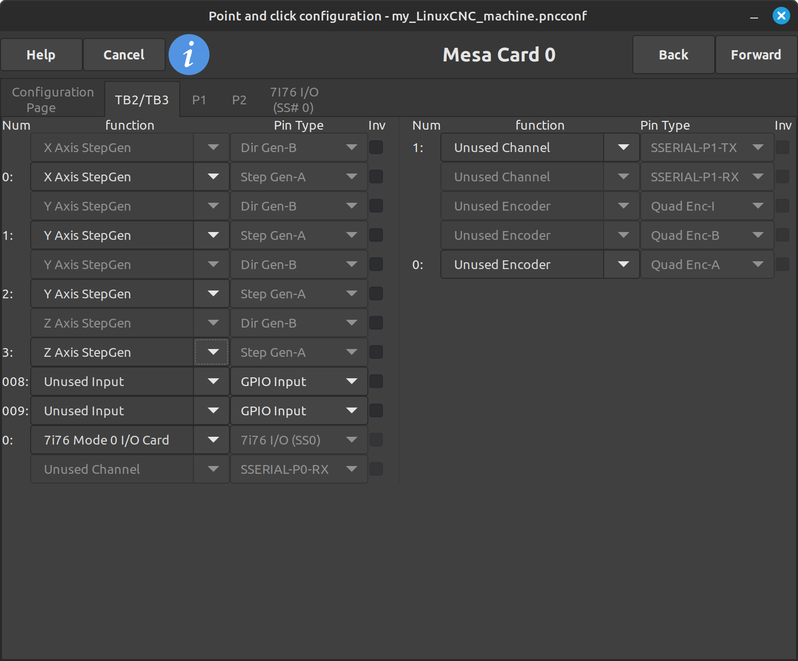

Ok, more info:
In the mean time, make another config, chose only stepgens, no switches, no homing, nothing but stepgens, select stepgen 2 AND stepgen 3 as Y axis, not tandem, save, start the config, use the keyboard to jog and check:
left arrow = X axis goes left
Right arrow = X axis goes right
Carefully bellow
up arrow = gantry moves away from you
down arrow = gantry moves towards you
Do both Y move in the same direction?
pageUp = z axis moves UP
pageDown = z axis moves down
I created a new profile and here's what happened. Both X and Z moved in the correct direction(s) as advertised above. No problem here.
When it came to the Y-Axis, only one side moved and it moved as expected in the + and - directions. So, we're moving in the right directions.
Interesting, when I swapped the stepgens in PNCCONF for the Y-Axis the issue followed. Only one side moved however it was the opposing side this time that moved.

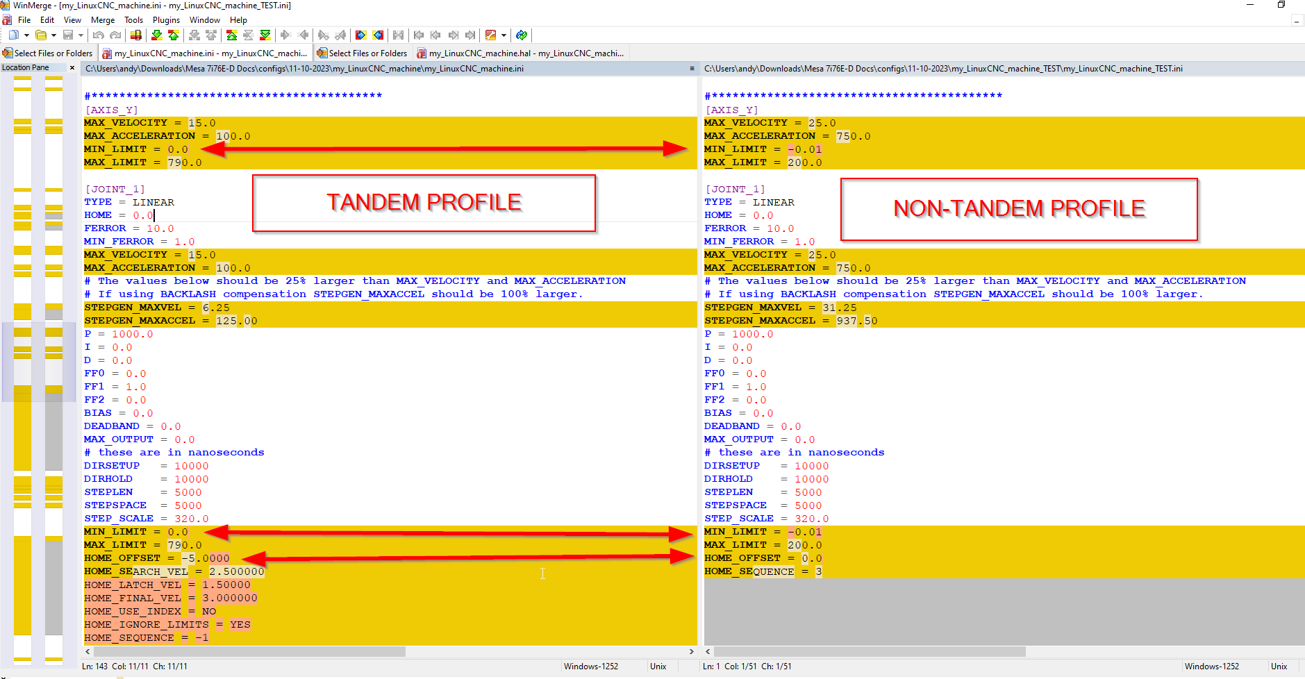

10 Nov 2023 15:56 #285054 by gardenweazel
Replied by gardenweazel on topic Tandem Y Axis not working on 7i76E
Adding a WinMerge screenshot, not sure if this will help since there was no homing setup on the NON-TANDEM side.

10 Nov 2023 16:10 #285058 by tommylight
Replied by tommylight on topic Tandem Y Axis not working on 7i76E
The following user(s) said Thank You: gardenweazel

11 Nov 2023 09:27 #285106 by gardenweazel
Please see above. Only one Y-Axis moves. The other one didn't move until I re-ran PNCCONF and swapped the two Y-Axis stepgens and then
the opposing Y-Axis ran but not the previous. So basically, only one Y-Axis would move.
