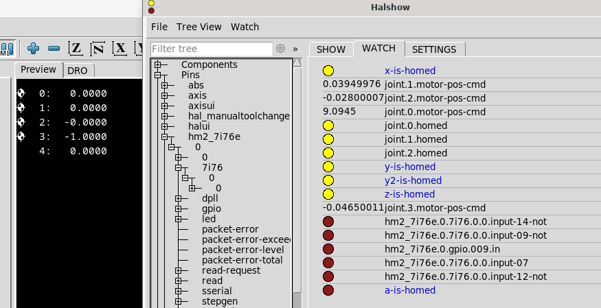

Ok, here's what I did to make my setup function properly.
I turned off all power.
I checked every motor and DM556T connection.
I noted what I had plugged into each of the 5 block terminals on the 7i76E. I had already labeled
each wire-set coming from the DM556T's.
Then with the wires screwed(with properly terminated ferrules) into the 7i76E block adapters, I moved
each block adapter and plugged it into the 7i76E as follows:
This corrected the homing issue with Y & Y2 however, it didn't back off the switches far enough after the home and therefore incurred which caused it to exceed the negative soft limit.

12 Nov 2023 16:21 #285176
Replied by tommylight on topic Tandem Y Axis not working on 7i76E
HOME_OFFSET = 5
The following user(s) said Thank You: gardenweazel

12 Nov 2023 19:15 #285192
by gardenweazel
Replied by gardenweazel on topic Tandem Y Axis not working on 7i76E
- Posts: 21901
- Thank you received: 7465
12 Nov 2023 21:45 #285203
Oh good, i was getting worried we have missed something somewhere...
