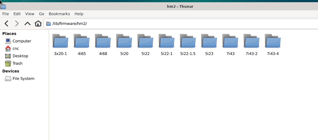

Thank you for helping me out
Do I need firmware for my boards in folder /firmware/hm2 (For 7i77, 7i74, 7i70, 7i71) ?
I tried Pncconf with 7i92 and 7i76 and then deleted all the lines with errors for 7i76 and linuxcnc started

Replied by PCW on topic CHIRON FZ22L LinuxCNC retrofit
DId you mean 7I92+7I77 as I suggested?
I would make a 7i92+one 7I77 configuration with pncconf
Get the basics working and then add the additional I/O
Do not change the basic 7I92+7I77 hal/ini file set until
everything on the 7I77 works.
As I mentioned, checking the encoders on the 7I77 would
be a good first step to verify your cables
BTW those cables are much easier to make with
IDC (press on) connectors.
Also, as far as I can see from the picture, the HDR26 --> DB25
cables are not correct.
They appear to be
HDR26 DB25
1 1
2 2
3 3
4 4
But should be:
HDR26 DB25
1 1
2 14
3 2
4 15
5 3
6 16
7 4
8 17
9 5
10 18
11 6
12 19
13 7
14 20
15 8
16 21
17 9
18 22
19 10
20 23
21 11
22 24
23 12
24 25
25 13
26 NC
That may seem odd but that's the pinout you get with
IDC (Crimp-on) flat cable connectors. Its odd because
HDR26's and DB25's number their pins differently.
