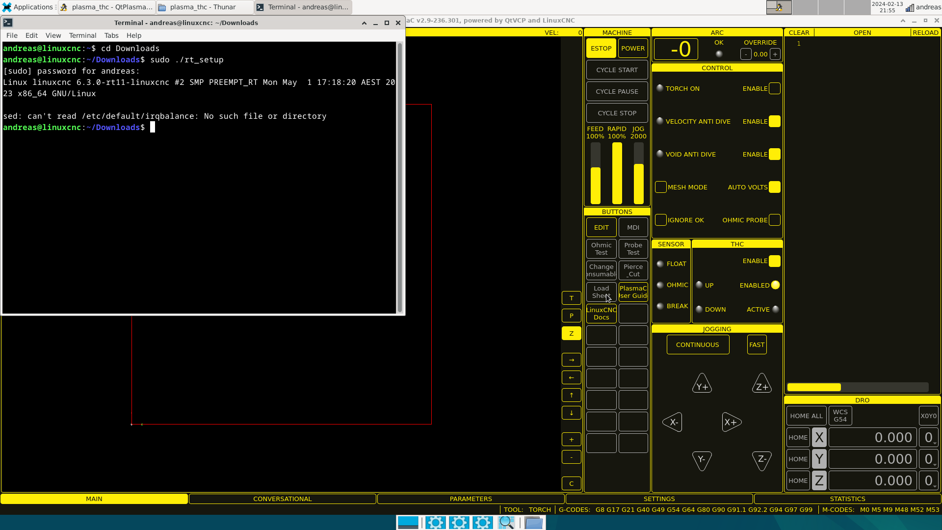

13 Feb 2024 21:13 #293261
by Ekholm
Replied by Ekholm on topic Latency, error finishing read, and IRQ affinity
- Mecanix
- Posts: 447
- Thank you received: 229
13 Feb 2024 21:22 #293264
by Mecanix
Replied by Mecanix on topic Latency, error finishing read, and IRQ affinity
I got the error in the picture. can't find folder
$ sudo apt update && sudo apt upgrade
$ sudo apt install irqbalance
$ sudo ./rt_setup
The following user(s) said Thank You: seuchato
- mozmck
- Posts: 49
- Thank you received: 59
13 Feb 2024 21:49 - 13 Feb 2024 21:55 #293267
by mozmck
Replied by mozmck on topic Latency, error finishing read, and IRQ affinity
Is irqbalance installed? - Oops, should have refreshed the page before sending. I don't know where else the config file for irqbalance would be than /etc/default
What linux distribution are you running?
