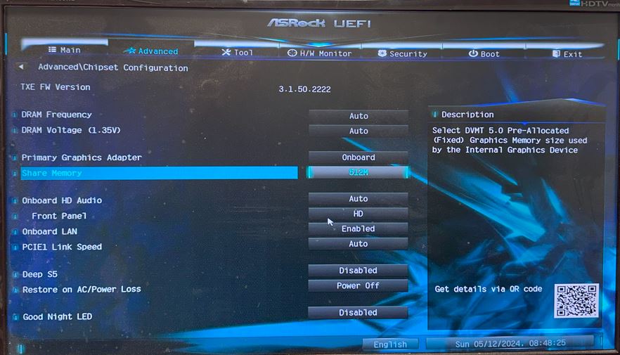

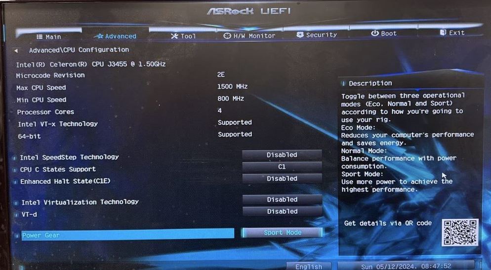

12 May 2024 04:31 #300431
by Swag
Replied by Swag on topic Latency, error finishing read, and IRQ affinity
I've now gone through the BIOS and think I have everything set as it should be and there is no change. Also had it allocate a fixed RAM for the onboard graphics since it sort of felt like the error would happen more quickly if I resized the linuxcnc window, but I don't think that was anything more than coincidence. Ping looks fine. I think the latency seems fine.
ip setup seems similar to others with working setups and the correct IP address is being used in the script.
Again this all works fine with debian 10 and linuxcnc 2.8. I am kind of at a loss at this point, though I feel like this is some simple config problem that I am overlooking.
