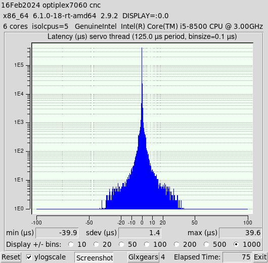

16 Feb 2024 20:10 - 16 Feb 2024 20:10 #293541 by zmrdko
I am with Tommy. It sounds video card related. Remove the Radeon card and use the onboard video
as far as isolcpus go on 6 cores, I don't know what is correct, I think that script is the best option as i think it queries the system to decide which cores to isolate.
I removed Radeon card and spikes went away, even though the latency triangle is more obese now:

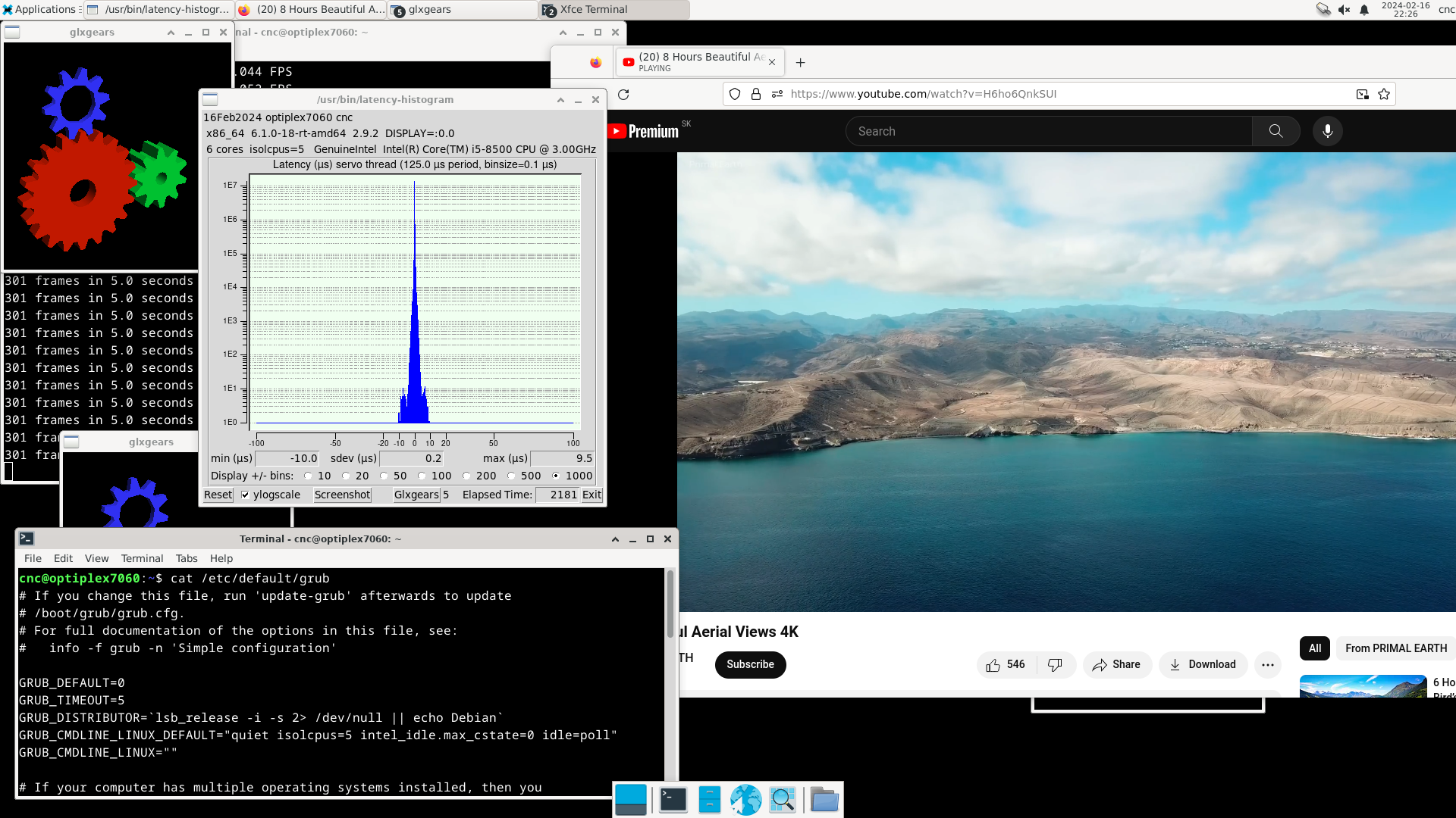

16 Feb 2024 22:54 #293549 by zmrdko
well, this is so much better:
16 Feb 2024 23:41 #293554 by tommylight
That looks very good, even for software stepping with parallel port.
Move on to making chips! :)
