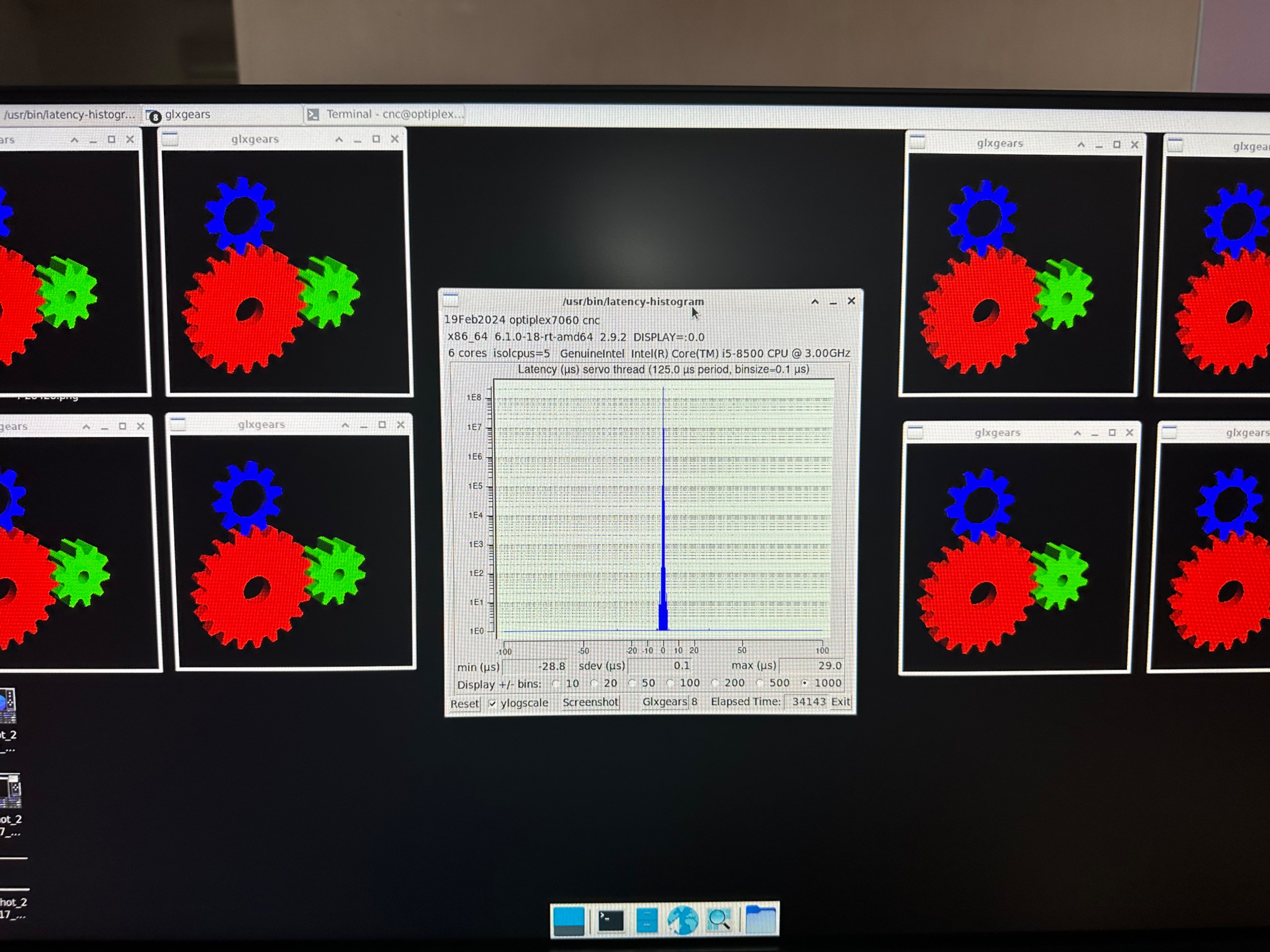

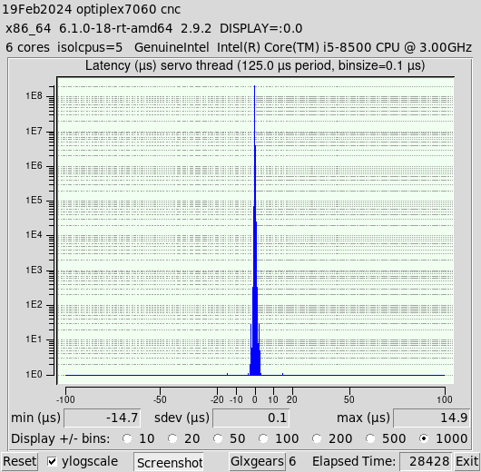

forum.linuxcnc.org/38-general-linuxcnc-q...ead-and-irq-affinity
Replied by tommylight on topic Latency spikes on Dell Optiplex 7060 (i5 8500/32GB Ram, Radeon R5 430)
Should be doable, i did 4kHz easily, so give this a try on a fresh install:But I am trying to run 8kHz thread to match with my Delta B3 EtherCAT cycle time.
- zmrdko
- Posts: 186
- Thank you received: 49
19 Feb 2024 07:48 #293761
by zmrdko
I have bought PS2 keyboard and mouse on saturday.
I was thinking about getting non-ecc unbuffered RAM, but now when I think about it, I dont have bad latency. The only problem is ad hoc latency spike, which will probably not be solved by faster RAM..
Replied by zmrdko on topic Latency spikes on Dell Optiplex 7060 (i5 8500/32GB Ram, Radeon R5 430)
Let me know how it went. Maybe we can compare hardware and do the same tests.

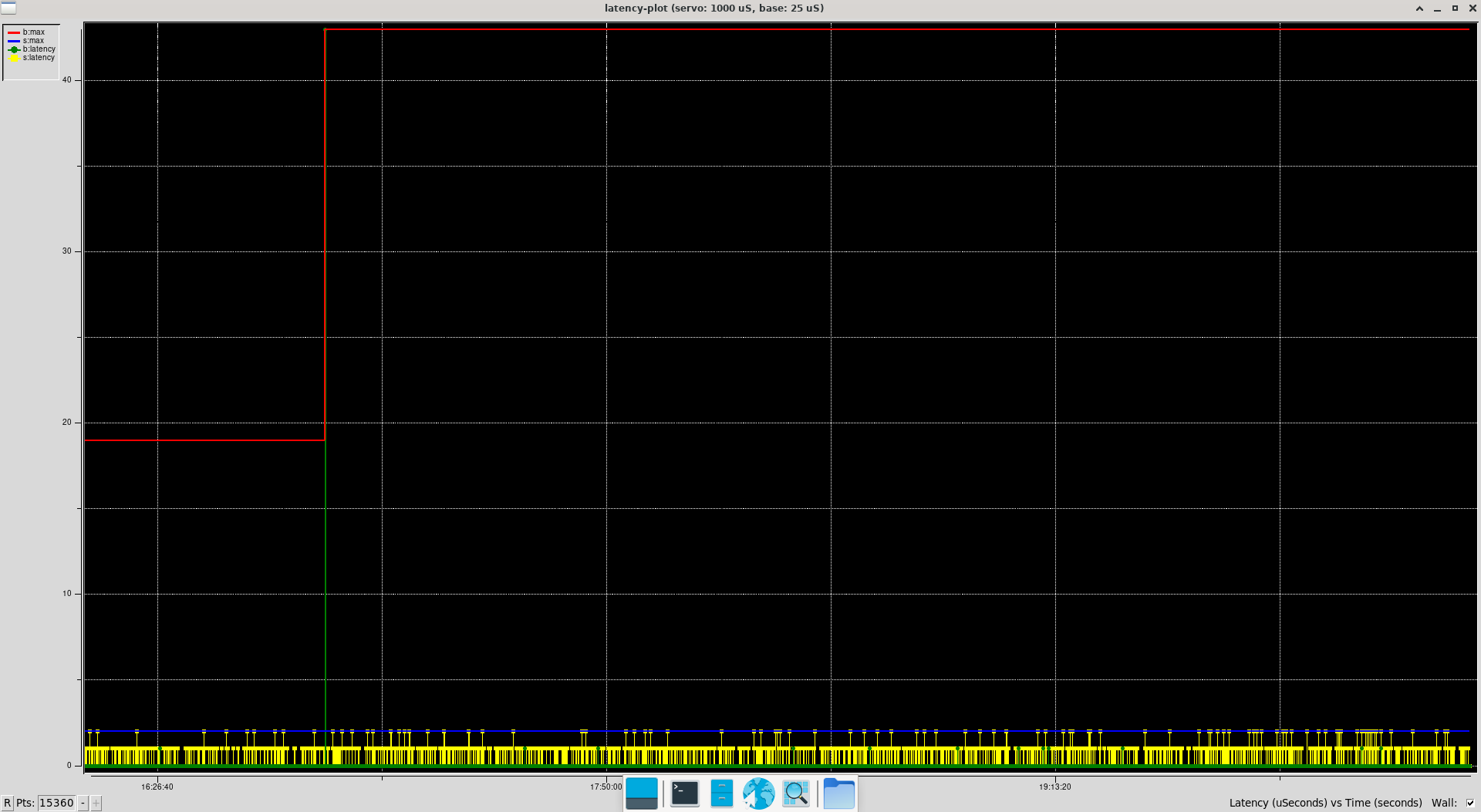

Should not cause issues, move on to making chips.

"FAIL/PASS" post processes on the manufactured part is more effective than tracing linux and electrons randomness - read cosmic ray, secondary radiation causing bit flips, voltage drops or spikes and/or thermal endlessnonsense. Indeed a concern however unworthy (imho)...Is it worth to worry about it?
