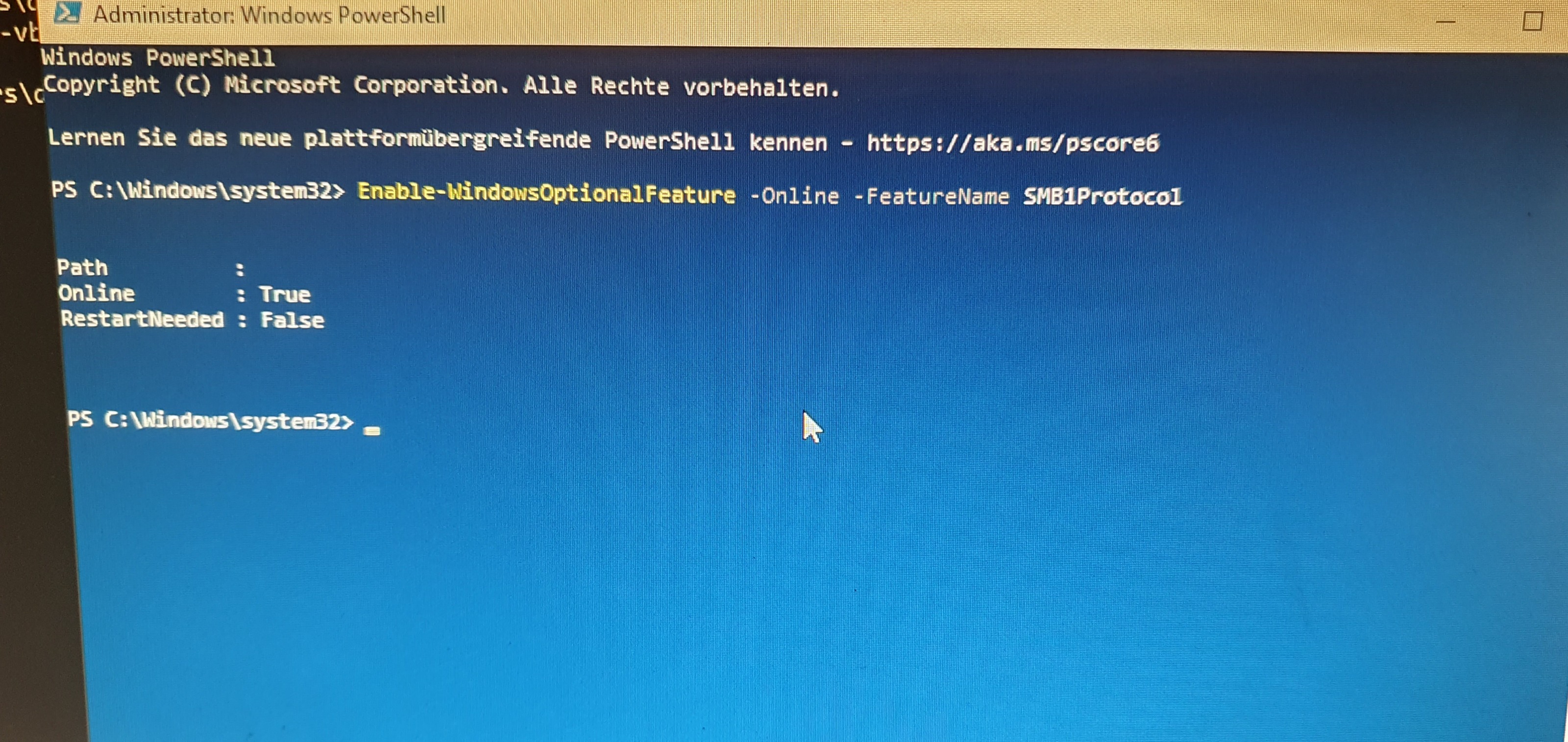

Smb1 is enabled on the windows pc. See attachment

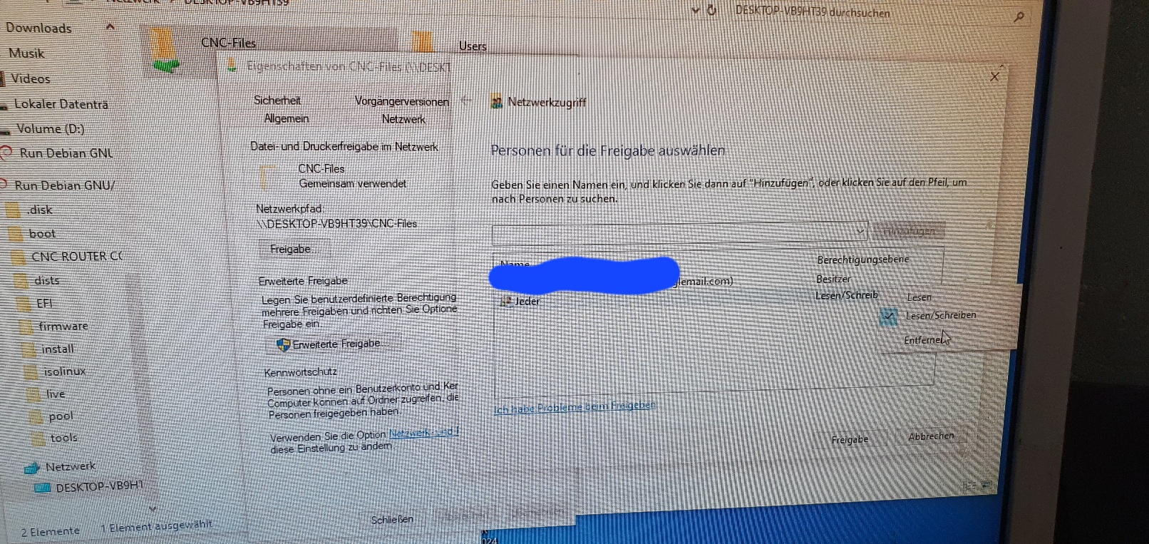

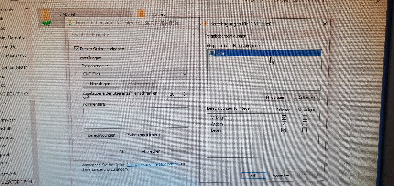

It's working!
I am really in hurry, but I added pictures of what I did. (Had to give access to "everyone" for the folder I shared. There was only access the me as a user of the windows pc)

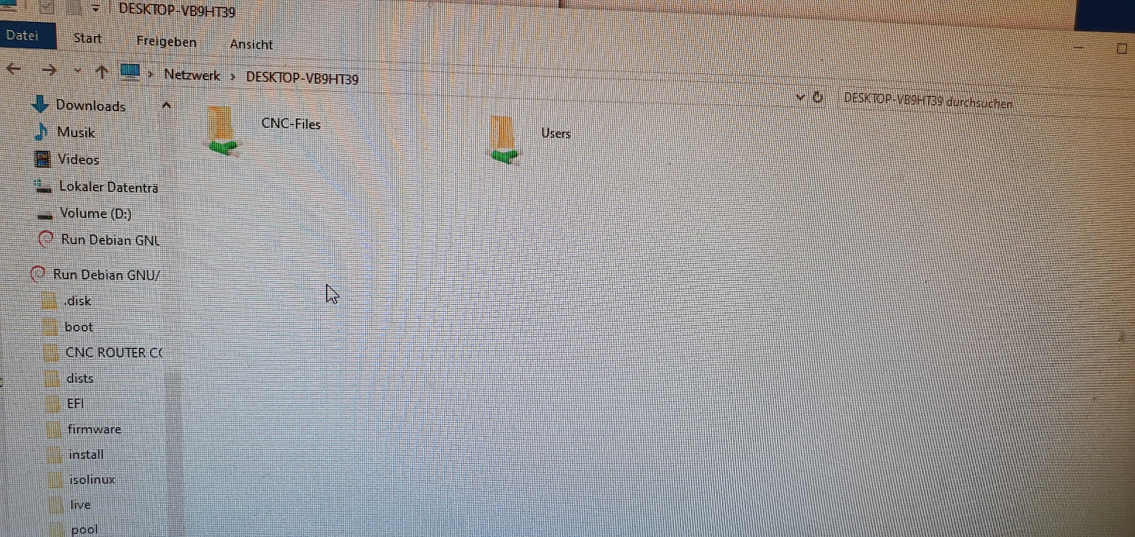

No, you are wrong. I dis it EXACTLY as you described. First without the name of share, then later when you posted it to try it with the name of share I did it as well but it still showed the info about not possible to mount. Now I can access the folder without the name of the folder, because it connects to my windows server and I can see the shared folder "cnc files". I could see it also before but not access it, because the option "access to everyone" was not added in one screen. Since I added "everyone" to that screen I can access the folder.

This is what I did and now it's working.
Before that I had all other settings done correctly but missed out to add permission to "everyone" to the list in which before was only myself. (username od the windows pc]
Thank you cornholio and others. i wouldnt manage to get it done.
