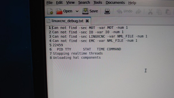

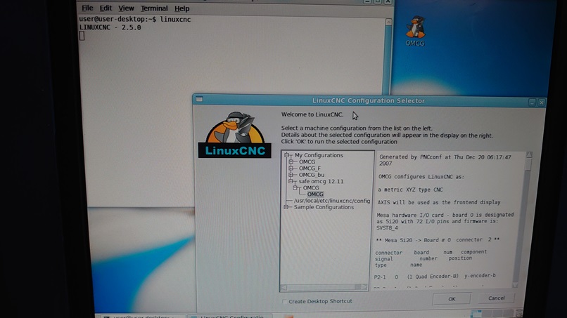

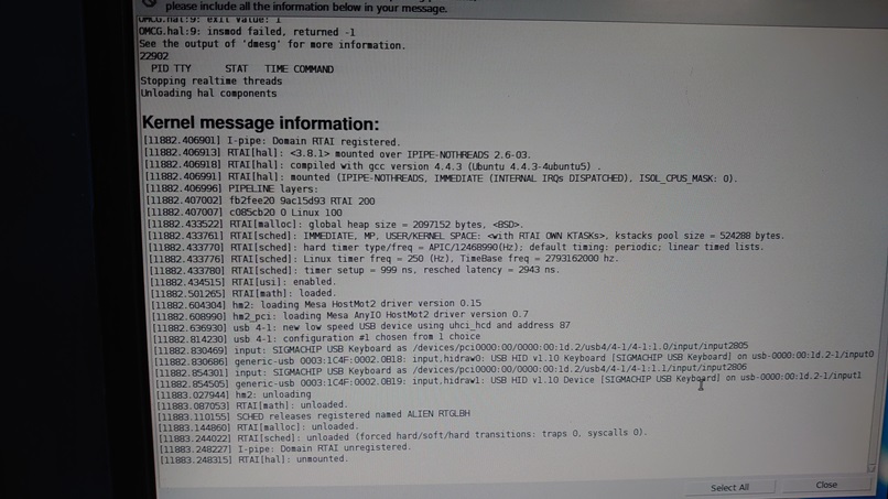

Hi all,
Long story short before my time on a tempermanent repair a wire bender was run on linuxcnc but they liked it and kept it (ran 7yrs no issues)
CMOS battery died, shut down cleaned and replaced.
PC boots up fine but linuxcnc won't open.
I've attached a few images of what I get from it when trying to run and open it and the debug file.
apologies for the images, offline machine and no USB to hand (trying to get them to 21st century).
I'm very basic with linux but the messing around has inspired me to grab my raspberry pi and to get playing again (for one never thought to look for a linuxcnc OS)

Screen shots are difficult enough, but the debug section does not appear to be there, which kinda makes it hard.

Also this is not a boot issue, it is a LinuxCNC gracefully failing to start issue, gracefully as it also reports why it failed, but this time the reason it failed is missing from the pictures, we need the debug portion of the report, as Cornholio mentioned above.

my apologies, thought I had that in the shot, I'll grab it off the machine. brought a drive with me so hoping to grab the data and drop it in a notepad

Print file information:
RUN_IN_PLACE=no
LINUXCNC_DIR=
LINUXCNC_BIN_DIR=/usr/bin
LINUXCNC_SCRIPT_DIR=
LINUXCNC_RTLIB_DIR=/usr/realtime-2.6.32-122-rtai/modules/linuxcnc
LINUXCNC_CONFIG_DIR=
LINUXCNC_LANG_DIR=/usr/share/linuxcnc/tcl/msgs
INIVAR=inivar
HALCMD=halcmd
LINUXCNC_EMCSH=/usr/bin/wish8.5
LINUXCNC - 2.5.0
Machine configuration directory is '/home/user/linuxcnc/configs/OMCG'
Machine configuration file is 'OMCG.ini'
INIFILE=/home/user/linuxcnc/configs/OMCG/OMCG.ini
PARAMETER_FILE=linuxcnc.var
TASK=milltask
HALUI=halui
DISPLAY=axis
Starting LinuxCNC...
Running HAL shutdown script
Killing task linuxcncsvr, PID=18670
Cleanup done
Debug file information:
Can not find -sec MOT -var MOT -num 1
Can not find -sec IO -var IO -num 1
Can not find -sec LINUXCNC -var NML_FILE -num 1
Can not find -sec EMC -var NML_FILE -num 1
insmod: error inserting '/usr/realtime-2.6.32-122-rtai/modules/linuxcnc/hm2_pci.ko': -1 No such device
OMCG.hal:9: exit value: 1
OMCG.hal:9: insmod failed, returned -1
See the output of 'dmesg' for more information.

I'd try reseating the Mesa card, and giving things a bit of a clean.
This is the error

Shut it down, removed the mesa card, gave it the ole cartridge clean and tried it.
No change.
Checked all the files and everything seems to be in the locations it's looking for, again amateur hour here but highly interested as stated.
No change.

I think this file is missing:
what does this list?
sudo ls /usr/realtime-2.6.32-122-rtai/modules/linuxcnc/hm2_pci.ko

Got a red light on CR9 and CR10
And amber on CR11
On the card
Will drag up mesa manual see if that has anything that can contribute, probably the operating lights but need to start somewhere
