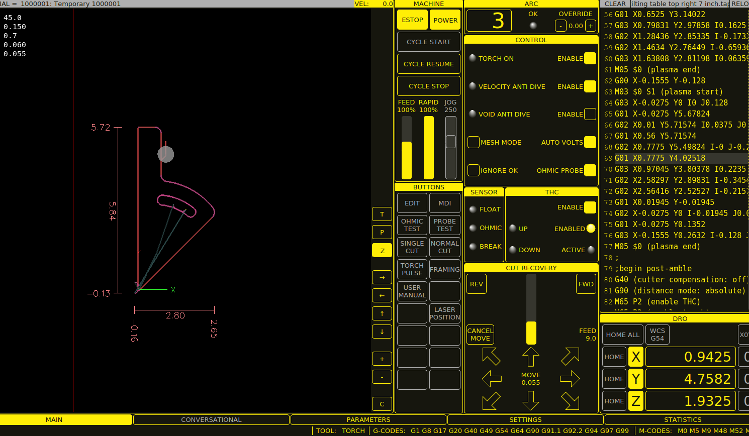

Back again with new problems, some time I get good cuts and other time not at all.

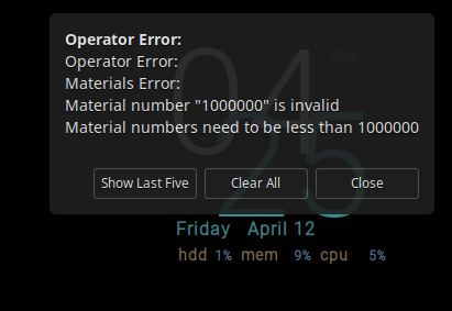

First thing when starting up I get a material error see attached.
I can cut a straight line (7") no problem, Add shapes to a cut and either stops about 1/3 the way through, or may crash the torch into the metal.

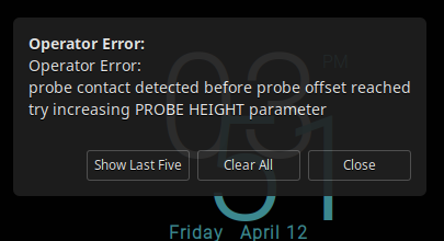

Today after a crash it gave my the restart option, I moved the torch a small amount for restart off the path. The cycle resume button was flashing, when I pushed it the torch moves down touched the metal and retracted. And I get a message about the probe.
I can run without the torch without error with multi-part G-code.
Just did an update/upgrade to V2.10-005.033 do not know if this will help with the problems I am having.

Ok this may have been the problem I have with the material list. I looked in SheetCam and I had many other then plasma tools that showed very high tool number. I will rerun the tool conversion in the morning with only Plasma tools.

You cannot have material numbers of 1000000 or greater in the material file.
The last error shows that you are using offset probing. You must have the probe height set to higher than the thickest material that you will cut. Probe height is measured from the Z axis lower limit, it is not the material thickness.
linuxcnc.org/docs/devel/html/plasma/qtpl...plasma:initial-setup

Redoing the tool list in SheetCam (plasma only tools) and then the material conversion in LinuxCNC corrected the problem on the message at the start about the material over 1000000.
