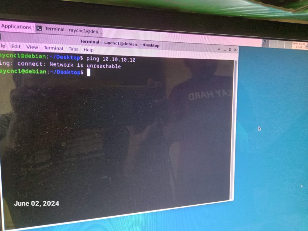

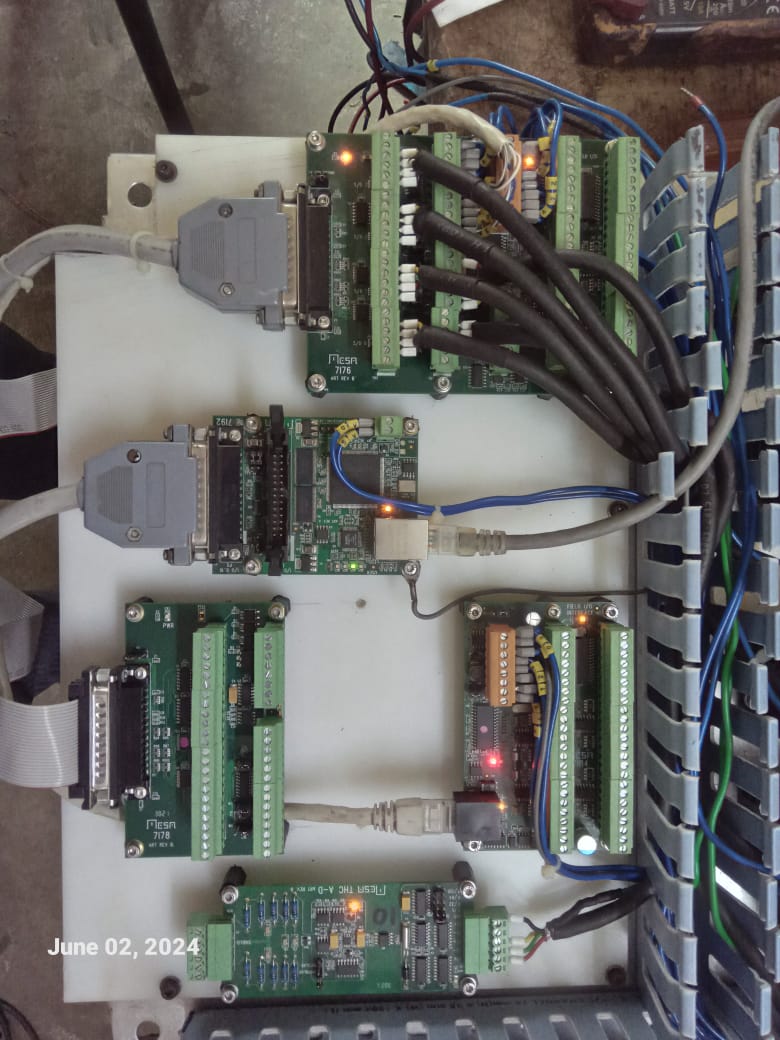

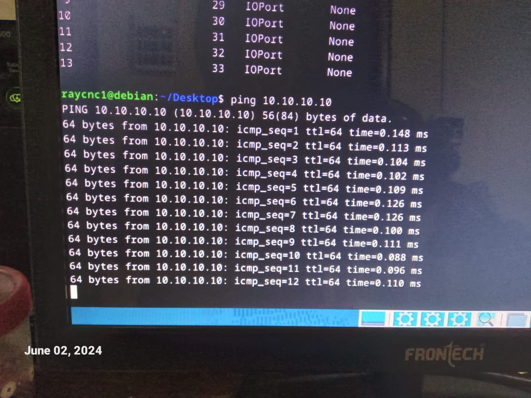

I am using 7i92+7i76+7i84.
I had connected the system earlier and it was working perfect.
Now I upgraded to LinuxCNC 2.9.2 and added 7i78. But there is no ping. Note: I have added one wifi router as well. Can it cause any problem?
(7i92 set to 10.10.10.10, W5 down, W6 UP)
What is going wrong?

02 Jun 2024 07:17 #302144
Replied by tommylight on topic 7i92 not pinging
What does
Ip a
Return in a terminal ?
Ip a

02 Jun 2024 07:34 #302146
by rajsekhar
Replied by rajsekhar on topic 7i92 not pinging
well, I did the network setup as per tommylight post dated 27/11/2018. Many thanks.
now, it is pinging and in the terminal I get,

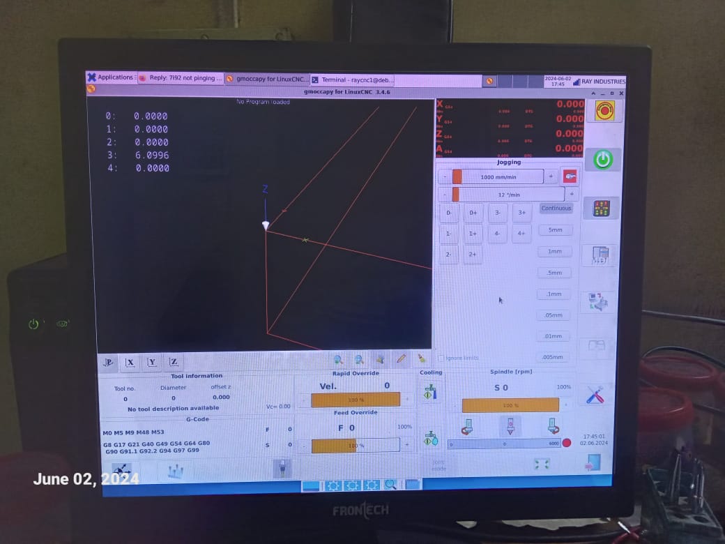

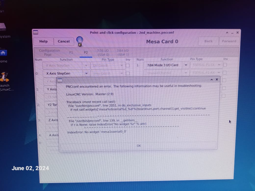

But the gmoccapy configuration is not working. Axes buttons are showing in joint numbers (numeric), motors not moving, showing following errors. HAL and INI file attached.
It is Linuxcnc 2.9.2.
Please guide.

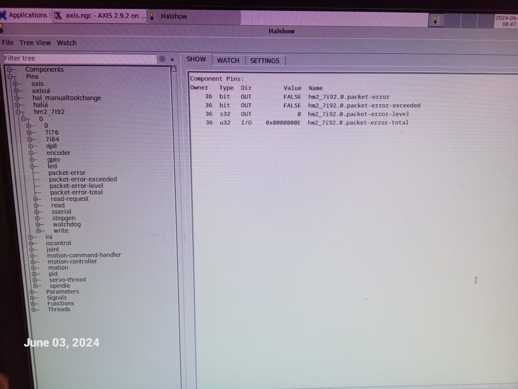

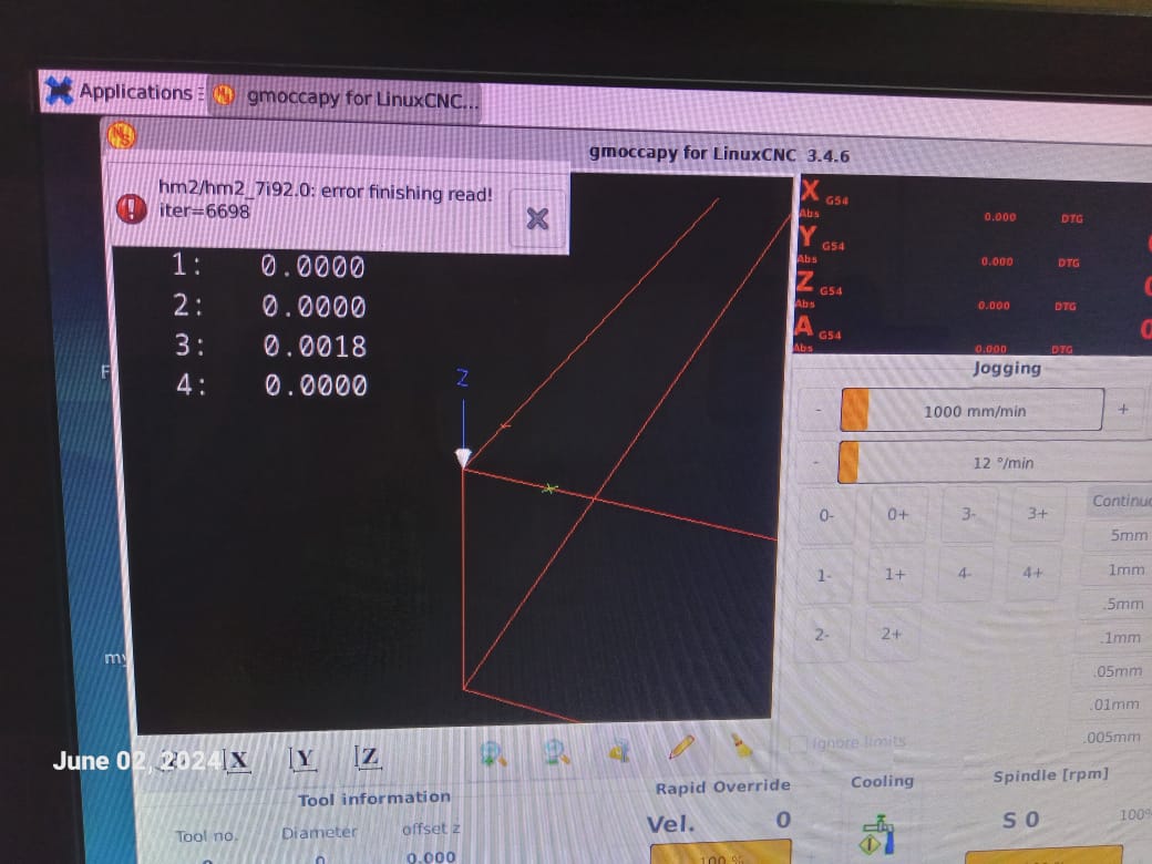

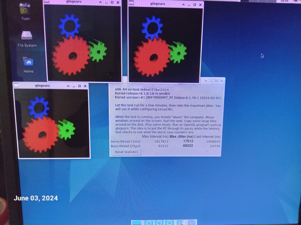

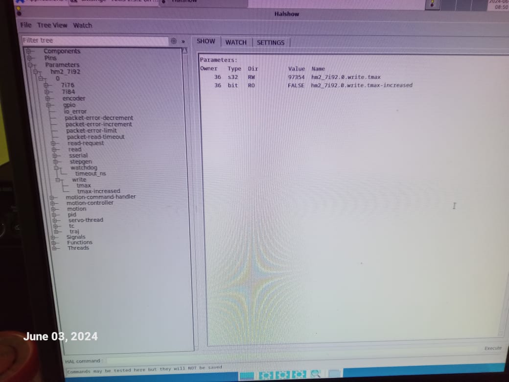

- Posts: 18122
- Thank you received: 5337
02 Jun 2024 08:39 #302150
Replied by PCW on topic 7i92 not pinging
I suspect there is a latency issue.
What are the CPU type and clock speed?
and what do
halcmd show param *.tmax
and
halcmd show pin hm2_7i92.0.packet-error-total
report (when LinuxCNC is running)
and what do
and
- Posts: 22049
- Thank you received: 7509
02 Jun 2024 08:57 #302154
You have set a tandem Y axis but have no limit switches set, so you can not move the machine as it requires homing before being able to jog.
That is to prevent raking the gantry, and that also explains why you see joints in the DRO until the machine is homed, at that point the DRO changes to showing Axis letters for 4 axis.

The latency, tmax and packet error data attached in photos.
the error in PNCconfig and "error finishing read! iter= " is attached.

halcmd show param *.tmax and show pin mh2_7i92.0.packet-error-total result while linuxcnc running is as follows:
raycnc1@debian:~/Desktop$ halcmd show pin hm2_7i92.0.packet-error-total
Component Pins:
Owner Type Dir Value Name
36 u32 I/O 0x00000010 hm2_7i92.0.packet-error-total
raycnc1@debian:~/Desktop$ halcmd show param *.tmax

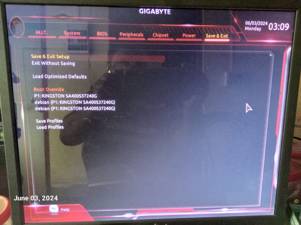

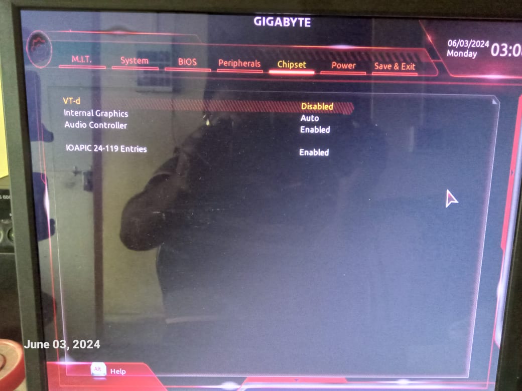

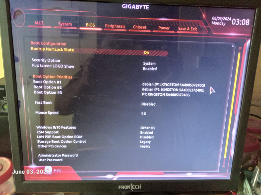

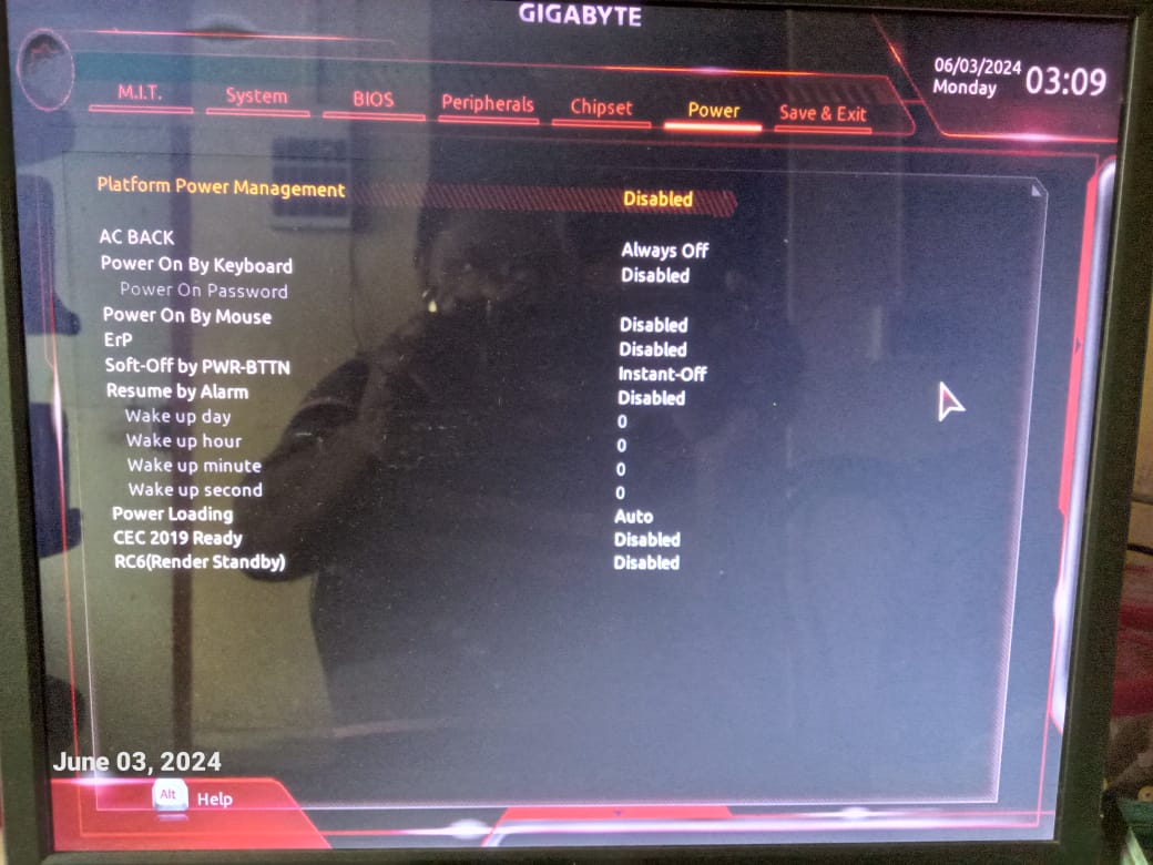

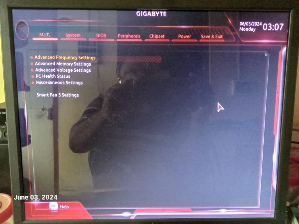

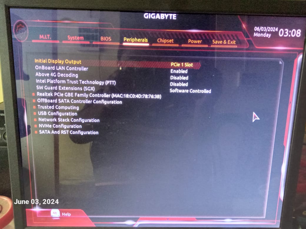

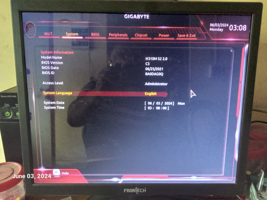

bios setup attached in photos.
kindly suggest what changes to be done.

Bios setup, tmax and packet error data attached in previous post. Please look into.
latency test and histogram (attached), ping data given in this post as follows:
raycnc1@debian:~/Desktop$ ping -i .2 -c 4 10.10.10.10
PING 10.10.10.10 (10.10.10.10) 56(84) bytes of data.
64 bytes from 10.10.10.10: icmp_seq=1 ttl=64 time=0.144 ms
64 bytes from 10.10.10.10: icmp_seq=2 ttl=64 time=0.106 ms
64 bytes from 10.10.10.10: icmp_seq=3 ttl=64 time=0.097 ms
64 bytes from 10.10.10.10: icmp_seq=4 ttl=64 time=0.104 ms
--- 10.10.10.10 ping statistics ---
4 packets transmitted, 4 received, 0% packet loss, time 611ms
rtt min/avg/max/mdev = 0.097/0.112/0.144/0.018 ms
raycnc1@debian:~/Desktop$ sudo chrt 99 ping -i .001 -q 10.10.10.10
[sudo] password for raycnc1:
^C
157081 packets transmitted, 157081 received, 0% packet loss, time 157294ms
rtt min/avg/max/mdev = 0.043/0.051/3.948/0.019 ms
Please suggest suitably.
- Posts: 18122
03 Jun 2024 22:51 #302292
What BIOS options do you have under "advanced frequency settings"?
