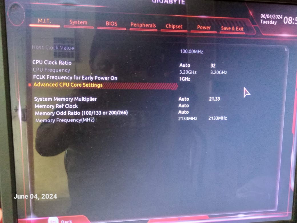

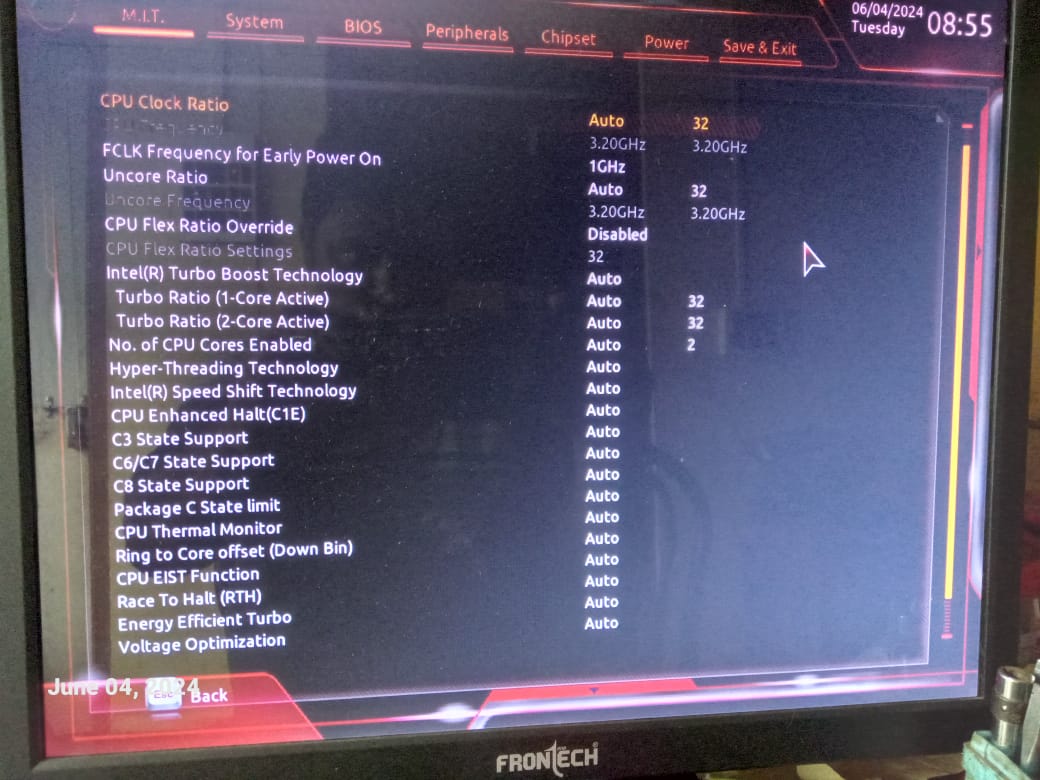

Please find the attached photos.
advance frequency setting attached.
under "advanced frequency setting", advanced cpu core setting attached.
- Posts: 18122
- Thank you received: 5337
04 Jun 2024 08:36 #302312
Replied by PCW on topic 7i92 not pinging
I would disable everything you can on the frequency page and try the ping test again
