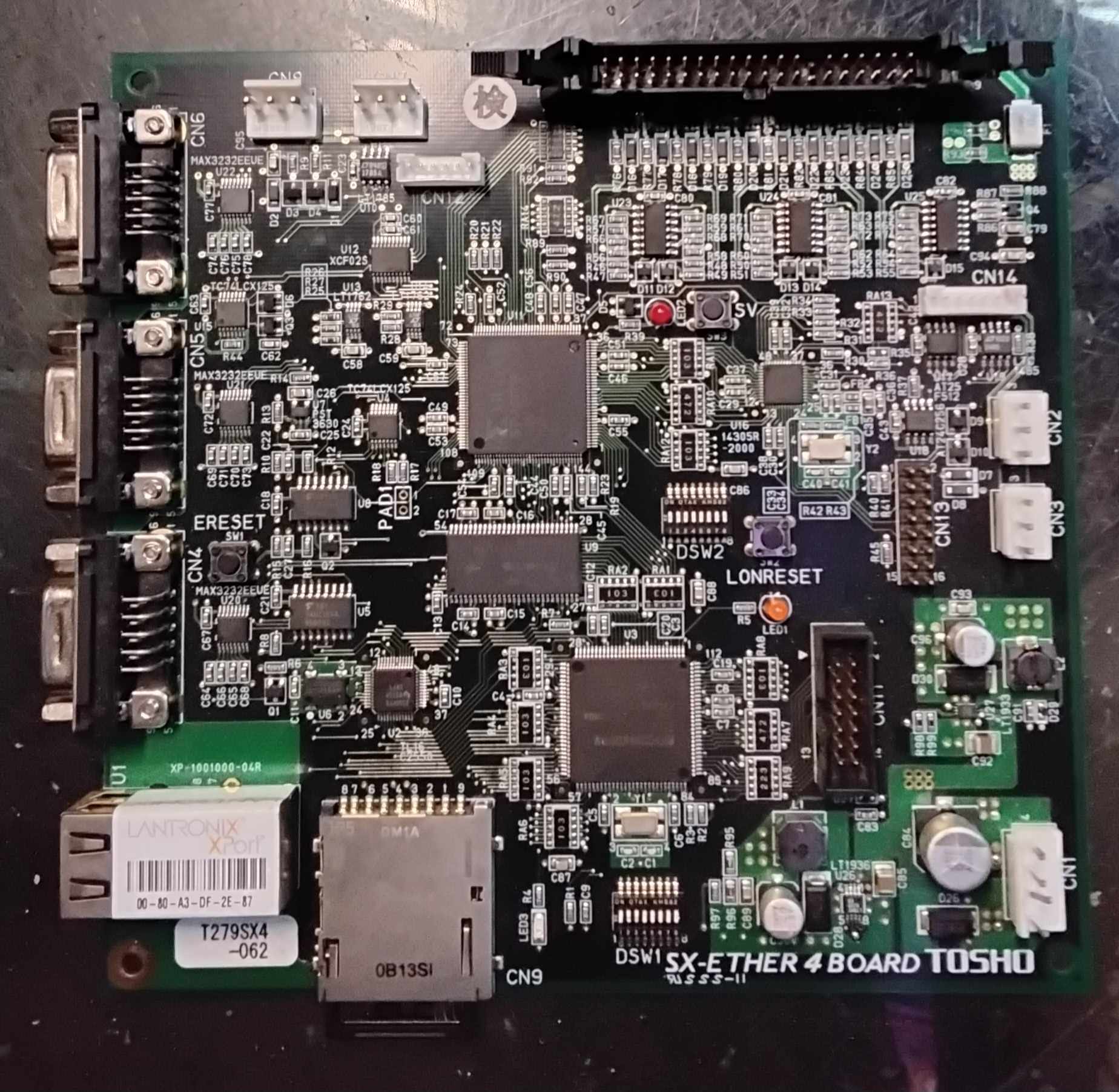

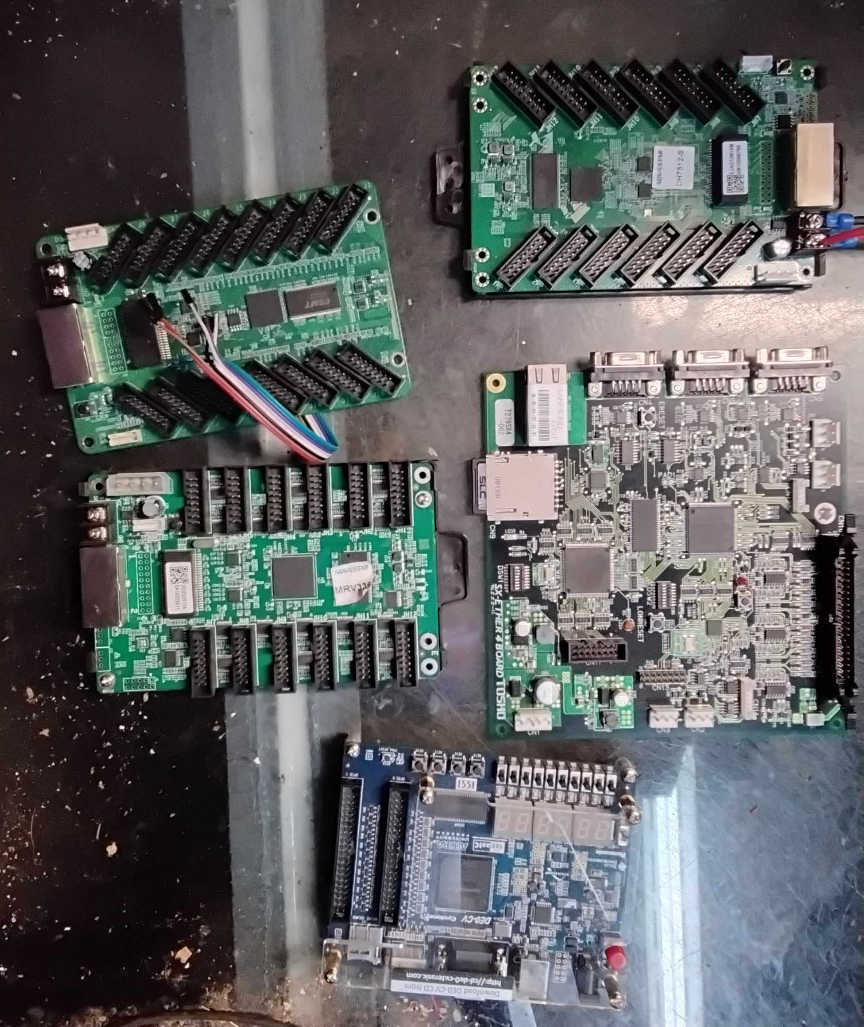

Yeah reverse engineering requires time, a good eye, an idea of what you are working with, tech level training in electronics is going to help (being able to program an arduino doesn't cut it). With FPGAs you are going to need software & tools that can do a boundary scan, including bdsl files. The very first thing you will need to do is identify the JTAG interface. You'll also need a pile of data sheets for the components you can identify, which sometimes can be a PITA. Then it is a whole lot of time, checking double checking and triple checking, getting frustrated, getting sore eyes.
But the very first thing is to find as much information as you can regarding what you are trying to reverse engineer. And honestly it's hard enough attempting repairs on multi layer boards, cos tracks in between layers can go open circuit, or go open circuit only when the board is screwed into it's housing, now imagine that issue arising when reverse engineering ?
With some of the colorlight boards they were part reverse enginered by removing all the components off the board, taking an image of the tracks, then carefully sand the first layer off to reveal one of the mid layers.
I spent the best part of 2 days reverse engineering a a mini901, think of a colorlight board, the bulk of the the board without RJ45 connectors and buffers being on a board the same format as a laptop ram module. It would have been easier if I had a carrier board for it, but alas that was not the case. There's a lot of trial and error involved.
