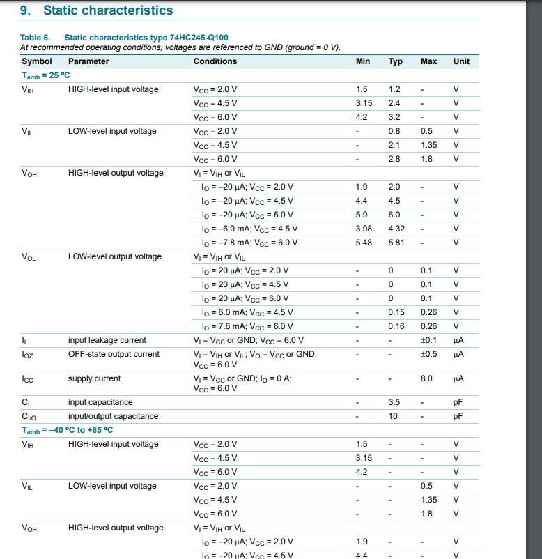

So how are you going to do the 5v to 3.3 translation for the inputs ? As the FPGA isnt 5v tolerant on the inputs.
The only chips that I'm aware of are the 74LVC series that run off 3.3v but have 5v tolerant inputs. Or you can use fet bus switches but they need pullup resistors and have a vcc of no more of about ~3.9 to ~4.2v.
That's also been my biggest gripe with those boards, the amount of rework to safely get 5v inputs.

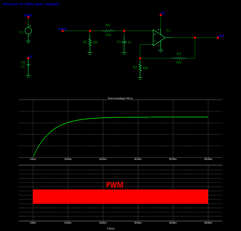

@OP - The PC827 is ancient (medieval crap). s l o w. I'd upgrade this to a Year 2024 era 10meg capable-like LTV-M601. Finally, the PWM-to-10V works perfectly fine. Best way to answer your own question is to simulate the circuit (LM358 here). Something ChatGPT ain't great at ;)

Oops, just noticed you're on a 24V input (not 12V). My bad. In that case change R3 to a 28K'ish. GPT would have spot that inaccuracy...
Sim with LTSpice or with any of those online simulatorswhatever... plenty of them around www lane. GL.

As for level-shifting, this board has a 23 x 74hc245t on it. I plan to pull the Vcc pins of the input chips and move them to the 3.3 V rail. They will then take a 5V input and output 3.3V. I will leave the output chips alone as they are shifting their inputs up to 5V.

6VDC analog is achievable with the same circuit. e.g. Drop R3 down to 2K with a 12V input == 3V analog @ 50% pwm duty cycle.

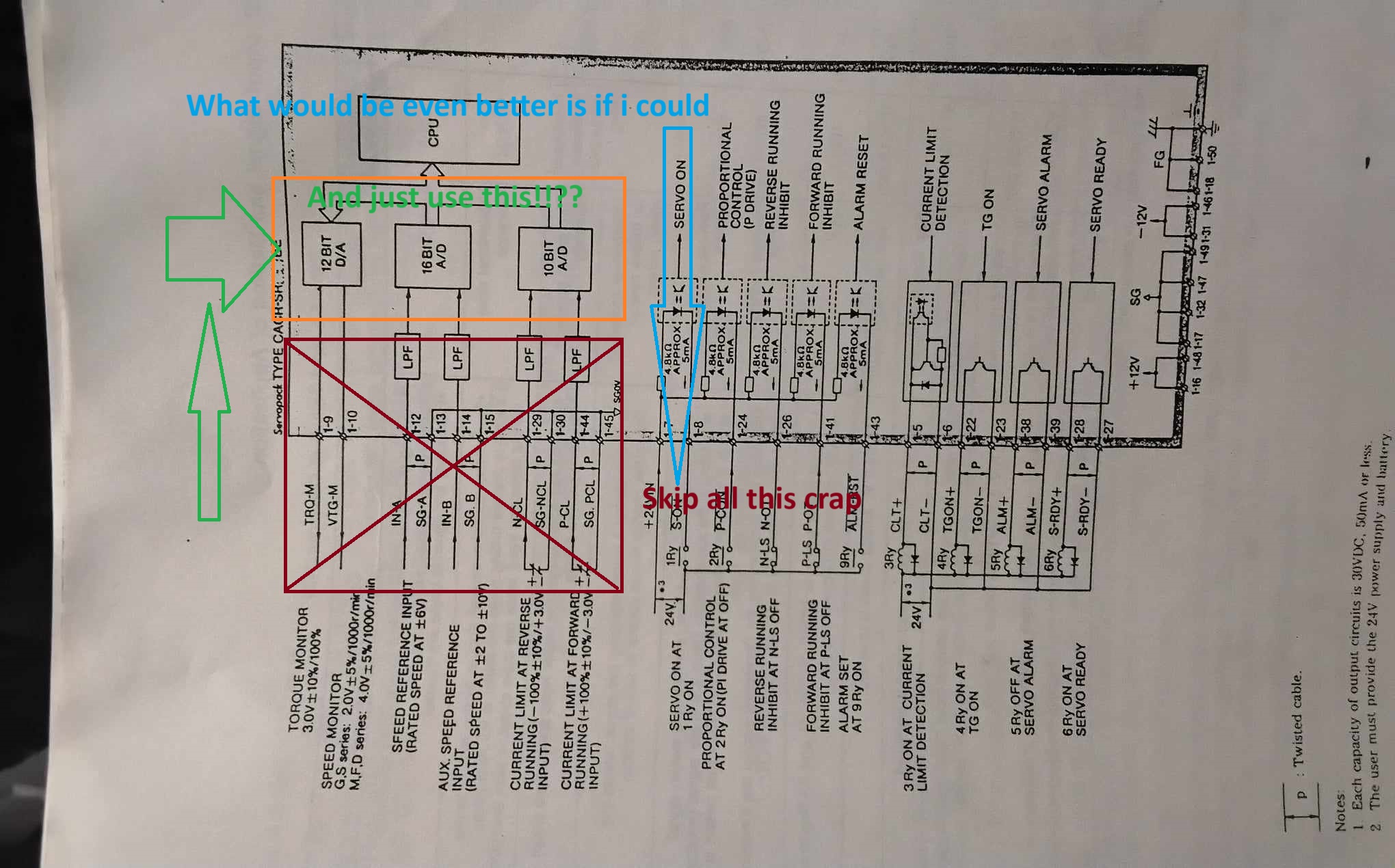

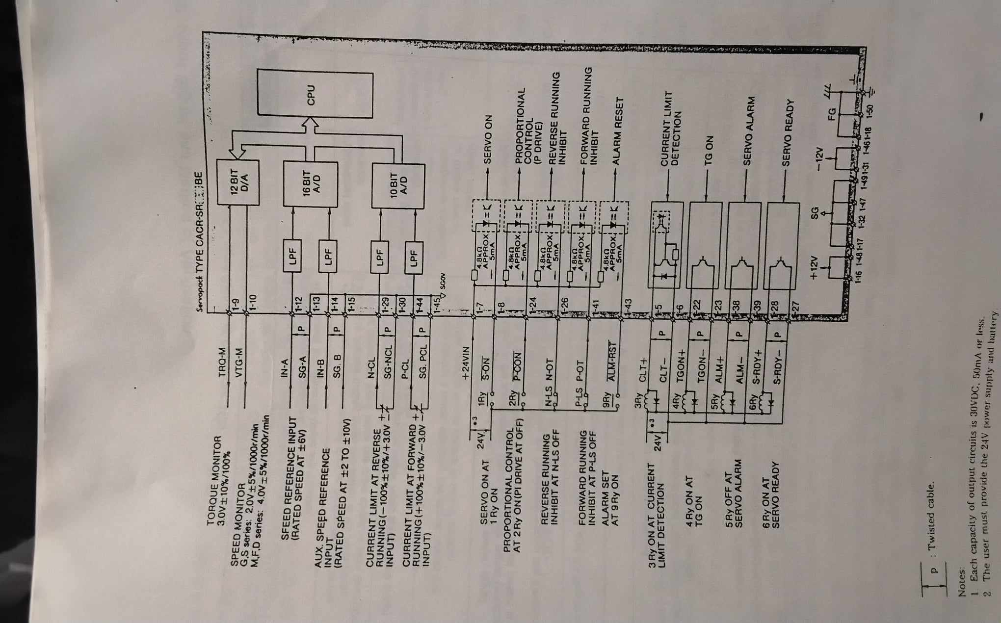

Are you talking about me just using buck converters instead of isolation? Just use my 24V to power everything....? Isnt there a bigger risk for noise and ground loops? I think i would still need to isolate some things... ie. plasma torch. All that said.. I do think i could skip isolation on the servo amps.. As you can see in the photo... I was just 'following protocol' as they say! :D
