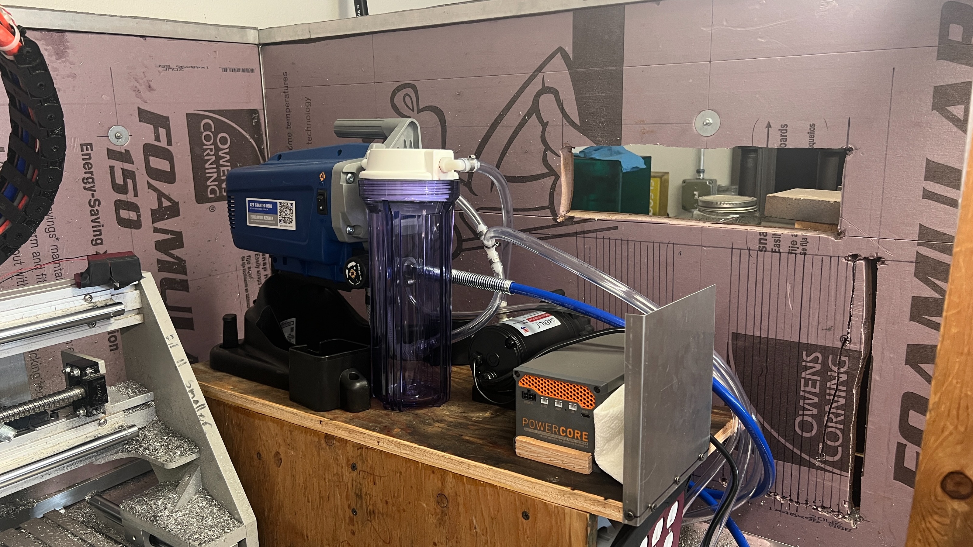

I am back. I got very busy and got sick and have just now been able to get to the software side of things. I added a picture of the pumps I am using because that is kind of fun.

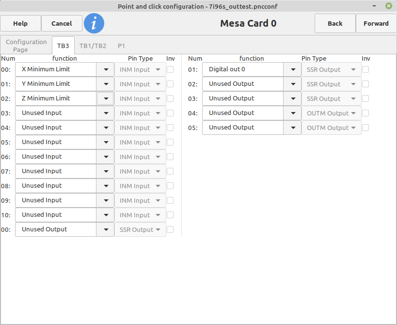

So I spent the rest of the day trying to figure out how to get a gcode command to turn a relay on and off using the output pin from the mesa 7i96s. The relay controls the pumps and it needs to be turned on before I start EDMing. I think getting a simple relay to work before trying to mess with a PID loop is best. I am not sure if it is relevant but the pin is TB3 pin 14 based on the mesa 7i96s manual.
I believe what I need to do is have a user defined mcode (this allows me to easily turn the pumps on and off and I can also modify my gcode post processor to turn this off and on after I output any drilling operations). The name of the file is M101. I will also write a M102 to turn the pumps off once I get this first one working. And btw this is just placed in the main folder that is this machine. Here is what is in the M101 file:
#!/bin/bash
halcmd setp motion.digital-out-00 true
chmod +x M101
exit 0
I am also trying to modify the .hal file to actually call up the mcode command. Here is what I have in the .hal file:
setp hm2_7i96.0.output.00 true
net edm-pump-output <= motion.digital-out-00
net edm-pump-output => hm2_7i96.0.output.00 true

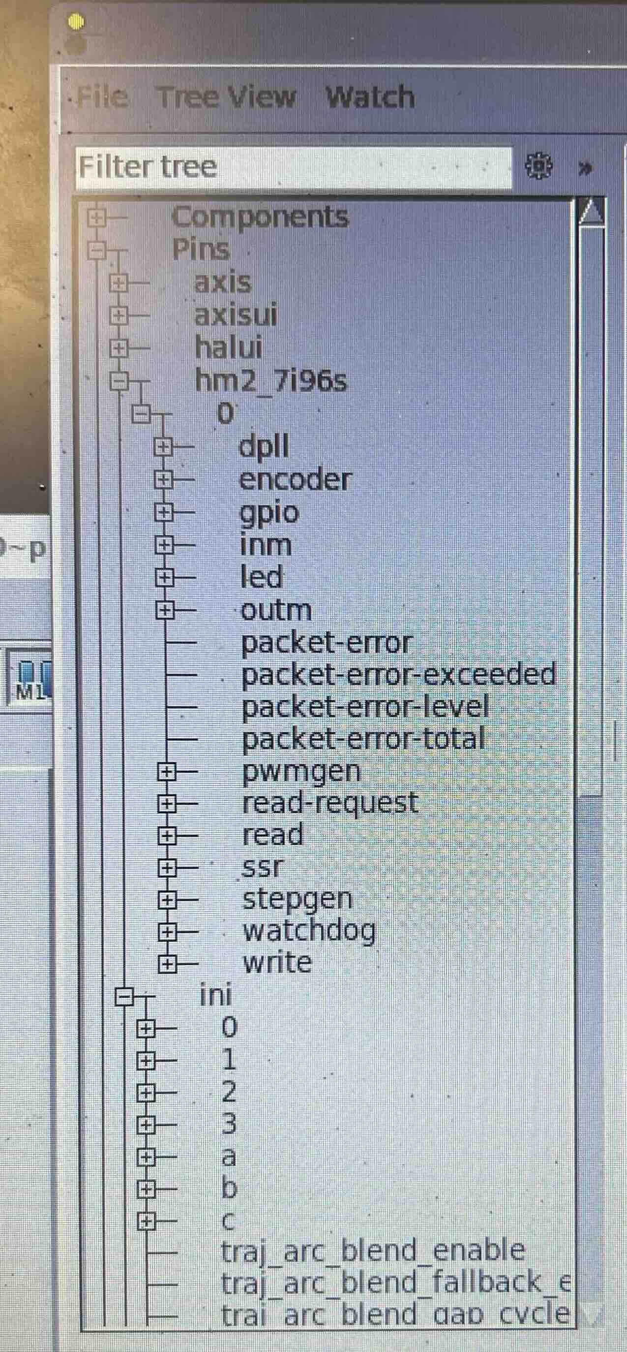

Something is not right though because I am getting the debug error "paramater or pin 'hm2_7i96.0.output.00' not found" and the machine won't boot up (I did get it to boot up after flashing though).
I am going to look at this with fresh eyes in the morning. But this is not an area I am proficient in and I am not finding a webpage that clearly lays out the syntax. I get that the pin needs to be set, and then connected. But I really do not know how to do that. So if someone would be willing to point out what I have wrong I would really really appreciate it.
Thank you.

1. This makes no sense in your custom mcode as the file needs to be executable in the first place
2. comment out those 3 lines in your hal file, start your config and use the 'show halconfiguration' tool to check for the correct pin descriptor.
chmod +x M1012. comment out those 3 lines in your hal file, start your config and use the 'show halconfiguration' tool to check for the correct pin descriptor.

Okay, I just messed with the machine for over an hour and I am more confused now than at the beginning. I assume you are trying to get me to find the correct pin using the hal configuration tool. Well. I could not find the pin. The only place that seemed reasonable was under GPIO. I set all these pins to high using hal configuration. Nothing I did turned my pump relay on (I was also checking with a multimeter). Btw, I got to hal configuration from the GUI, not from terminal, I assume this wouldn't change anything.. It is frustrating that there is not a document somewhere that shows the names of the pins as LinuxCNC has them named...
I am not surprised that my mcode does not make sense, are you saying that I need to remove "chmod x M101"?
