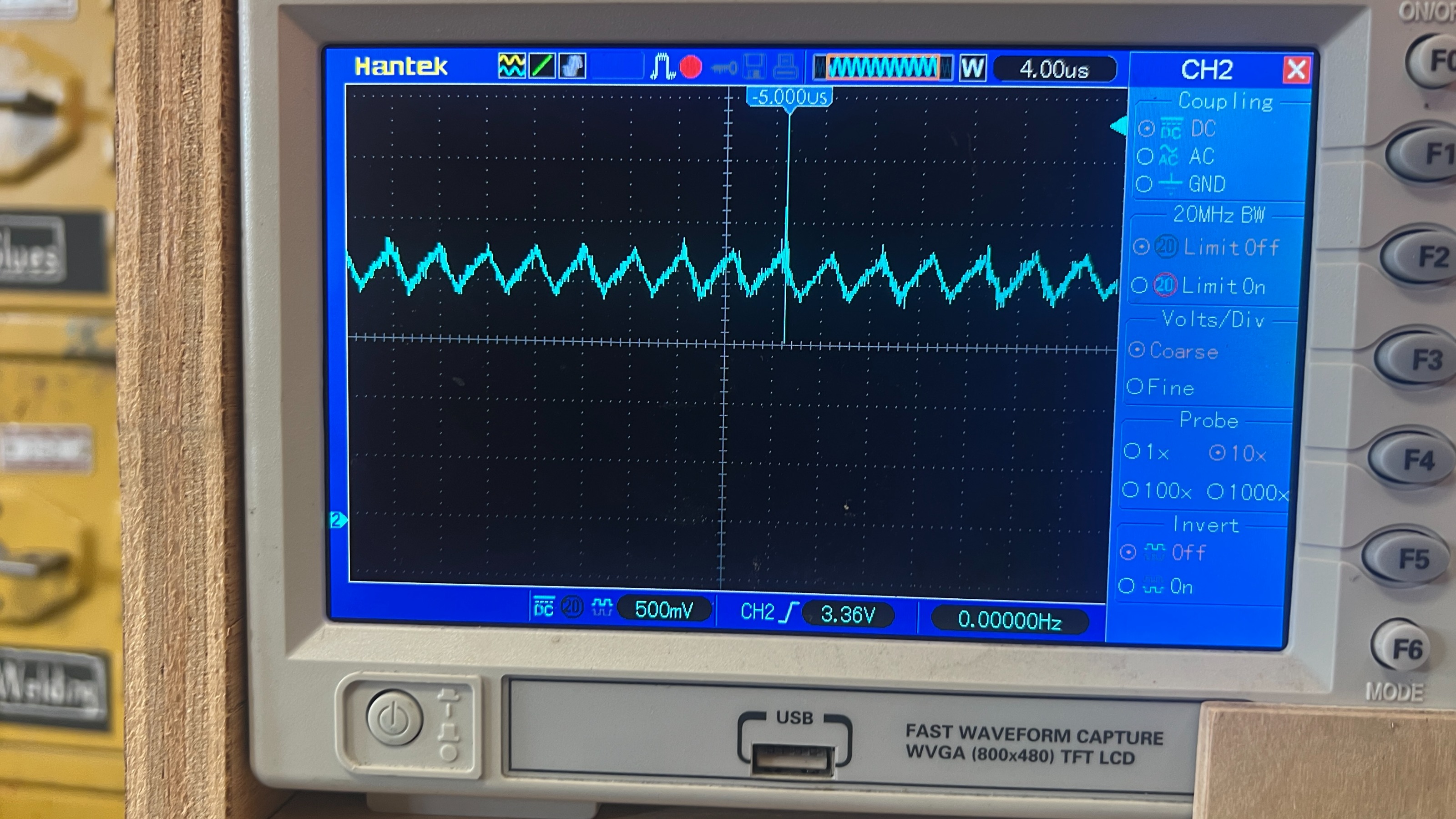

EDM is very noisy and may have voltage spikes on the "ground"
that exceed the +-25V peak limitations of the 7I96S encoder
inputs.
Since it appears the you did not connect the grounds together there is
opportunity for these spikes to damage the 7I96 inputs. It may well be OK
but the way is was connected could not work.
I think you misunderstood the PWM output. It does no appear to be
a differential signal, so must connect to PWM --> IDX+ and GND --> GND
The frequency pin should show the current PWM frequency
The valid pin is true when the PWM frequency is above the
minimum frequency (basically a fault indication)

I got a chance to spend some time with the oscilloscope today am getting interesting behavior out of the EDM supply. What I am seeing is a sine wave that has an amplitude of about .5v. This entire sine wave moves up and down depending on the intensity of the EDM cut. At no cut it is at 0 volts and at short it is at 3.3v. In other words it seems to be behaving like an analog signal. It seems to me that will not work with the periodm func in mesa. I have contacted the creator of the Powercore EDM to see if this is the correct behavior or if something was damaged.
My alternative plan is to use an arduino that I have here to take the analog input and send it to the computer via USB to monitor cut duty cycle. Hopefully the python script that I am writing can accommodate communication with the arduino.

The freq pin is 0 and the valid pin is false. So it appears that there is an issue with the PWM measuring.
