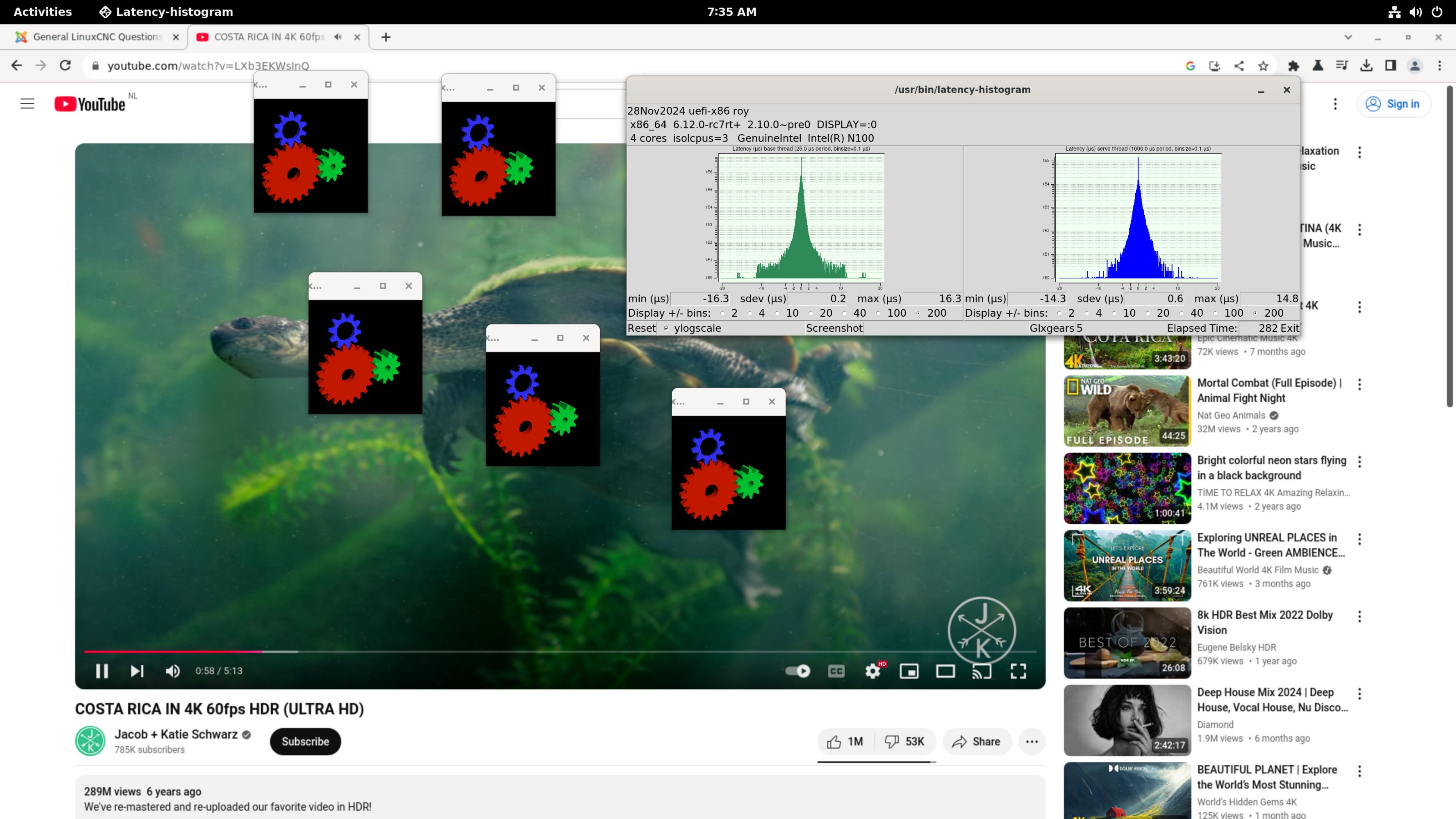

28 Nov 2024 06:08 - 28 Nov 2024 06:39 #315437
by royka
Replied by royka on topic Real-time kerel not detected on patched 6.12
Solved, the issue is that LinuxCNC checks /sys/kernel/realtime for a 1. The realtime patch added this but this part didn't become mainline.
I made this patch in case someone else wants to compile a custom kernel.
Last edit: 28 Nov 2024 06:39 by royka.
- royka
- Posts: 383
- Thank you received: 135
30 Nov 2024 12:15 #315643
by royka
@rodw Can you confirm that it's the same with the Raspberry or is that kernel source already patched?
I noticed that the patch only works when VMCORE_INFO=y which gets selected by:
- CRASH_DUMP [=y] && ARCH_SUPPORTS_CRASH_DUMP [=y] && KEXEC_CORE [=y]
- PROC_KCORE [=y] && PROC_FS [=y] && MMU [=y]
Is really necessary for LinuxCNC to check that /sys/kernel/realtime or will checking for "PREEMPT_RT" in uname -v be enough?
