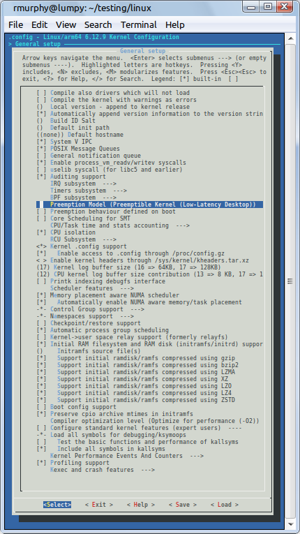

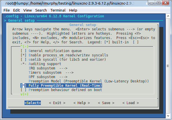

- Posts: 1200
- Thank you received: 426
12 Jan 2025 04:36 #318750
Replied by Cant do this anymore bye all on topic Real-time kerel not detected on patched 6.12
And for 6.12 the patches from kernel.org are still required, other wise you can only select a low-latency desktop, not a fully_preemptible model, which would appear to be "a proper realtime kernel" suitable for a RTOS.
I've work through the image builder for 6.12.y, and I can say from configuring the kernel, that the patches from kernel.org are required. Depending on the commit you chose in the 6.12.y branch there may not be a matching patchset.
So it's not just a case of choosing the 6.12.y branch but also the commit that matches a patchset that is available.
Image below shows a kernel from the 6.12.y branch, commit 236f36133619216a5c8faea1a8c2c93c83efc2f4, which is kernel 6.12.8. This is has been patched with those from kernel.org and a patch, required for the build process to succeed, from Rods repo. As you can see there is an option to select the full preemptible kernel. Without the patch this does not appear. Yes while the sysfs patch does add the ability to report to Linuxcnc the kernel is "realtime" the kernel is only a low-latency-desktop.
As I type I'm running an image build on another machine.

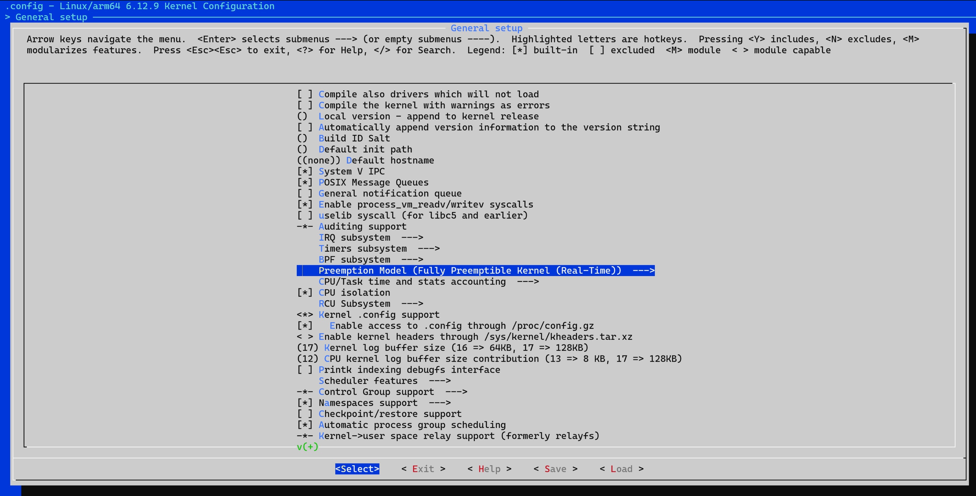

12 Jan 2025 05:11 - 12 Jan 2025 05:20 #318755
by royka
Replied by royka on topic Real-time kerel not detected on patched 6.12
I don't know what you do wrong, but this is without any patch or modification:
It seems that this user also didn't need additional patches: forum.linuxcnc.org/38-general-linuxcnc-q...6-12?start=10#318472

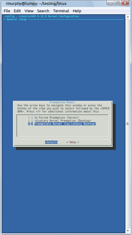

- Posts: 1200
12 Jan 2025 06:00 #318762
- Posts: 1200
12 Jan 2025 06:08 #318763
Another thing of interest there are still patches.
Directory listing of the patches that are for 6.12.8 none for 6.12.9 as you can see (6.12.8) has patches for sysfs entry and one to for enable arm rt.
So this looks like a very confusing kettle of fish.
