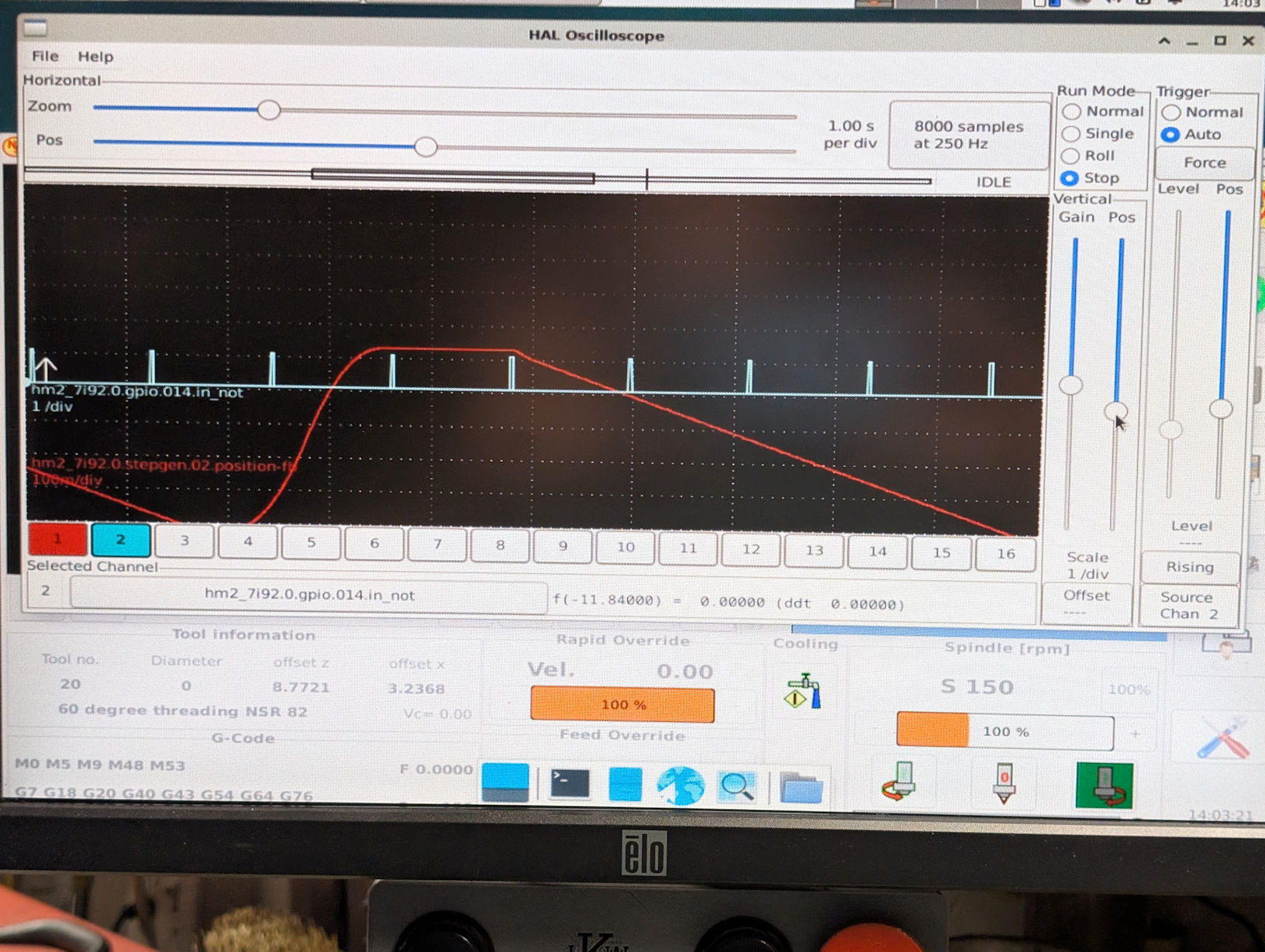

These are some great questions. I spent some time collecting information to address them.

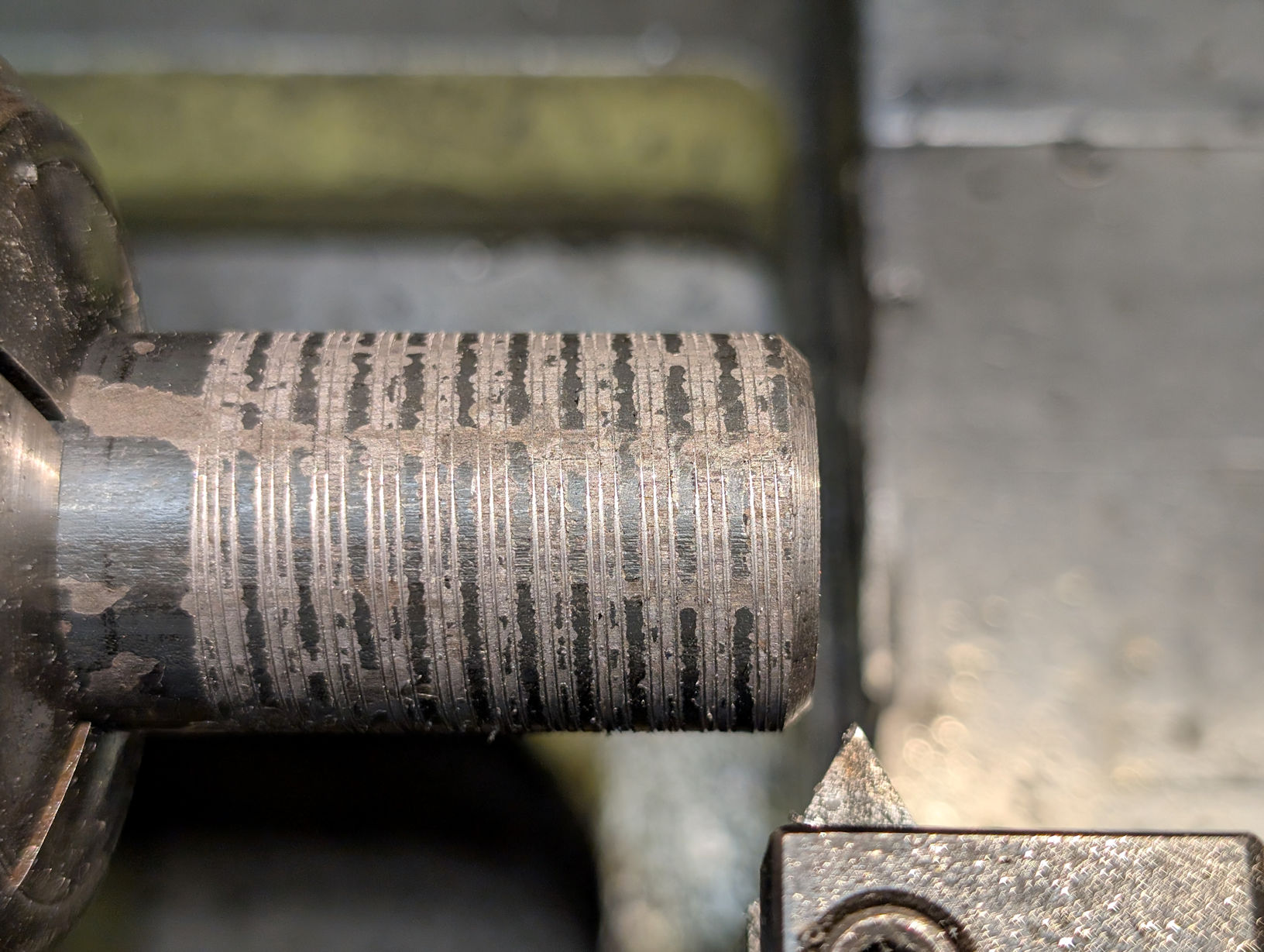

cakeslob question: I ran the 1"-8 scratch threads again. I tried hand turning the spindle, then ran it at 100, 150, and 200 RPM. I found the following:
1) Yes, you can run the threading G-code and cut the thread by turning the spindle by hand
2) The hand turned scratch wobbles a bit compared to the ones at set speeds
3) The hand turned scratch is the leftmost one in the photo, then the 100 RPM to its right, then the 150 and the rightmost thread at 200 RPM.
4) The spacing of the scratches, measured as best as I can from the hand turned scratch line, is
a) 0-100RPM -0.025"
b) 0-150 RPM -0.055"
c) 0-200 RPM -0.085"
This supports andypugh's comment about the Y axis having to catch up the position after it detects the index pulse. The faster the speed, the more the thread falls behind the desired position.
PCW question:
I've attached my INI and HAL files.
Here's the section for the Z axis

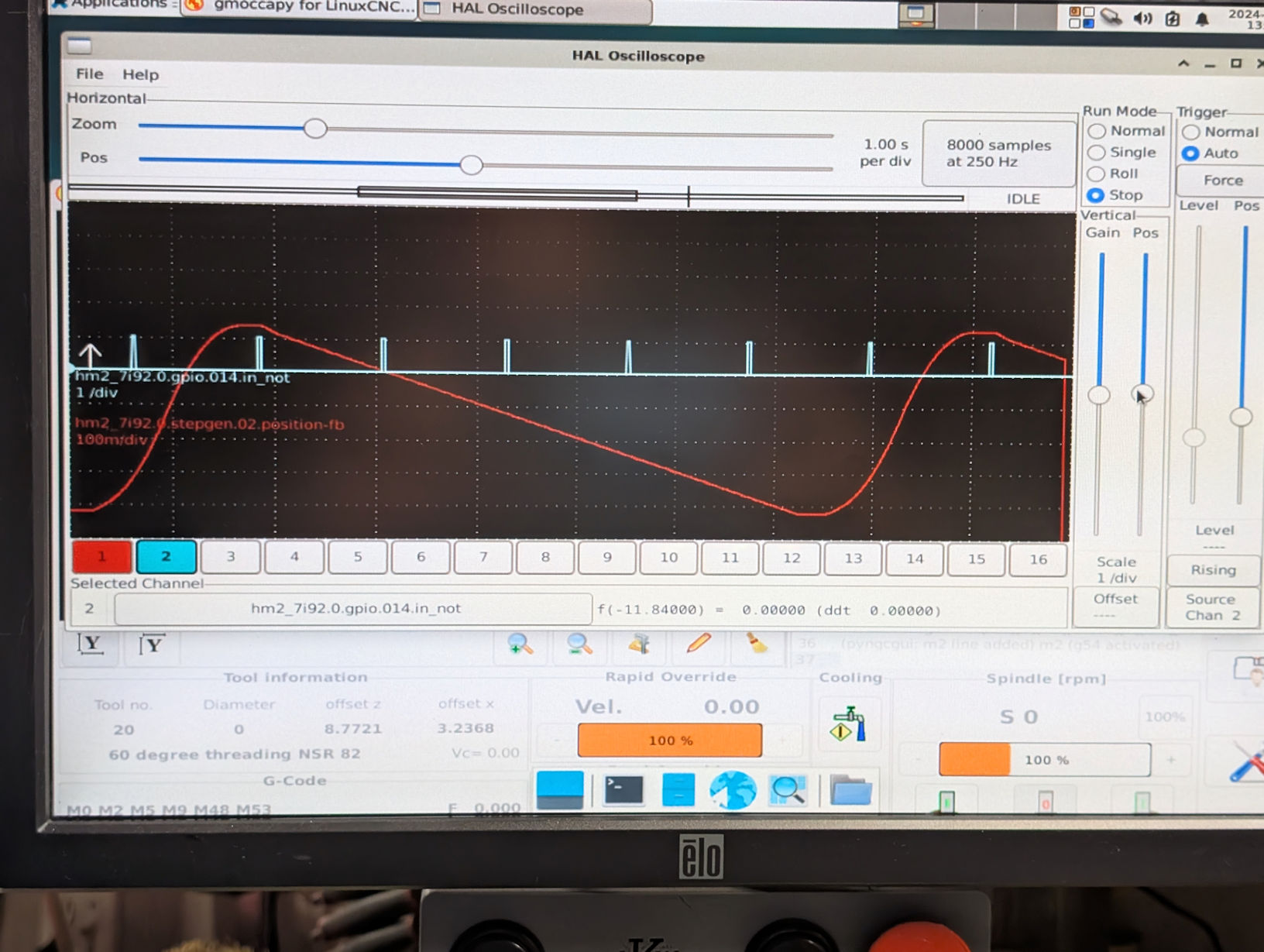

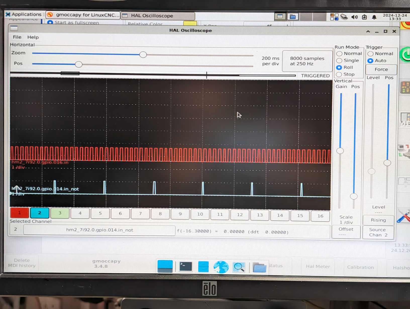

I used HALSCOPE and watched hm2_7i92.0.gpio.014.in_not (spindle index) and hm2_7i92.0.gpio.016.in (spindle A). That was working as expected, as I got one index pulse per 10 "A" pulses.
I then watched the spindle index and hm2_7i92.0.stepgen.02.position-1b (Z axis position) while running the threading program.
For 100 RPM:
For 200 RPM:
This looks to me like it's working as expected, where the falling index pulse begins the carriage Z movement. Note that I have steppers and this is not a real feedback signal on the position..That leads me to believe that LincxCNC is working correctly and that my problem is a physical one with my lathe.
a) 0-100RPM -0.025"

BACKLASH = 0.008I used HALSCOPE and watched hm2_7i92.0.gpio.014.in_not (spindle index) and hm2_7i92.0.gpio.016.in (spindle A). That was working as expected, as I got one index pulse per 10 "A" pulses.
For 100 RPM:
For 200 RPM:

24 Dec 2024 18:14 - 24 Dec 2024 18:21 #317315
Replied by PCW on topic Threading Index Varies With Speed
setp hm2_7i92.0.packet-read-timeout 30
I would set this to 80 ( 80% = 800 usec at a 1 ms servo
thread period), or just comment it out
If you are dropping many packets, that might
be an issue.
Loss of steps might be an issue also. This may be improved
by using the interpolated encoder position, as a 10 count
per turn encoder is going to give a very rough Z axis position
command, only smoothed by the acceleration limits.
The Z motion plots look linear so the main error seems to be a variable offset
at the start. Are multiple passes at the same speed perfectly aligned?
The start and end of motion use maximum acceleration so possible
locations of lost steps.
