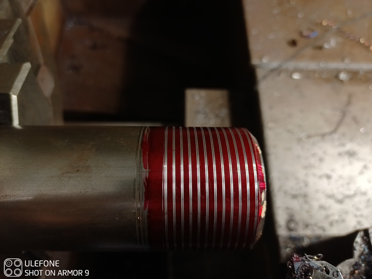

01 Jan 2025 04:17 - 01 Jan 2025 04:47 #317765
by radom
Replied by radom on topic Threading Index Varies With Speed
last time I tried to fix existing thread I set rpm to 0 and turned lathe chuck by hand to line up the threading tool and it looked good but when I run the program it just mangled the thread but I though I messed up something
so today I did the test with 100, 200rpm 266 and 300 and none of them line up with each other
this is so funny to me, it's just like stupid fanuc
my lathe is analog servo motors
photo with 100 nad 200rpm
Last edit: 01 Jan 2025 04:47 by radom.

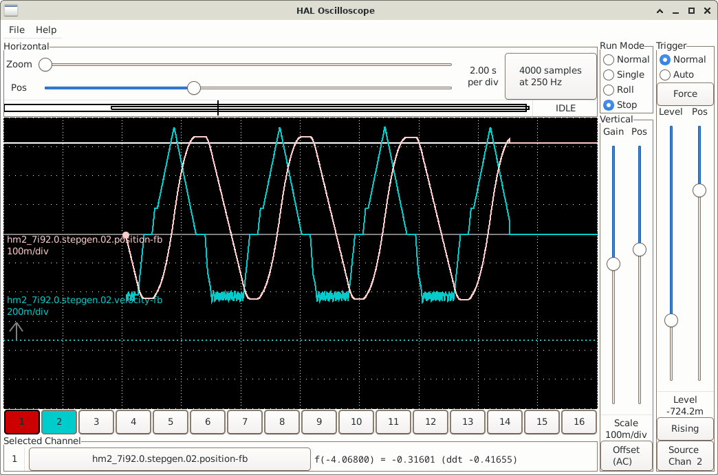

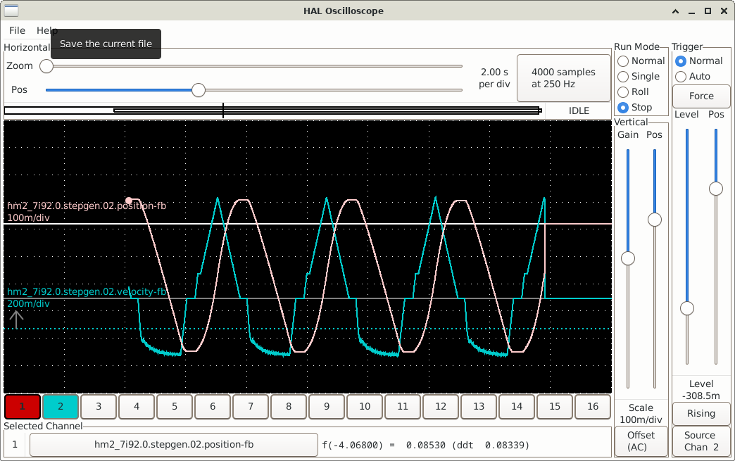

01 Jan 2025 09:27 #317780
by 10K
Replied by 10K on topic Threading Index Varies With Speed
I ran a couple of tests this morning to see if I could figure out why the velocity started working OK. These two scope captures are both at 200 RPM, running the same threading program. It shows me that 10 teeth is not adequate for some operations, and that I should modify the spindle with a new gear with more teeth. I'm thinking I'll do 180 teeth/rev. It'll take me a while to make the modifications.
I don't expect this to fix the original problem of threads not aligning at different speeds, but it should fix the slightly varying thread pitch..
HAL using: net spindle-position encoder.0.position => spindle.0.revs
HAL using: net spindle-position encoder.0.position-interpolated => spindle.0.revs

01 Jan 2025 10:23 #317783
Replied by PCW on topic Threading Index Varies With Speed
It does look like using the non-interpolated position
(perhaps because of the low resolution)
triggers some kind of bug with the tracking.
Its a bit disappointing that LinuxCNC does not cut the same
thread at different speeds, that really does seem like a bug.
(and a bit unexpected since mechanical threading doesn't have this issue)
