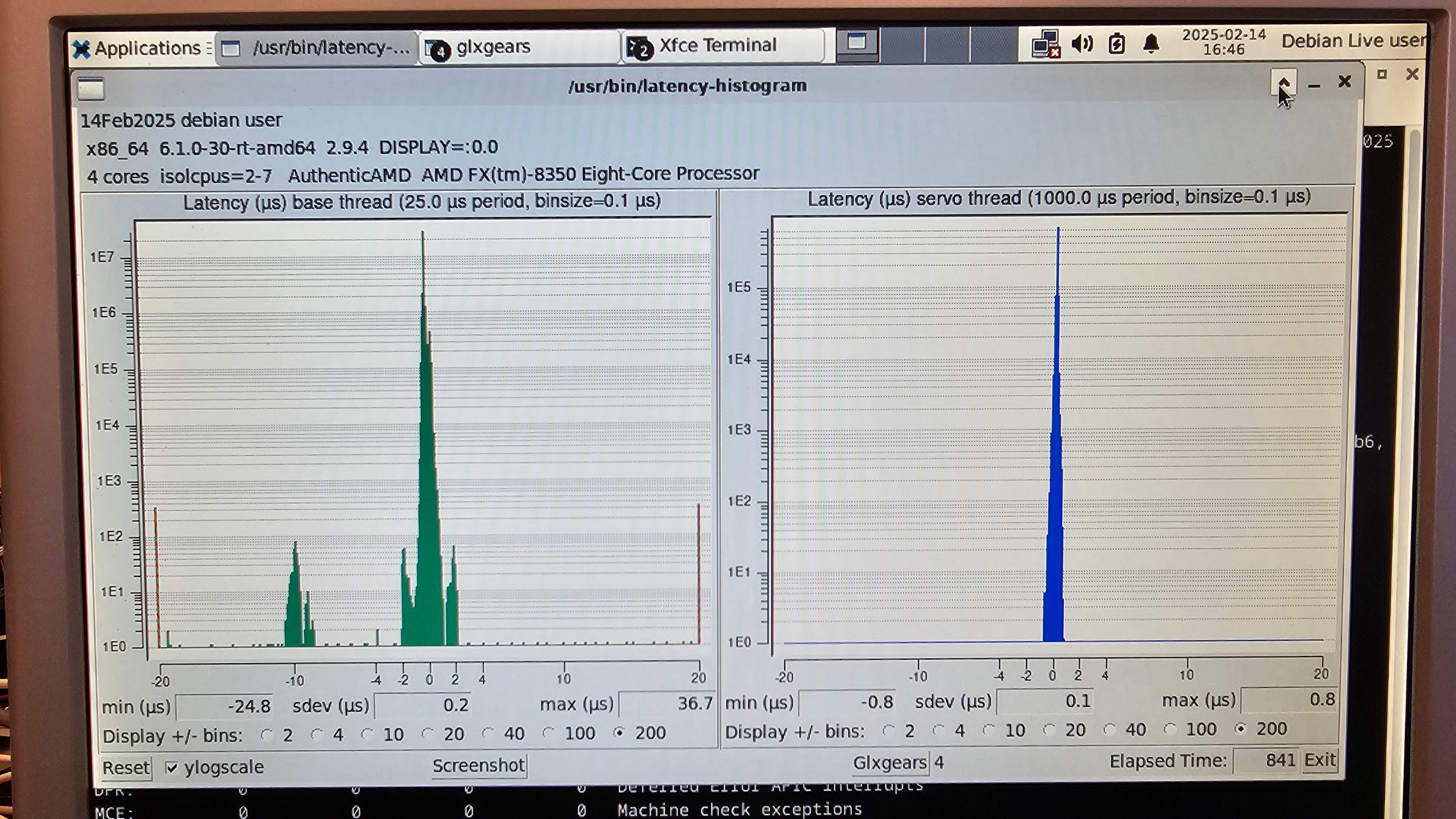

How can I track down the remaining sources of jitter?
I have reduced the jitter a lot, but there are still some odd areas of jitter in my base histogram that I can't track down.  On my base thread, you can see a few spikes out at -20us and 20us and also some spikes around -10us.  (I'm going to use the parallel port for driving my milling machine.)
I'm using an AMD FX-8350 cpus on a biostar A880GZ motherboard.  The AMD FX-8350 has 4 cores each with 2 threads, but I set nosmt, so linuxcnc is only using 2 cores.  I'm using the integrated graphics card.  It is ATI Radeon HD4250 Graphics .
I am running from a live usb drive with the following boot command.
    linux    /live/vmlinuz-6.1.0-30-rt-amd64 boot=live components quiet splash findiso=${iso_path} skew_tick=1 nosmt=force kthread_cpus=0-1 irqaffinity=0-1 rcu_nocb_poll rcu_nocbs=2-7 nohz=on nohz_full=2-7 isolcpus=2-7 intel_pstate=disable amd_pstate=disable idle=poll cpufreq.off=1 cpuidle.off=1 intel_idle.max_cstate=1 amd_idle.max_cstate=1 nowatchdog nosoftlockup
    initrd    /live/initrd.img-6.1.0-30-rt-amd64
When booted I also set
  1. sudo sysctl kernel.timer_migration=0
  2. sudo sysctl kernel.sched_rt_runtime_us=-1
(All these setings based on:  dantalion.nl/2024/09/29/linuxcnc-latency...arameter-tuning.html )
When I run
watch -n 1 -d cat /proc/interrupts
I only see LOC (Local timer interrupts) on CPU2, CPU4, and CPU6, until I start the latency-histogram.  All other interrupts are on CPU0.  After starting the latency histogram I also see IWI (IRQ work interrupts) on CPU6.  (Note: I tried not isolating CPU6. Then the IWI interrupts stayed on CPU6, but the histogram looked worse.
I think I've disabled everything I can in the bios, but maybe I misunderstood some bios setting, and mistakenly turned something on.  Here's all my settings I think apply:

Any ideas where I can further reduce jitter?

14 Feb 2025 21:12 #321610 by tommylight
Replied by tommylight on topic Can't eek out that last bit of jitter
Do you need a parallel port?
If not:
latency-histogram --nobase --sbinsize 1000 --show

15 Feb 2025 10:05 #321648 by tommylight
See the downloads page on how to install the RTAI kernel and RTAI LinuxCNC version, they should be much better for latency on older hardware.
Also, always use --show for latency histogram, in your screenshot you can see excursions on both sides of the base period plot.
