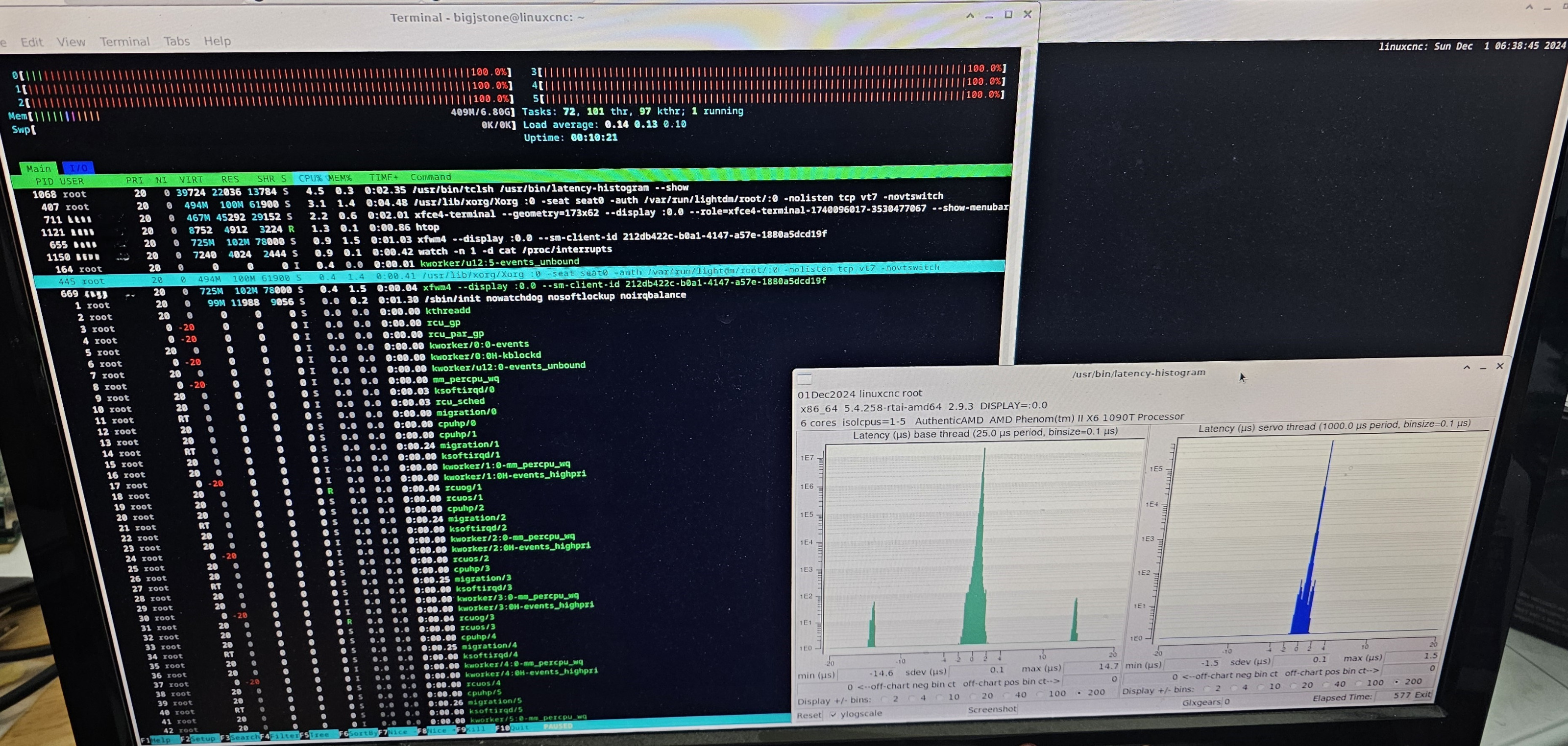

Do you happen to know the names of the base and servo processes? I see migration/0 through migration/5 and rtkit-daemon listed as RT in htop. They don't seem to increase in time though, so I'd guess they aren't being used. There are some -20 priority processes too.

Here's one of the times it looked pretty good for awhile.

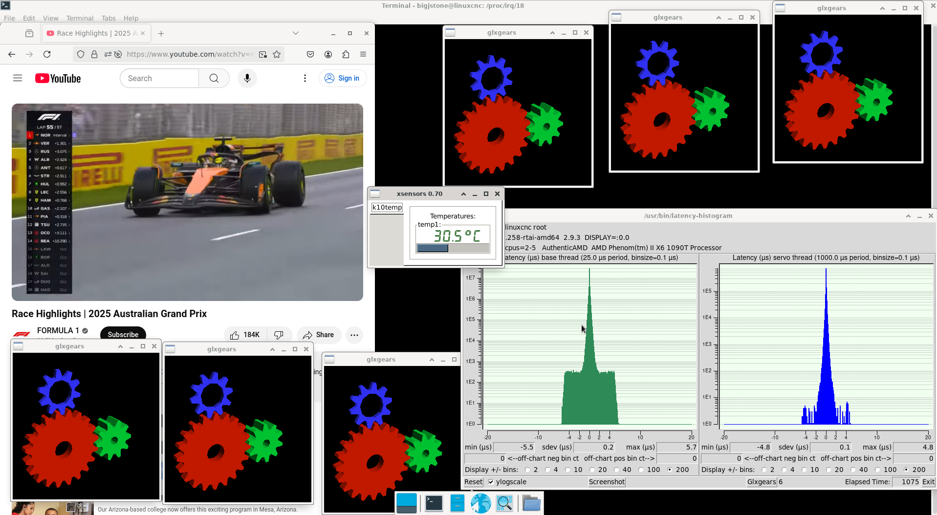

So far, that works!  I don't think I ever would have gotten there without your help.  Thank you.
I didn't end up deleting everything in my grub setup, but I put in everything you added.  The 1090T only has 6 cores, so I reduced the 7s to 5s.  I ended up with:
 smt=1 ro quiet skew_tick=1 nosmt=force mds=nosmt mitigations=auto,nosmt irqaffinity=0-1 kthread_cpus=0 rcu_nocb_poll rcu_nocbs=2-5 nohz=on nohz_full=2-5 isolcpus=2-5 intel_pstate=disable amd_pstate=disable idle=mwait clocksource=tsc tsc=reliable cpufreq.off=1 cpuidle.off=1 intel_idle.max_cstate=0 amd_idle.max_cstate=0 processor.max_cstate=0 nowatchdog nosoftlockup acpi_irq_nobalance noirqbalance default_hugepagesz=1G hugepages=4 transparent_hugepage=never threadirqs forcedeth.use_msi=0 mce=ignore_ce nmi_watchdog=0 audit=0 initrd=/install/gtk/initrd.gz
Not only does it work, it is also running much cooler.  Now the CPU is around 31C, and before it was near 50C.
This result is using the A880GZ with integrated HD4250 graphics.  (I didn't need the R5 340X, but I may try it out just to give others info.)
Thank you so much!

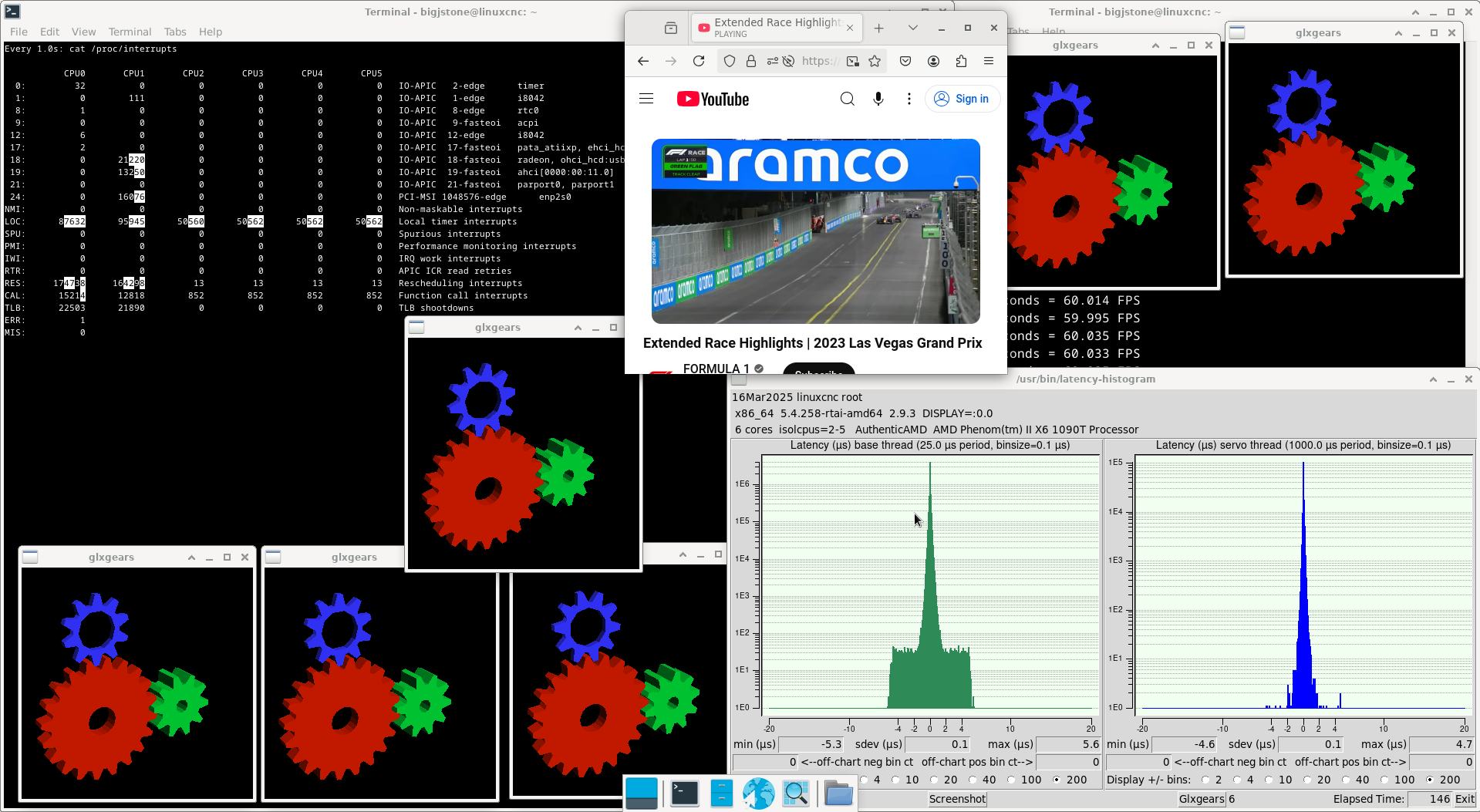

For anyone wondering when I tried with the R5 340X graphics card, the max base jitter went up to +/-30us.  So I guess that isn't a good graphics card for linuxcnc, or maybe it just doesn't work with the A880GZ and linuxcnc.
Also, in case anyone is interested in, here is a screen shot including the watch of /proc/interrupts when using the integrated HD4250 graphics card with the biostar A880gz .
16 Mar 2025 20:48 #324085 by webbyguy
Replied by webbyguy on topic Can't eek out that last bit of jitter
Oh, and on that screenshot, I did NOT run
swapoff --all
systemctl --user stop pulseaudio.socket
systemctl --user stop pulseaudio.service
sudo sysctl kernel.sched_rt_runtime_us=-1
I guess they were unnecessary. (Although maybe I had added that last one to startup in some way before, but I don't remember.)
