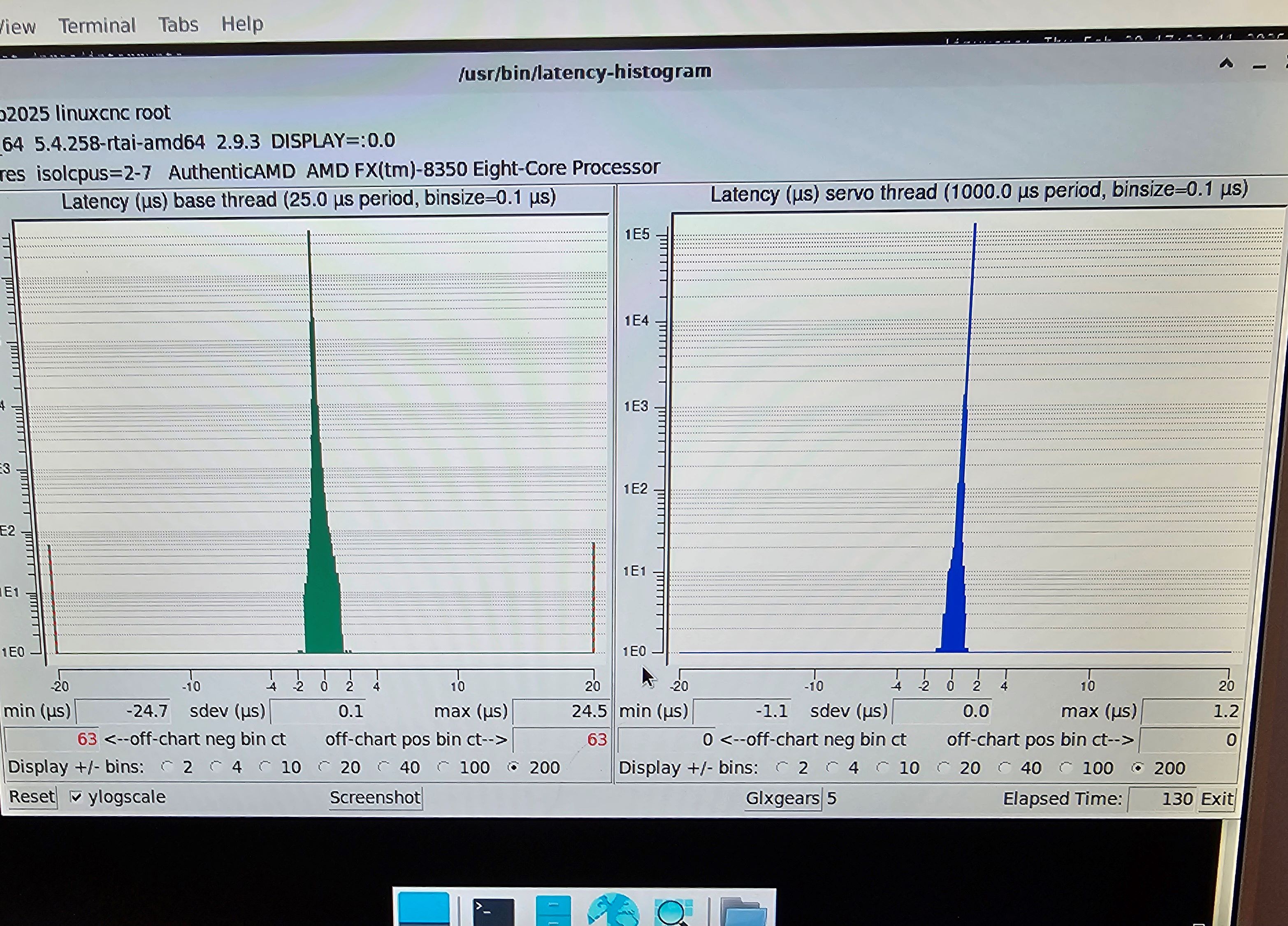

Okay, I finally have the rtai version running, but I seem to only be able to run the latency-histogram as sudo.  Is that the way you're supposed to use the rtai version?

The reward for all this... It looks like my min/max base thread latency is about the same as the preempt_rt version. :-(
Any other ideas what to try?

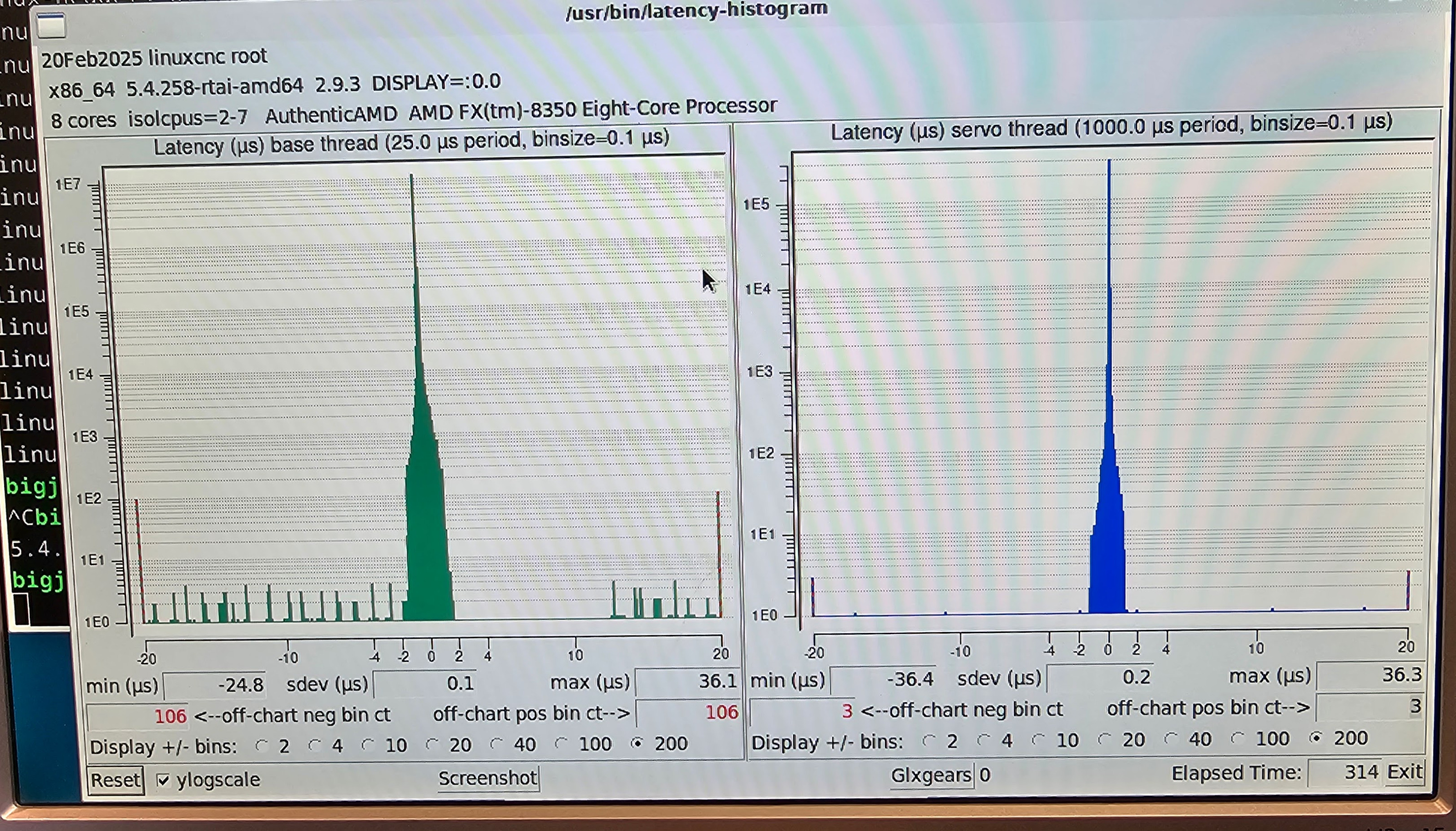

20 Feb 2025 18:33 #322137 by webbyguy
Replied by webbyguy on topic Can't eek out that last bit of jitter

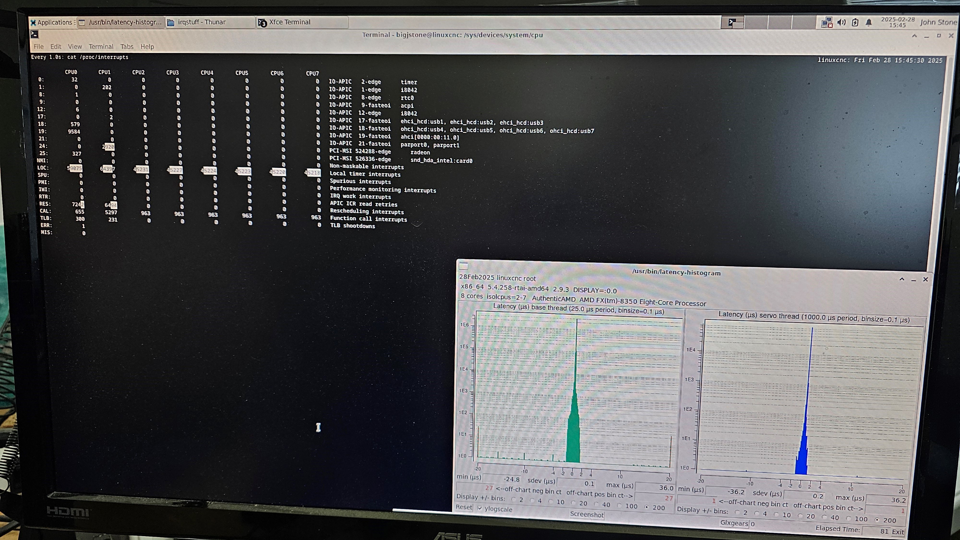

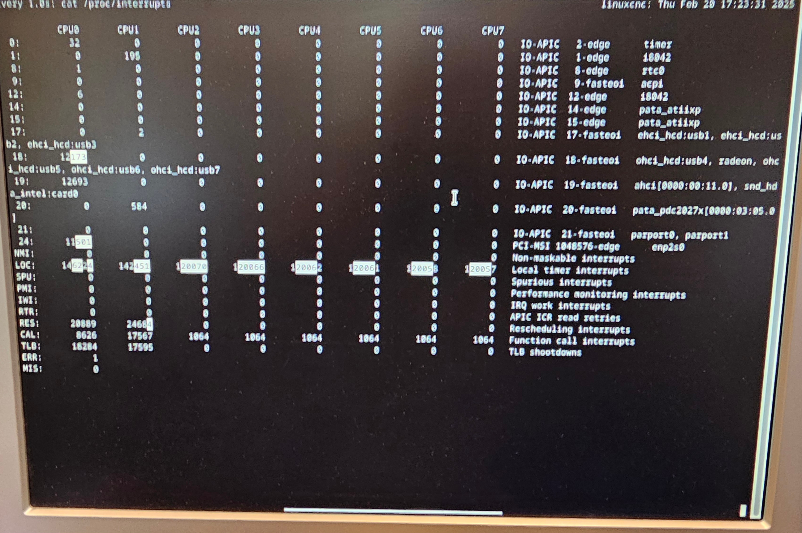

Actually I found a mistake in my grub command line.  Now my histogram is better, in that there are only a few excursions to debug now.
It looks like only interrupt that seems to fire at roughly the same frequency is IRQ 20 which is described as
IO-APIC 20-fasteoi pata_pdc2027x[0000:03.05.0]
It is interesting that it fires on CPU1.  I thought I had a command in my grub setup to disable hyperthreading.
  • tommylight
  • tommylight's Avatar
  • Away
  • Moderator
  • Moderator
20 Feb 2025 18:40 #322140 by tommylight
Replied by tommylight on topic Can't eek out that last bit of jitter
pata = Parallel ATA or the old hard drive comms, not used since .... long ago
If you are using an normal IDE hard drive, not much you can except maybe changing the IRQ number in BIOS, although some boards might now allow it.
If you are not using IDE, then disabling them in BIOS might just be possible.
Mind you, almost all SATA controllers can emulate PATA, so if your SSD is not set to AHCI, disabling IDE is not possible, but setting the SATA to AHCI in BIOS should remove PATA showing and using an IRQ.

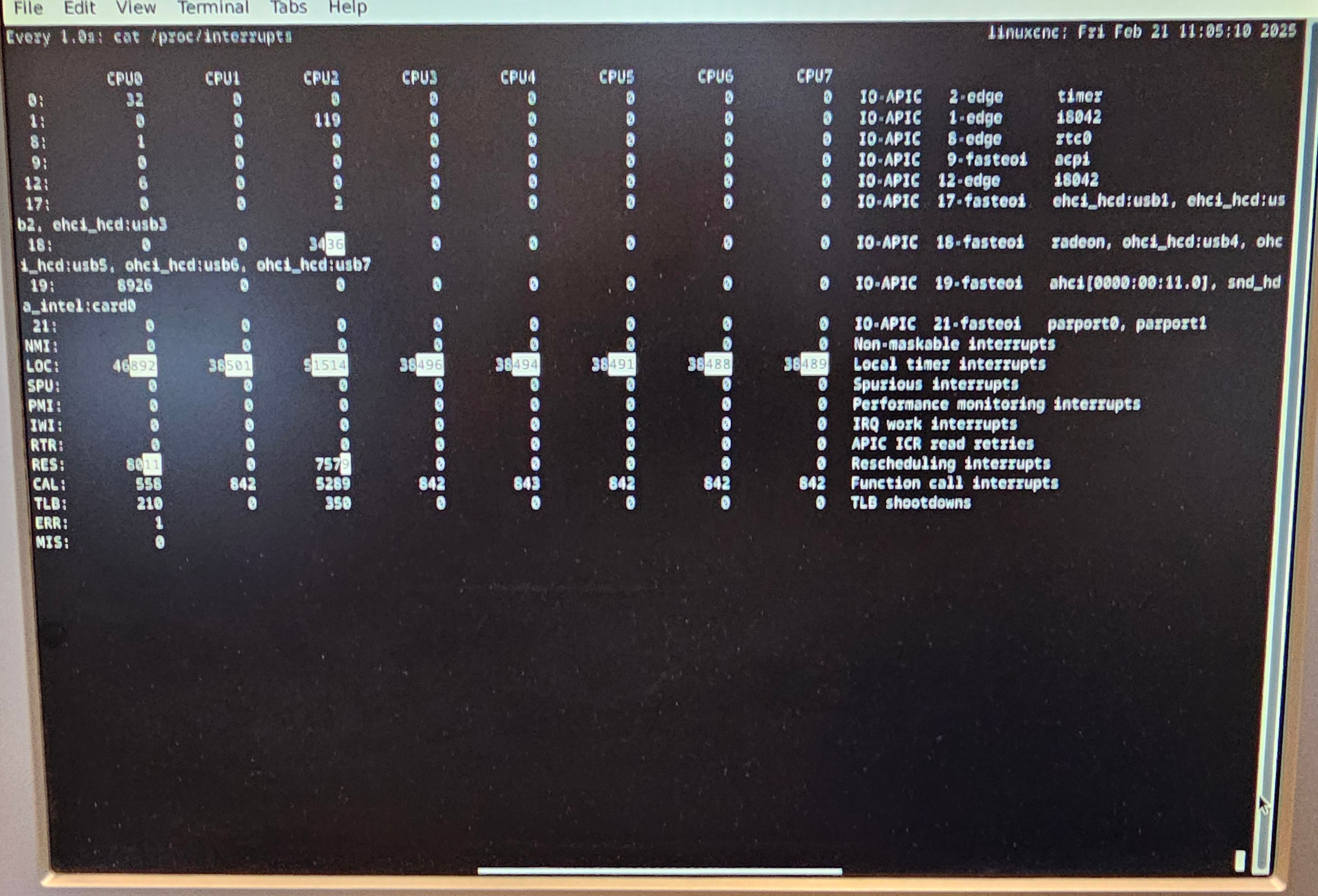

21 Feb 2025 12:45 #322218 by webbyguy
Thank you Tommy,
You were right that that was the PATA setting in the bios.  I changed it to AHCI, and now that interrupt is no longer on the list anymore.
Unfortunately, it doesn't appear that was the cause of my jitter.
Now the only things causing interrupts are
18 - Radeon HD 4250 internal graphics
LOC - (Local timer interrupts)
RES (Rescheduling Interrupts)
Is there anyway to see what causes the RES and LOC timer interrupts to see if the jitter is caused by one of those?
Sometimes 19 also happens, but it doesn't seem to sync up with times that the jitter has variance.
For some reason the nosmt=force setting in the kernal boot parameters doesn't seem to work anymore with the rtai kernel.  Should nosmt still work in the rtai kernel?
I have the following settings in:
ro quiet skew_tick=1 nosmt=force mitigations=auto,nosmt irqaffinity=0-1 kthread_cpus=0-1 rcu_nocb_poll rcu_nocbs=2-7 nohz=on nohz_full=2-7 isolcpus=2-7 intel_pstate=disable idle=poll cpufreq.off=1 intel_idle.max_cstate=0 amd_idle.max_cstate=0 processor.max_cstate=0 nowatchdog nosoftlockup acpi_irq_nobalance noirqbalance
I'm also using the irq affinity script from:  forum.linuxcnc.org/38-general-linuxcnc-q...ead-and-irq-affinity
Should I try a pci graphics card instead of the Radeon HD4250 integrated graphics?  Any recommendations?
