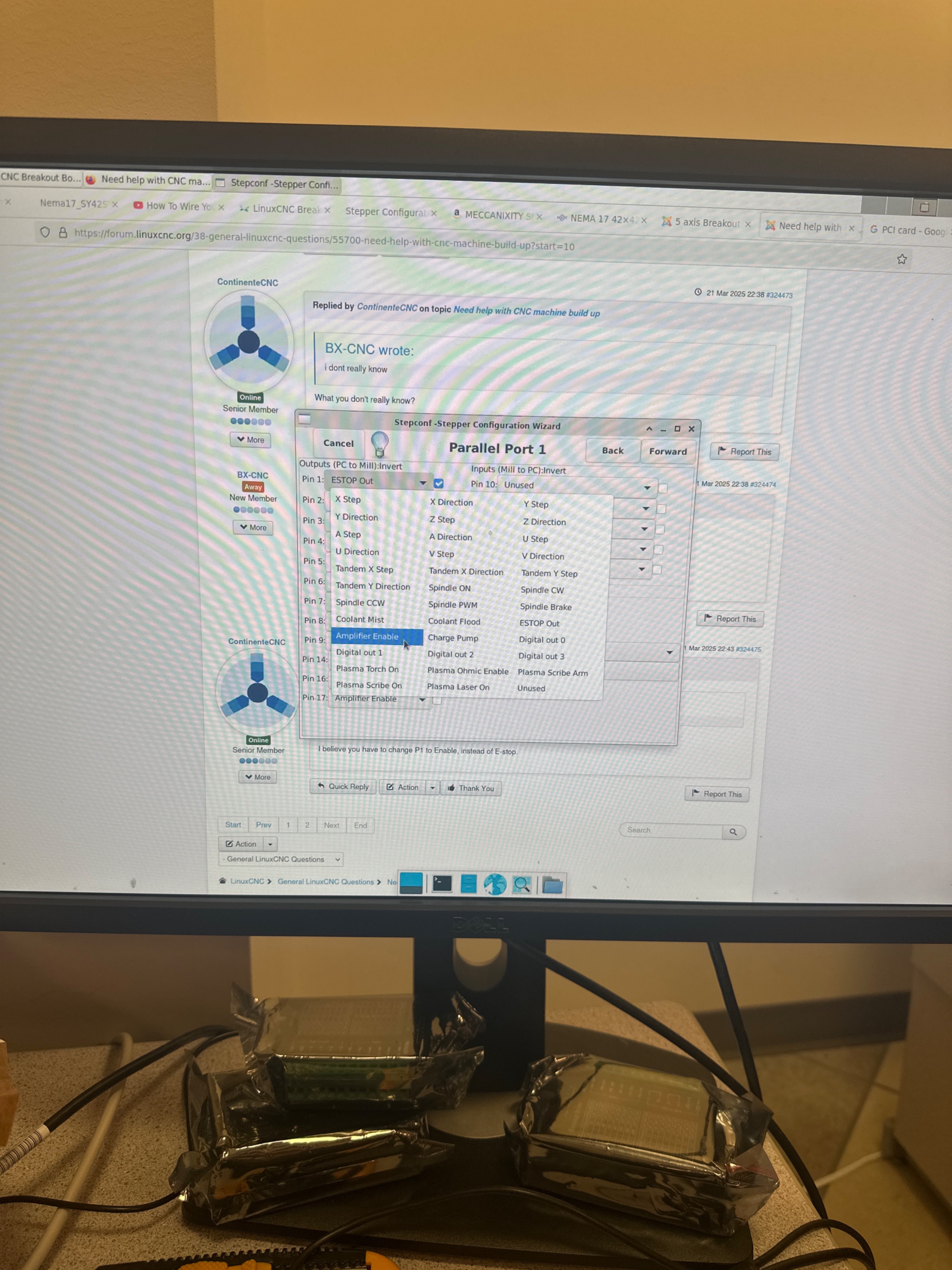

So should I unused all the other pins?

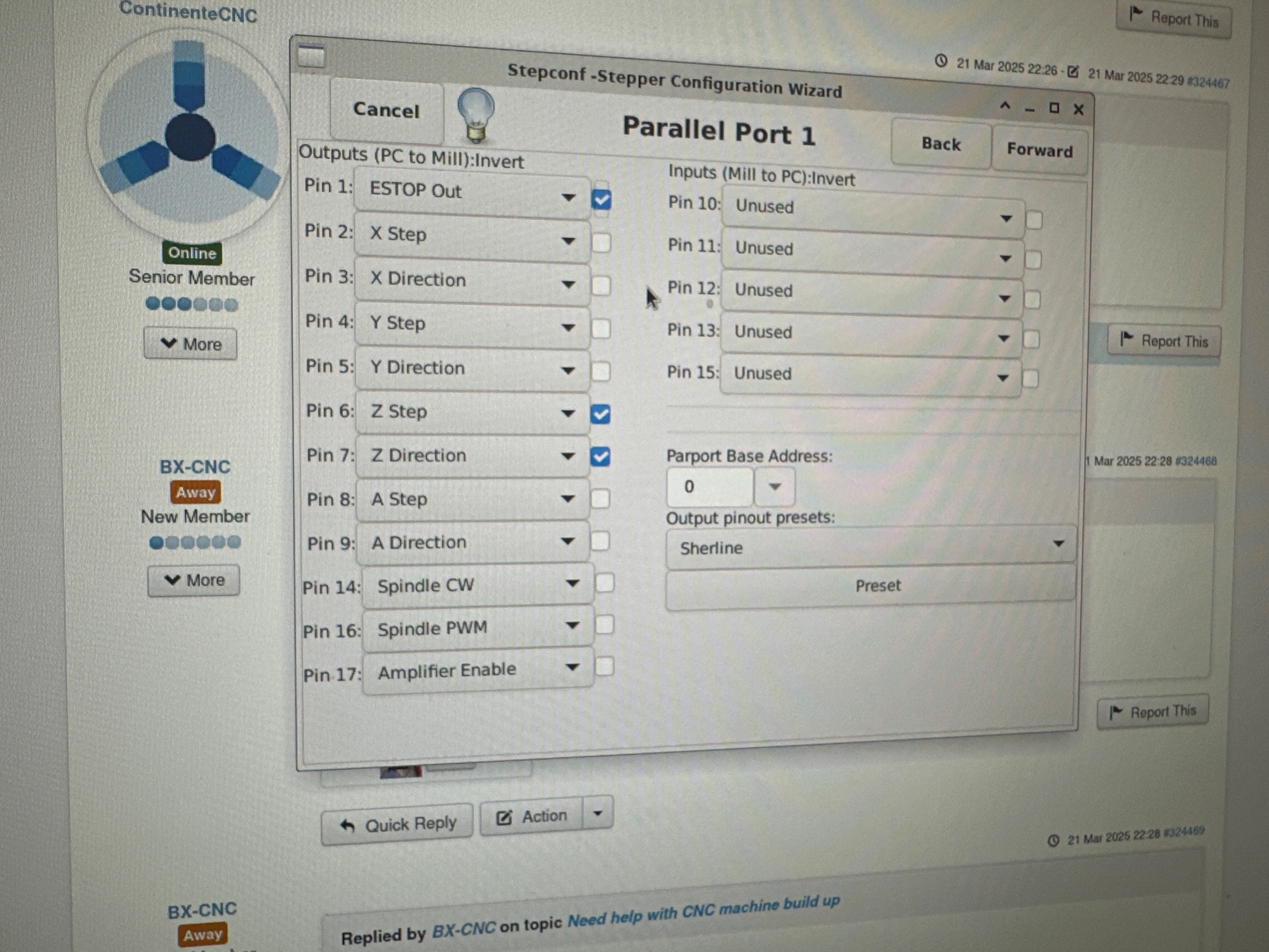

I believe you have to change P1 to Enable, instead of E-stop.
Replied by ContinenteCNC on topic Need help with CNC machine build up
If you are testing only one motor, no need to use others.So should I unused all the other pins?

This is the only enable I found

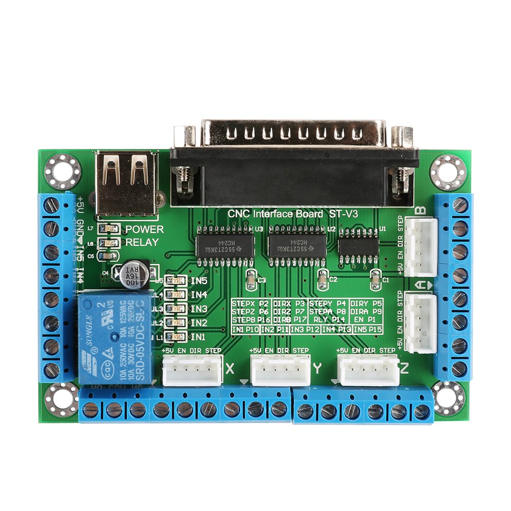

If your bob is exactly this one bellow, Amplifier Enable has to be P1.
Yes. It is this one.This is the only enable I found
