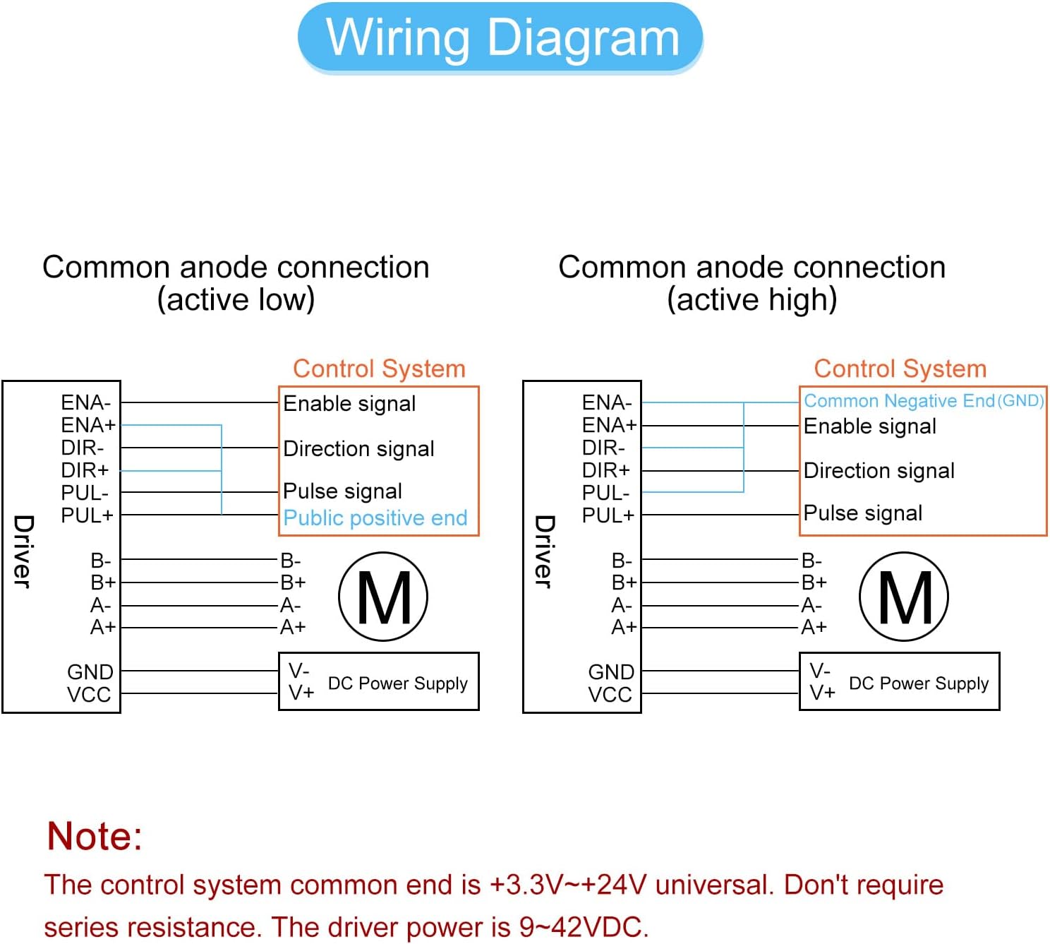

The first one, active low, theres jumper in pul+ DIR + and ENA+
Yes it is my driver
Is whitch of these ways is your stuff connected?

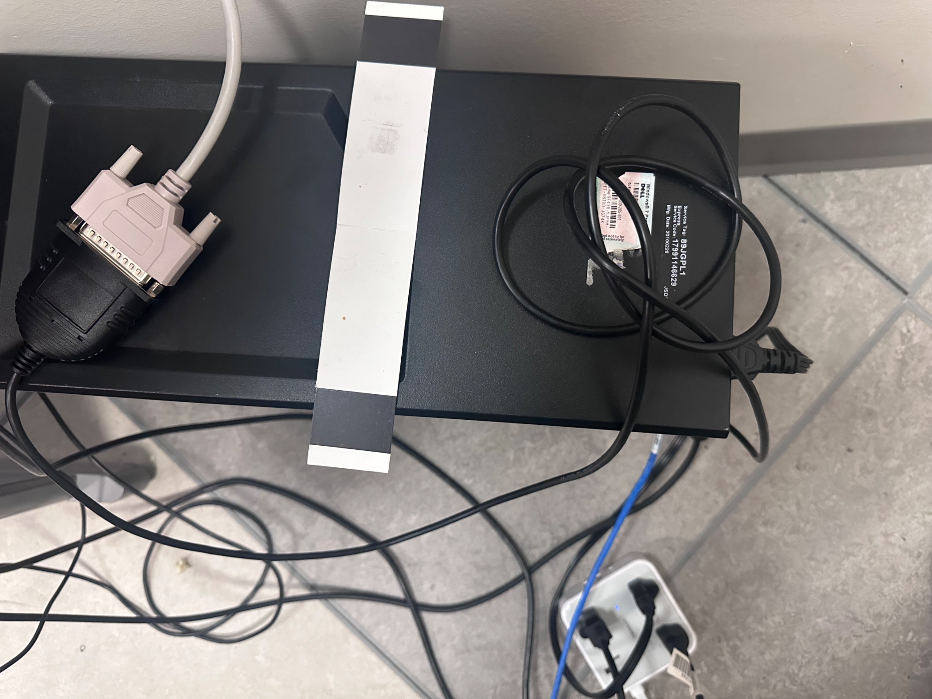

I have a old PC donated by school and I have a parallel port connected to PC with a USB adapter. Since this PC doesnt have a parallel port connection.

This is the connection. Parallel port from bob, port to usb adapter, adapter to pc

These USB adapters won't work.
You have to buy PCI card adapter with Sunix, Netmos or Moschip chipset. Avoid any WCH chipsets.
