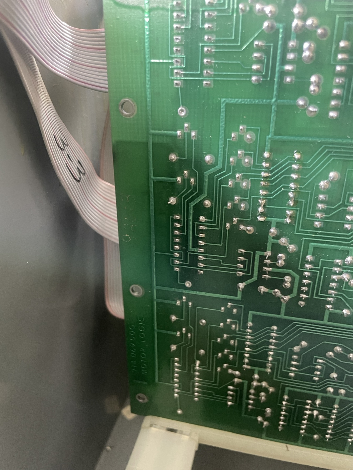

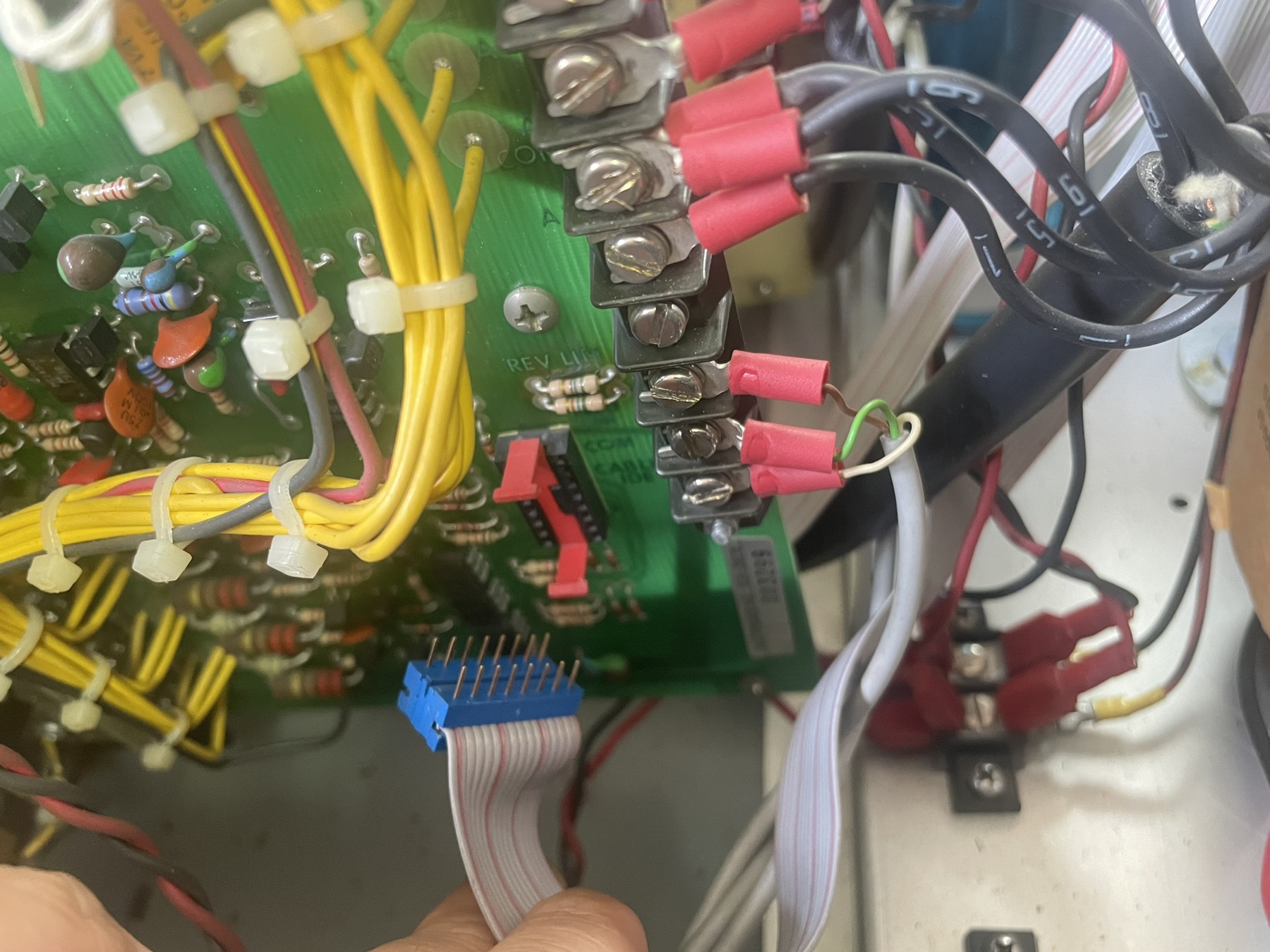

29 Mar 2025 16:46 #325260
Replied by PCW on topic bandit controller retrofit
Doesn't look like there much logic on the power cards, it may be the there are 4 individual
winding drive signals on the cable.
A good picture on the top of the card so you can read the part numbers might help figure
out whats going on.
out whats going on.

29 Mar 2025 16:52 #325263
by Masiwood123
Replied by Masiwood123 on topic bandit controller retrofit
ok, i can try to remove logic board to see the top.

31 Mar 2025 12:34 #325392
by langdons
Replied by langdons on topic bandit controller retrofit
Probably best solution:
Scrap/sell old drives.
Scrap/sell everything else in the bandit except transformers and power filters, etc.
Buy a new stepper drive (possibly hybrid servo), if your machine has an encoder of some sort.
Install LinuxCNC on a PC with a parallel port (parhaps a PCIe/PCI card).
Buy a breakout board.
Connect it up.
Done!

31 Mar 2025 12:44 #325393
by langdons
Where does the 48VDC come from?
If there is a transformer leading to a rectifier bridge, just connect the transformer directly to the new drives (connect each drive separately through a terminal block or something, do not "daisy chain" drivers).

31 Mar 2025 13:17 #325398
by langdons
What does the motor say on it?
Remember: the motor sticker/plate specifies the average (RMS) current.
The driver current will be listed as peak current (about 1.4x the average).
Therefore, a 4.6A stepper motor needs a 6.5A driver, for example.

03 Apr 2025 14:41 #325619
by Masiwood123
I bought the strongest driver of 7A, I will try as soon as I find some time to connect the existing motor in a bipolar connection with higher voltage and lower amperage, so we will see, if one works I will buy two more drivers and I think the problem would be solved, the controller in that case 7i96s for example.

03 Apr 2025 14:44 #325621
by Masiwood123
feedback is a linear measuring scale for all axis, in case those remain, I can additionally take a card that would read them as an encoder
