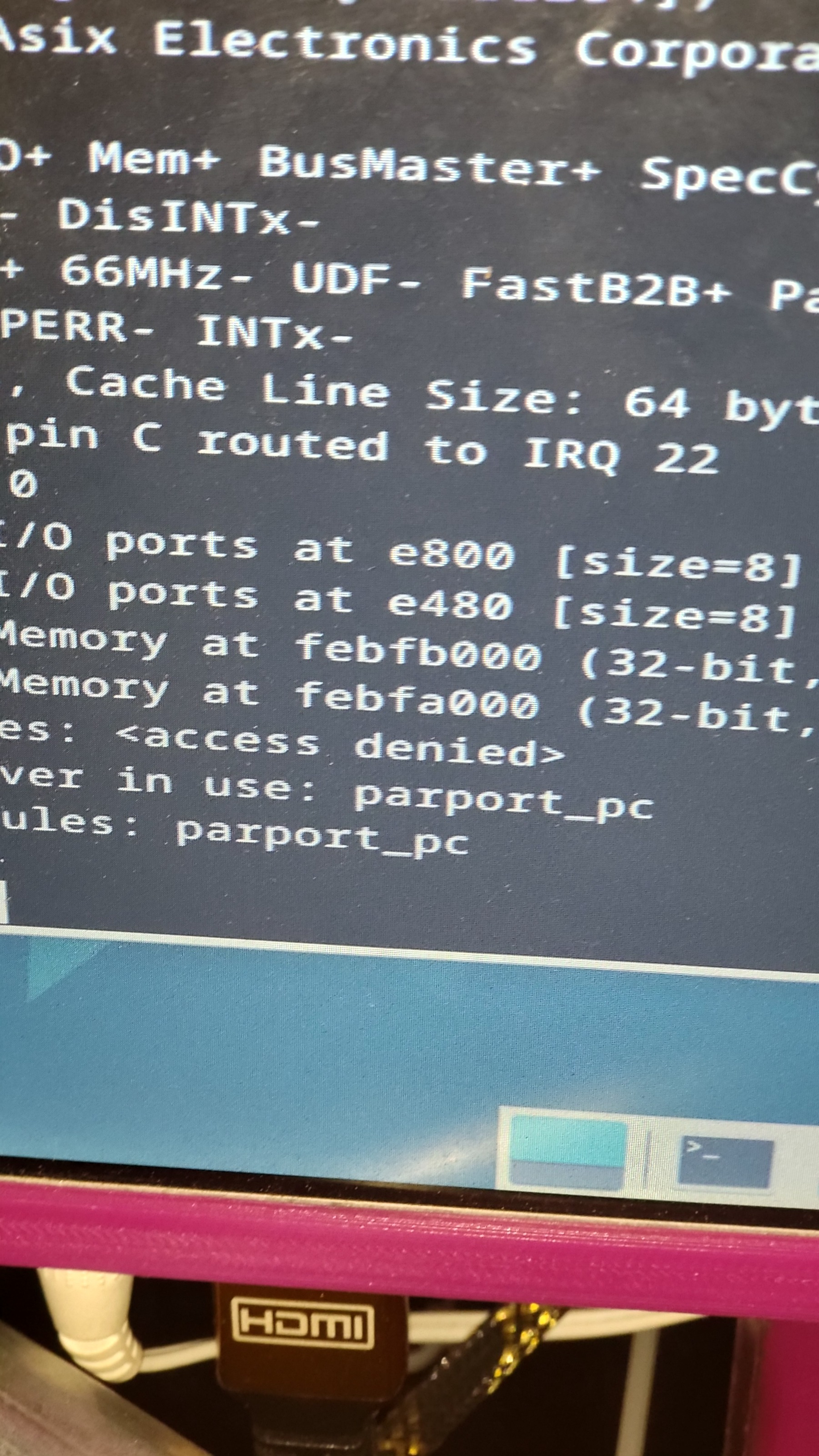

Hi All.
I apologise for posting this. I'm sure the solution is out there somewhere but all the stuff I can find seems not to work.
I want to run a pci card as a second parallel port for my DIY cnc. I want more inputs and some more outputs also. I am using a Generic breakout board that is identical to primary one I am using on Port 0. My board has a Parallel port on 0x378 This Port 0 in linux and works fine if I do in my hal file.
loadrt hal_parport cfg="0 out” or loadrt hal_parport cfg="0x378 out”
The PCI Card is some sort of generic MOSCHIP based card and it is detected as Port 1 in linux. It has two addressed associated with it 0xe480 & 0xe800I have tried the following in my Hal file
loadrt hal_parport cfg="0 out 1 out” (port 0 works port 1 nothing)
loadrt hal_parport cfg="0 1 out” (cant remember what this one did probably same as the rest)
loadrt hal_parport cfg="0x378 0xe480 0xe800 out “ (port 0 works port 1 nothing)
loadrt hal_parport cfg=”0x378 0xe480 out” (port 0 works port 1 nothing)
loadrt hal_parport cfg=”0x378 0xe800 out” (port 0 works port 1 nothing)
loadrt hal_parport cfg=”0x378 out 0xe480 out 0xe800 out “ (port 0 works port 1 nothing)
loadrt hal_parport cfg=”0x378 out 0xe480 out “ (port 0 works port 1 nothing)
loadrt hal_parport cfg=”0x378 out 0xe800 out “ (port 0 works port 1 nothing)
I have tried every variation I can think of but still get no output. I am testing using a multi-meter on two outputs on the port 1 breakout board had had set them to be amplifier enable and one output is inverted from the other just for the sake of testing.
I have also tried probing the cable it shows no changes when I press enable in linuxcnc. On port0 it works and hitting enable locks up the motors.
Can anyone point me the correct direction! I feel like I’m going in circles.

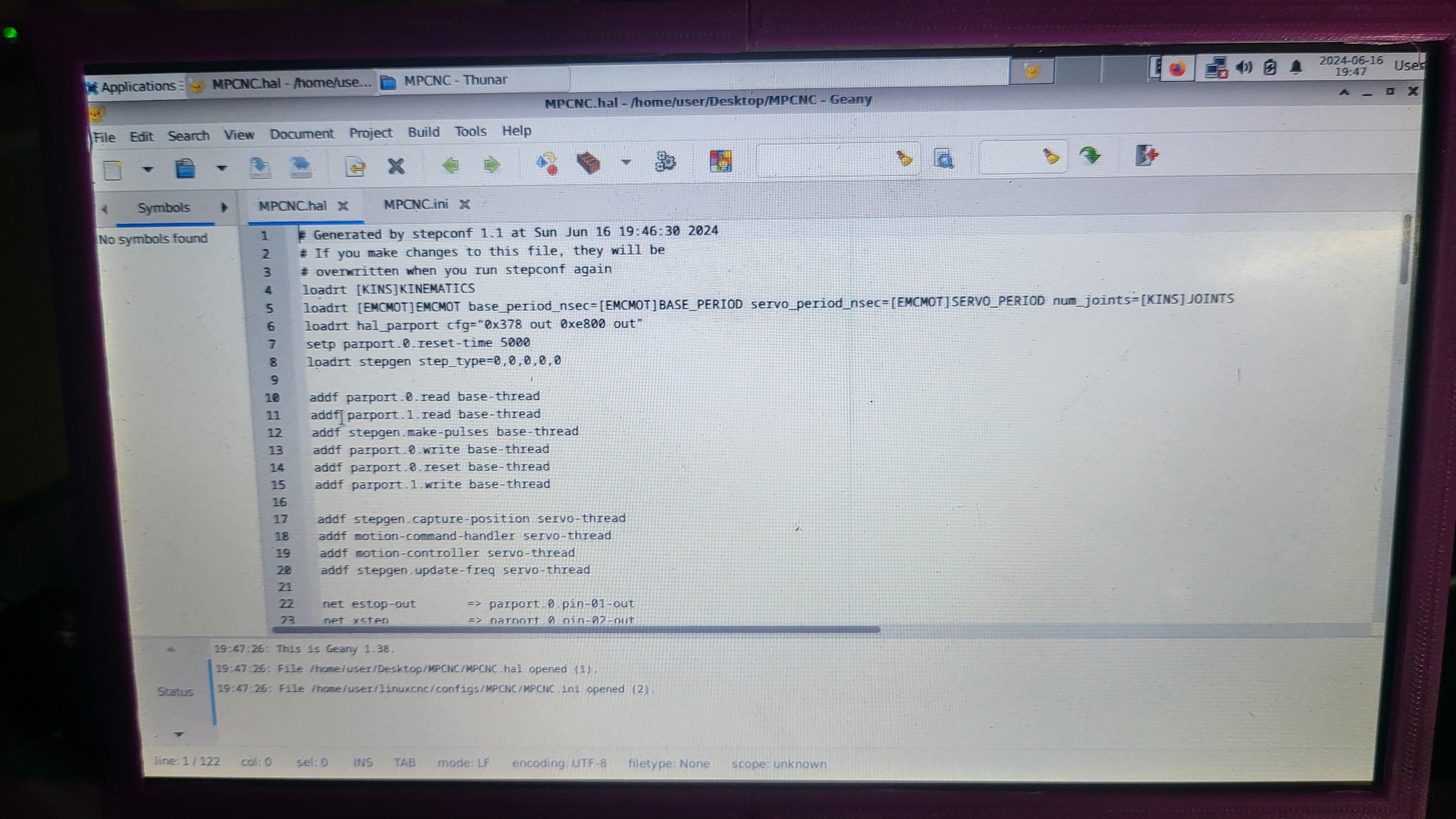

Should be in the format
Further, a more lovingly taken picture of the lspci command would also help...
loadrt hal_parport cfg=”0x378 out 0xe800 out“Further, a more lovingly taken picture of the lspci command would also help...

Also do try just the add on card with
loadrt hal_parport cfg=”0xe800 out“Please Log in or Create an account to join the conversation.

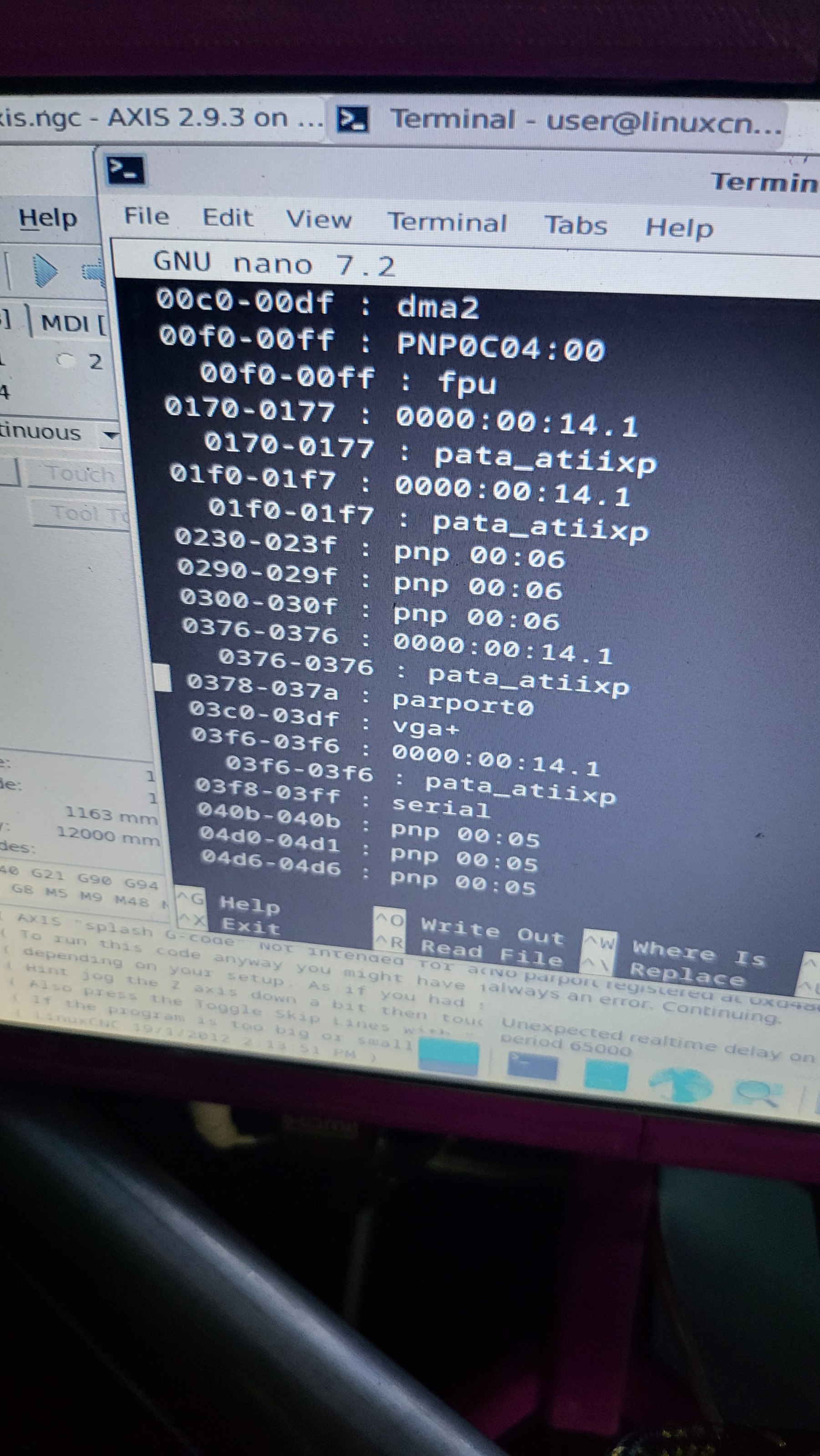

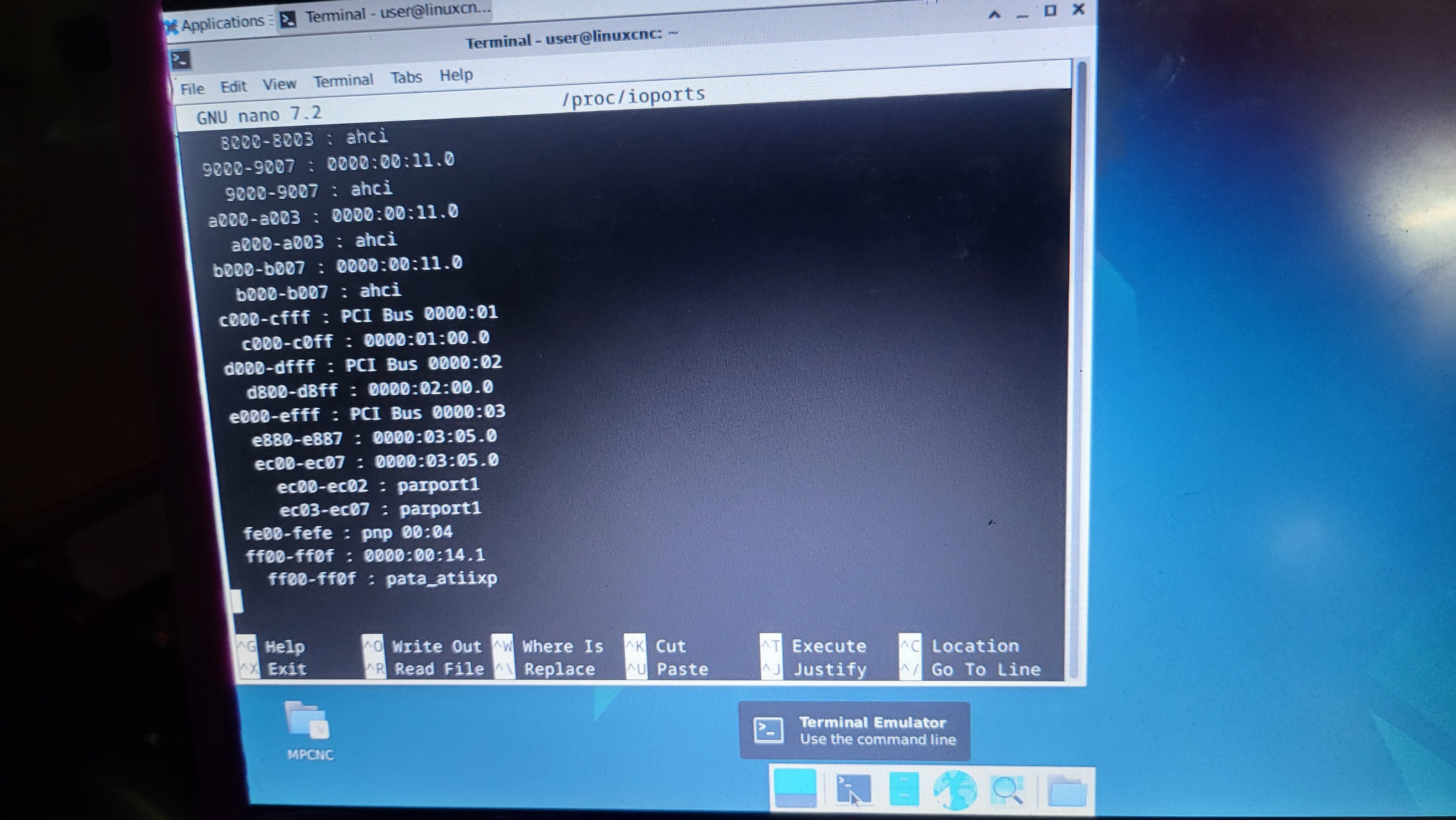

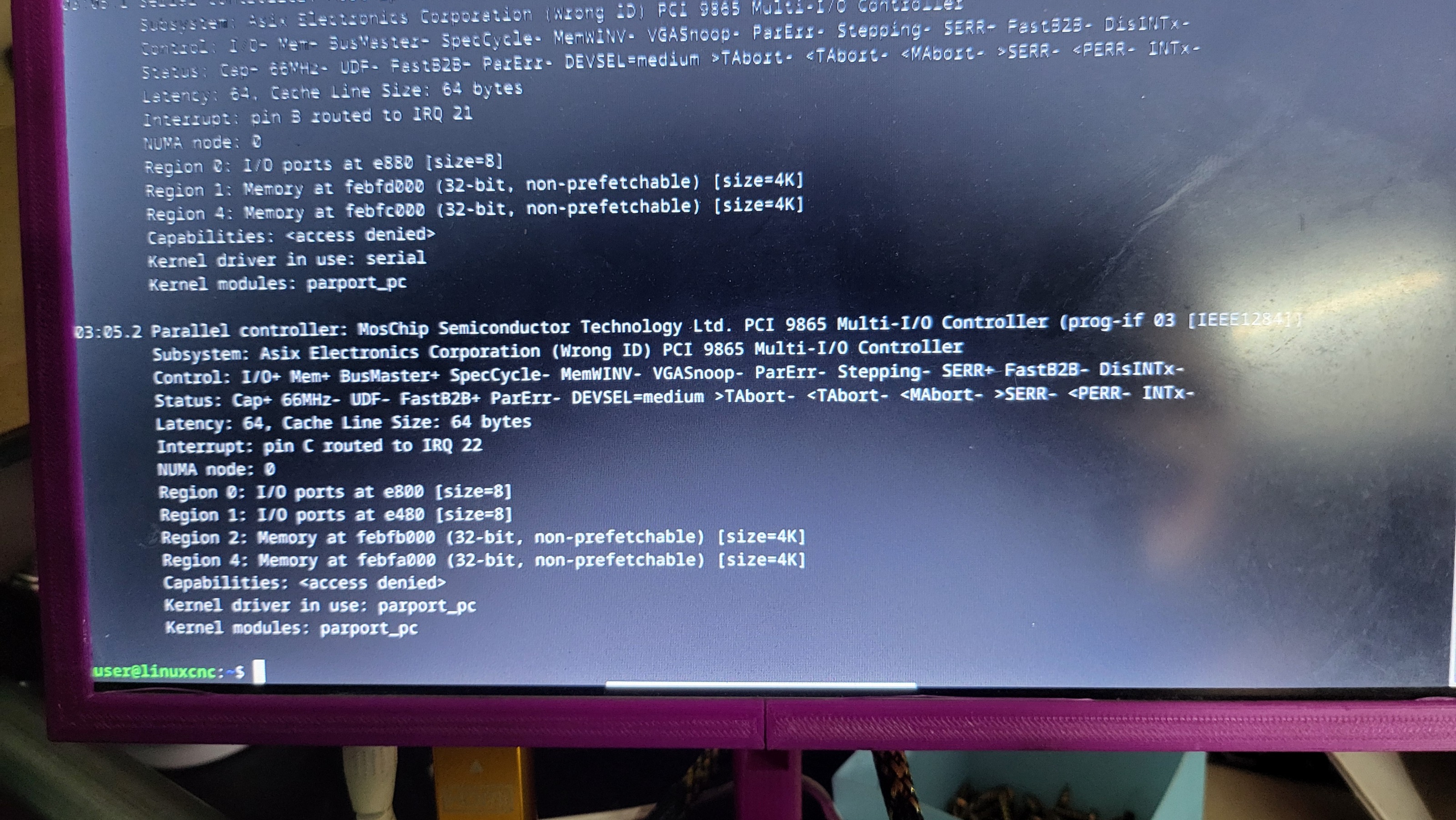

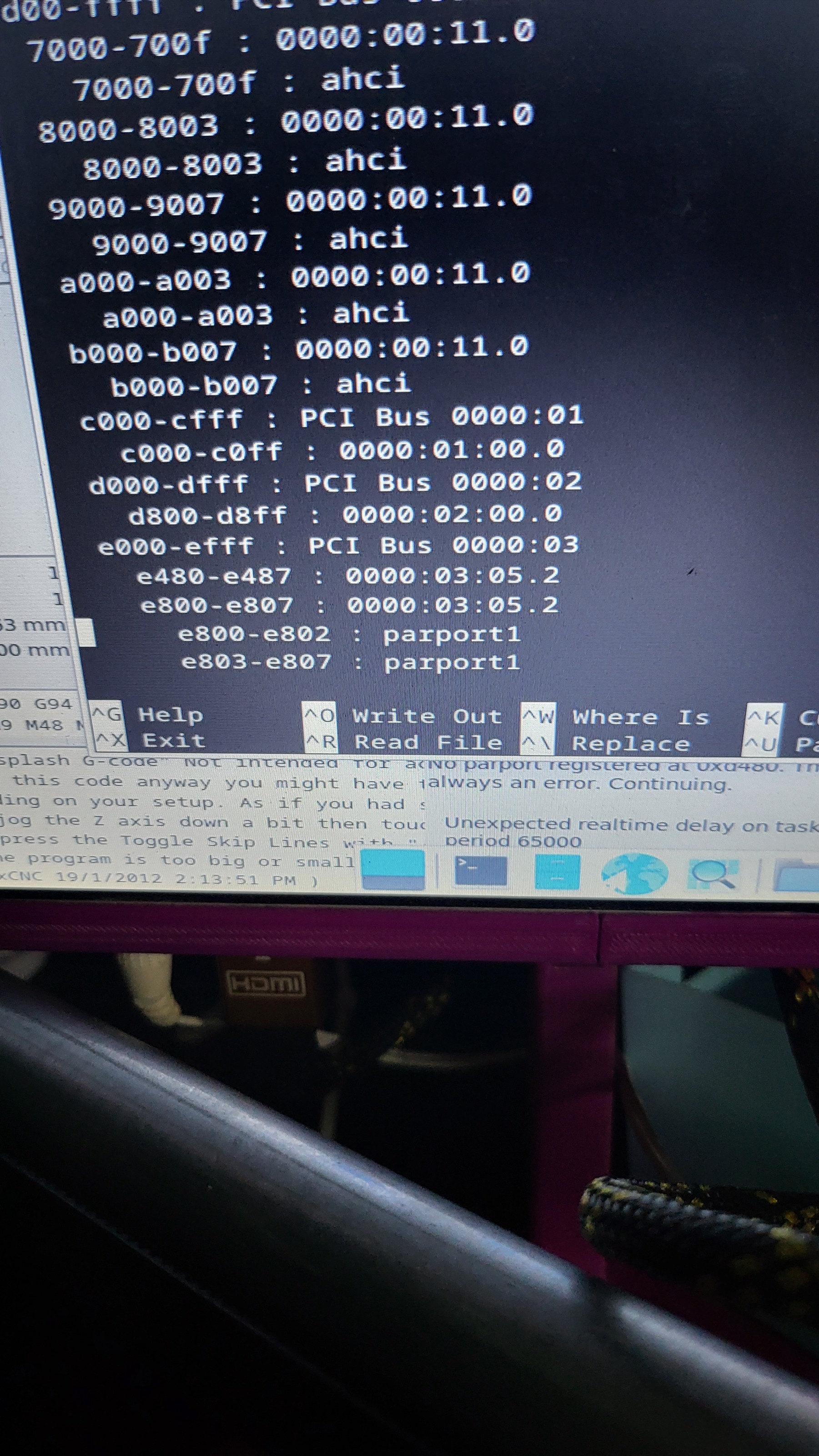

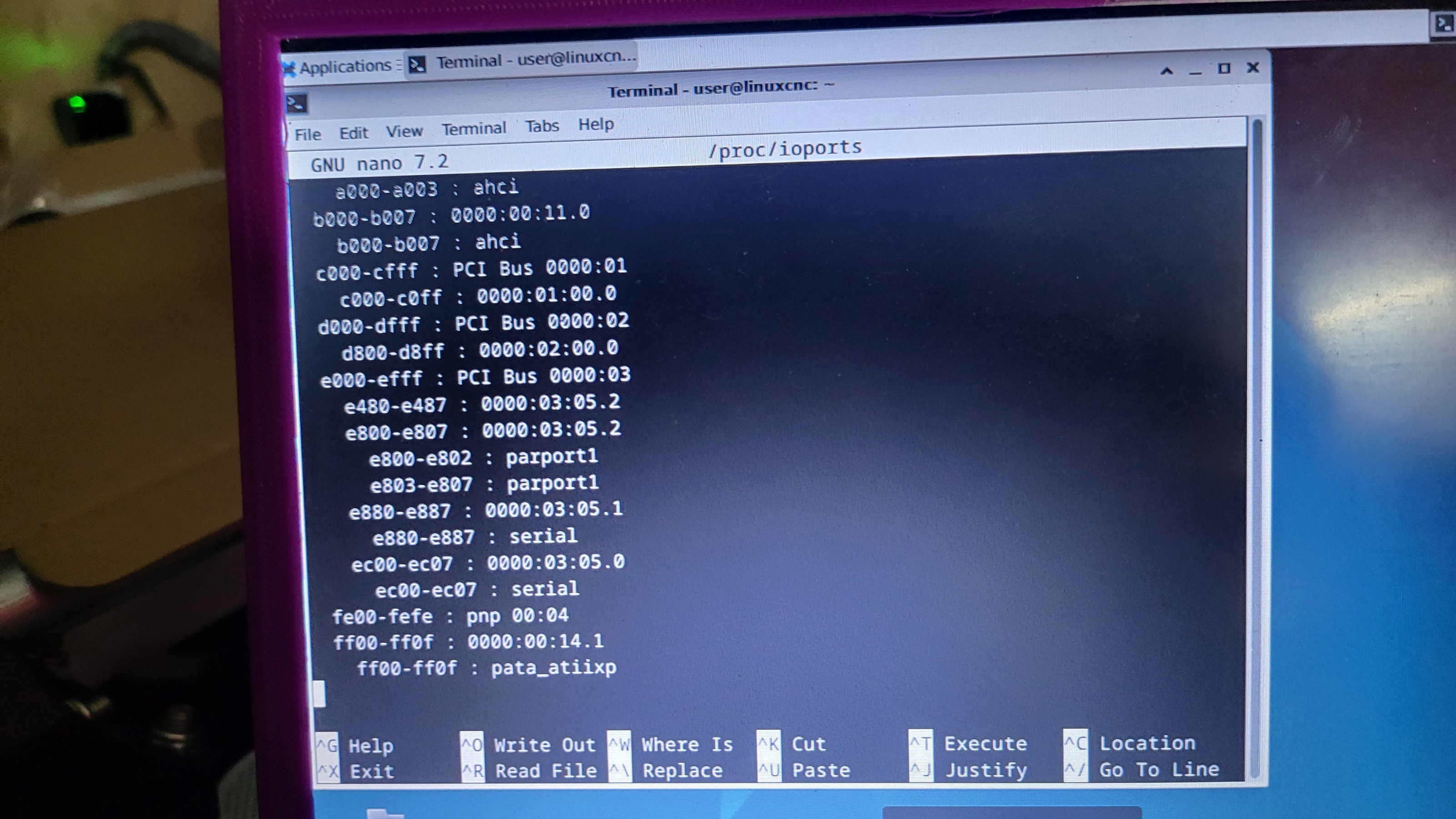

I have taken some better photos of the lspci -vv and /proc/ioports plus a photo of the hal file so you can make sure I am not doing something dumb(this is likely). Sorry has to be photo as machine is not networked and usb ports are hard access currently.

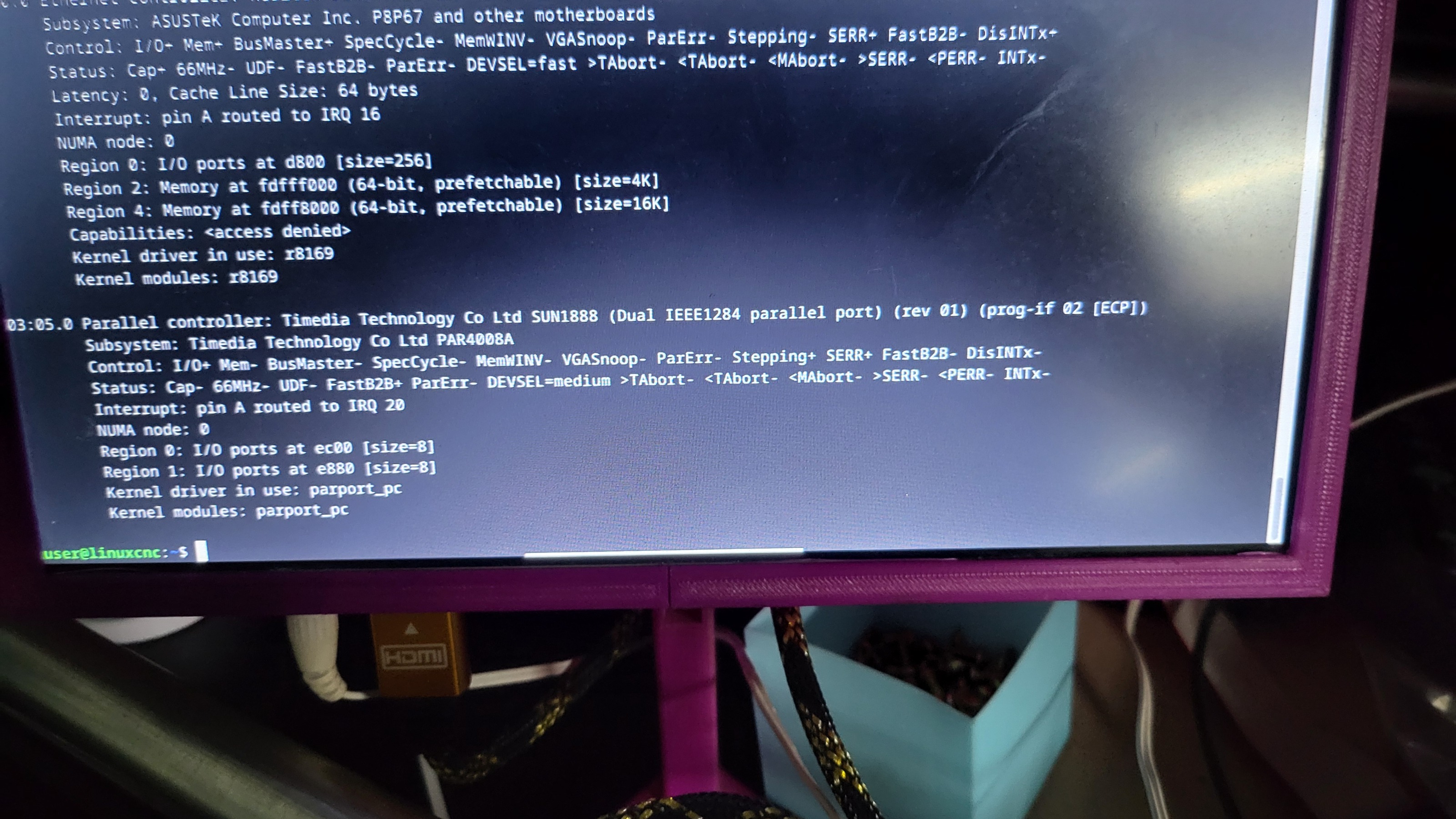

I was able to get the SUN1888 working to the same extent as the Moschip. With the same results no output. So I'm guessing not the card.
The only other thing that may be causing issues is my initial setup was in stepconf wizard using the dual parport setting and then setting the addresses for the parallel ports in there. This seems to create a valid output in the hal of loadrt hal_parport cfg=”0x378 out 0xe800 out“ (when testing with the moschip card)
from my limited understanding of the hal file stepconf seems to setup the hal correctly it definitely works on a single breakout card.
I have attached the photos for the sun1888 card just for your reference.

If you can use for all your card the following command
sudo lspci -vvnn > lspci.txt
sudo dmesg | grep parport > dmesg.txt
sudo ls /proc/ioports > ioports.txt
And as much it is a PITA copy the unedited txt files to a USB drive and attach them to your next post . Screenshots are difficult to work with.
