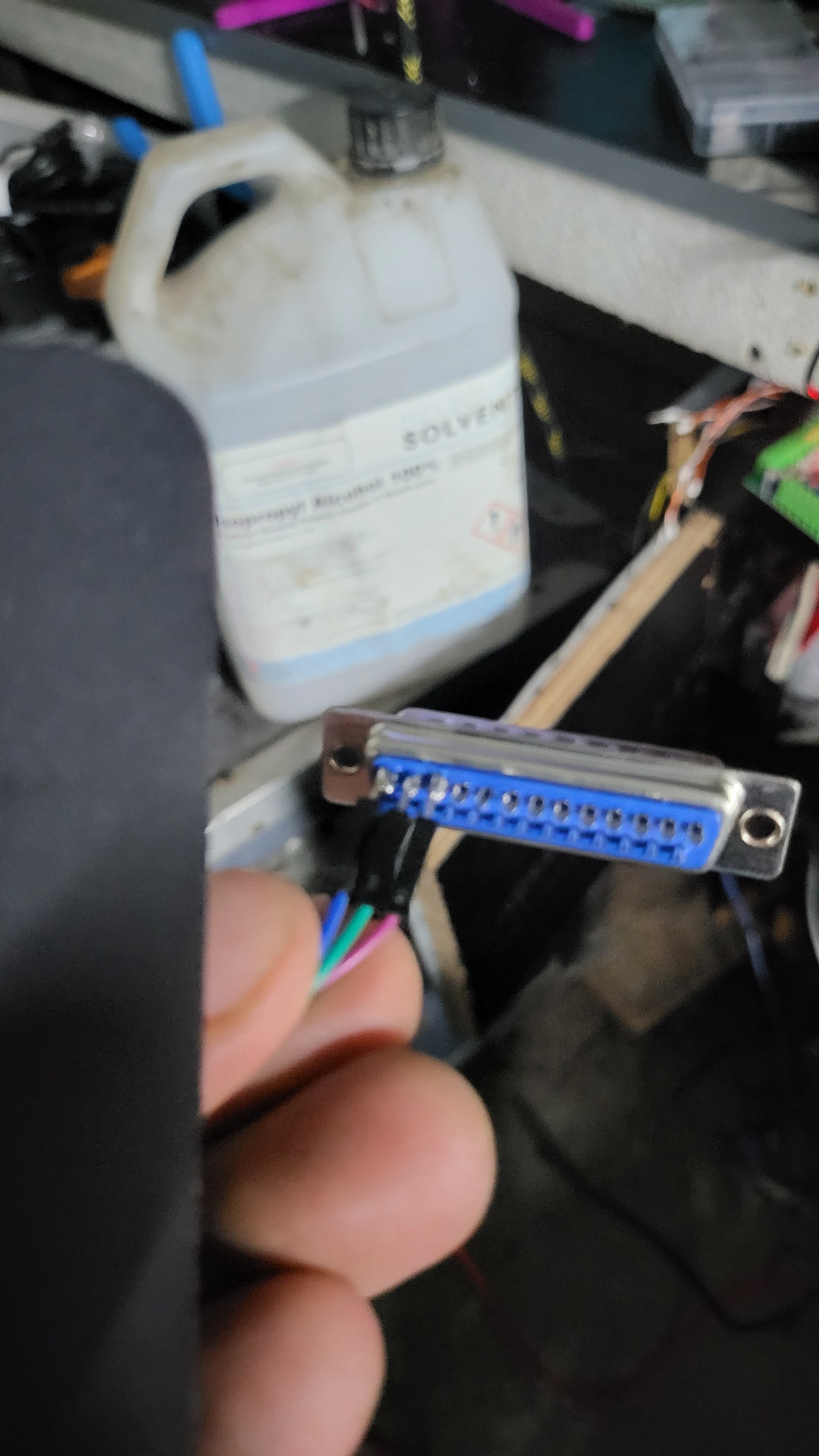

I made up this connected to 13 12 11 directly on the card.
And using the port test app on 0xec00 with the sun1888 installed the ports go to ground when touched to the chassis
this does not happen when the same home made plug is connected at the end of the cable.
Something is screwed up with the cable for sure if it should be straight through
