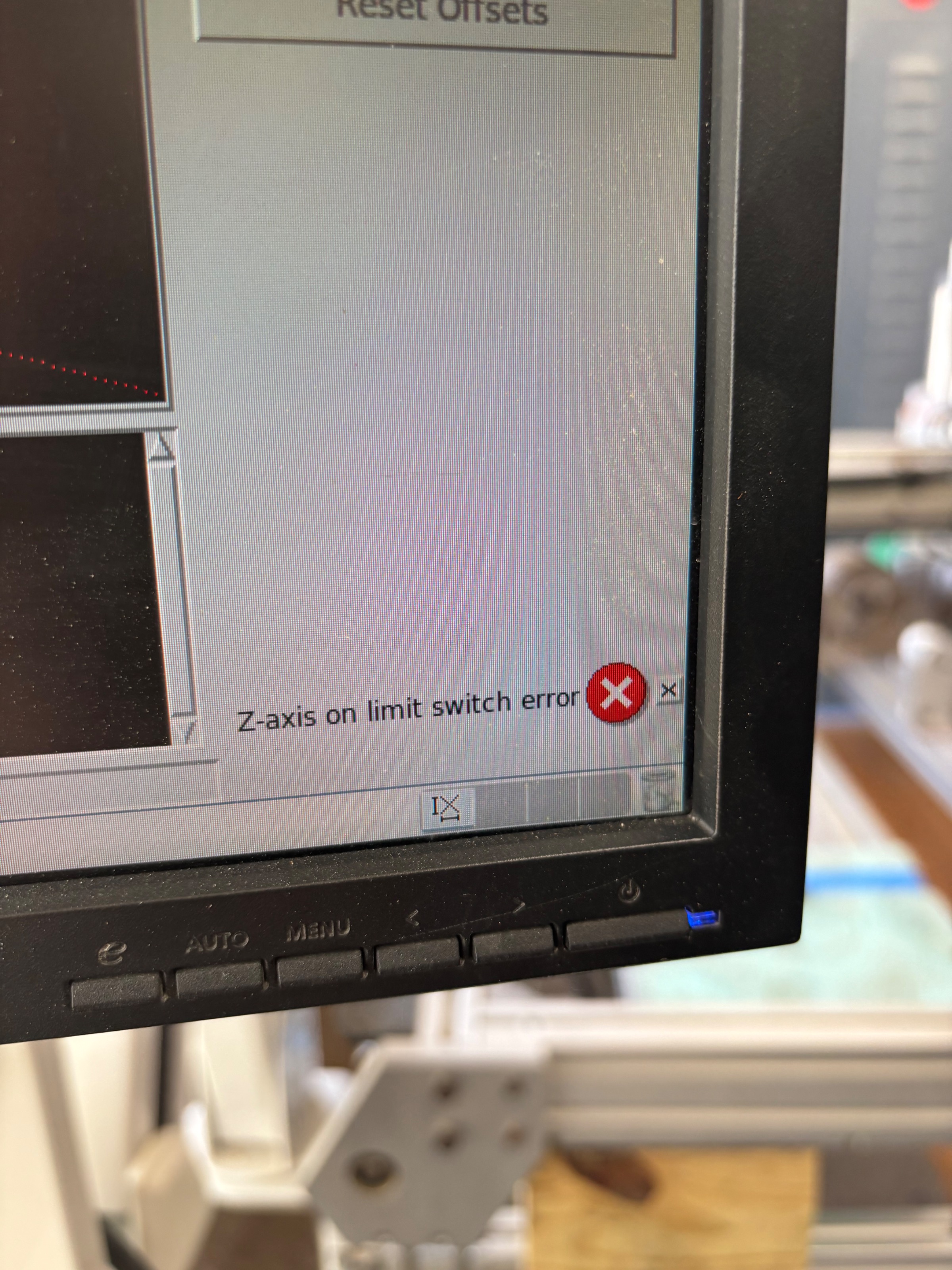

Been getting this error a lot, and again, the machine will not home.
- Posts: 19908
- Thank you received: 4660
06 May 2025 10:15 #327860
Replied by andypugh on topic Need help with Linux 2.5 on a CNC lathe
Is the Z limit switch also a home switch?
halshow (in Axis menu - Machine - Show Hal Configuration) will let you explore whether joint.2.*-lim-sw-in is not working properly.

Move the Z axis by hand towards the spindle a bit, then power on and try homing.
If that does not work, use a DVM to check the wiring from the Z axis switch to parallel port 0 (the built in parallel port in the motherboard, not the add on one)

13 May 2025 06:58 #328370
Sorry for the very late reply to what seems like an urgent issue.
It looks like this is not a conventional lathe?
Also, it seems that the config is doing wierd things to handle gantry homing?
eg
But, if the home-button is greyed out then I suspect that it's nothing to do with all this.
Have you tried clicking the "ignore limits" checkbox?
I wonder if you can home the system through halui to bypass the GUI button (I wouldn't expect so...)
Open a terminal window andand see if anything happens.
You could also try setting "NO_FORCE_HOMING" in the INI file so that you can run the system without homing it, as a workaround. (manually position all axes at home first...)
linuxcnc.org/docs/stable/html/config/ini...tml#sub:ini:sec:traj

net ystep2 <= and2.2.outBut, if the home-button is greyed out then I suspect that it's nothing to do with all this.
halcmd setp halui.home-all 1
halcmd setp halui.home-all 0You could also try setting "NO_FORCE_HOMING" in the INI file so that you can run the system without homing it, as a workaround. (manually position all axes at home first...)
The following user(s) said Thank You: Groovecooper1

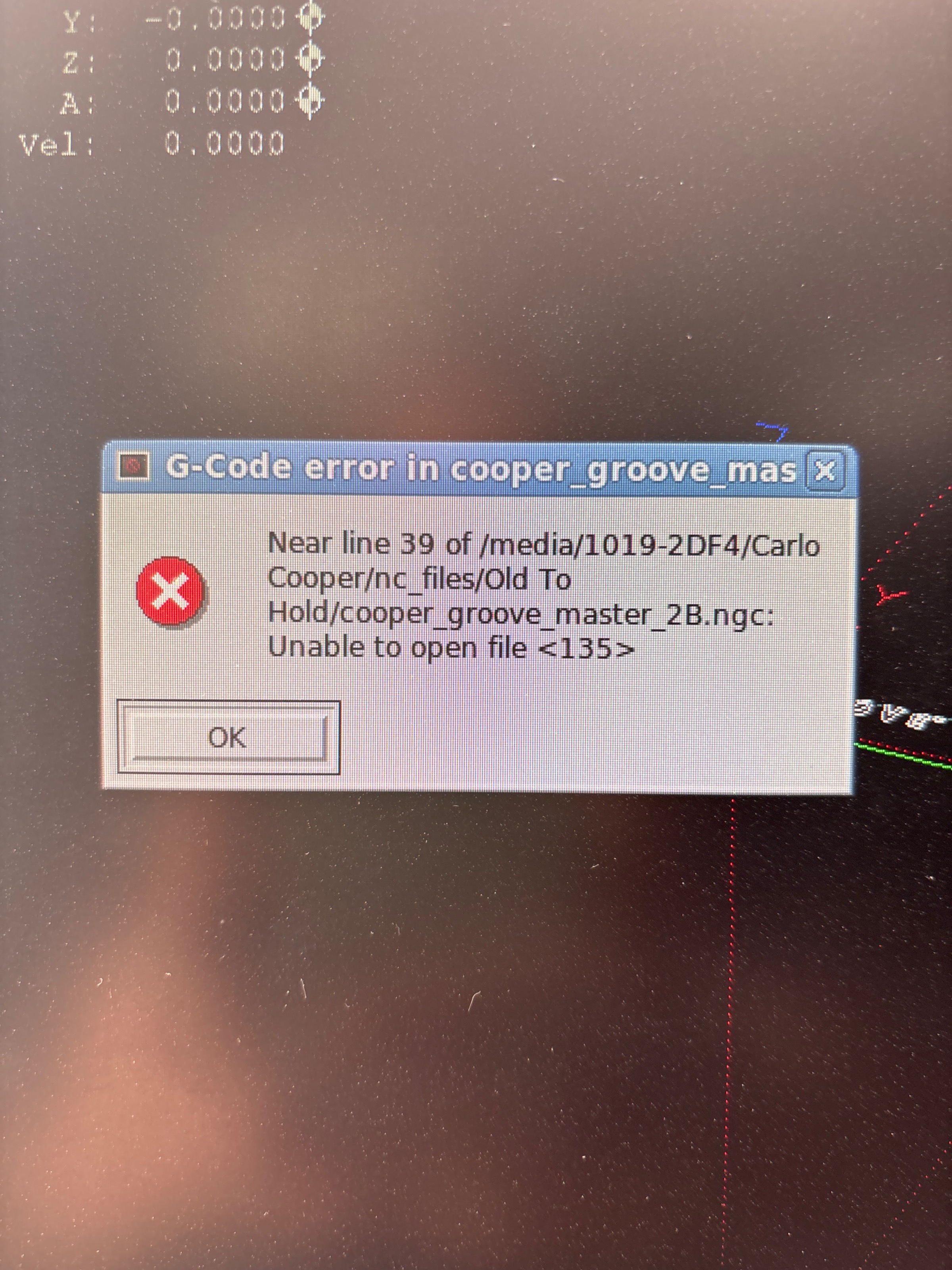

03 Jun 2025 12:19 #329621
by Groovecooper1
Replied by Groovecooper1 on topic Need help with Linux 2.5 on a CNC lathe
Hello got everything up and running the machine will home. I keep getting the same error and I’m not able to run a program. I am not skilled at writing G code, but hopefully this is a quick fix. Any assistance is greatly appreciated
