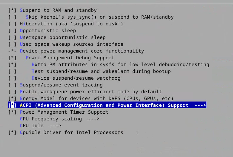

I tried several times even asking for help to solve the latency problems even by changing the video card.
I opened a post here:
forum.linuxcnc.org/38-general-linuxcnc-q...st-ambiguous-results
So I decided to do it my way and not Debian's way.
www.kernel.org/
I have always used Debian but as always this time I will have to compile the kernel by hand, hoping that there are not too many changes since the last time I did it, but I doubt it.
Can anyone please tell me which kernel is best for RT?
Thanks a lot.

1 year 5 months ago - 1 year 5 months ago #328010
by DarkPhoinix
Now i try
in my bios conf i have:
Enhanced Intel SpeedStep Technology: Disabled
Turbo Mode: Disabled
CPU C3 Report: Disabled
CPU C6 Report: Disabled
i need to enable all for change governor?
i have another SSD ready with same version of linuxcnc 2.9.4 i try to install kernel 6.6 for test, make monolithic for first if see error go modular kernel with initrd image with SATA driver in.
Replied by DarkPhoinix on topic Which kernel version is best for real time?
Perhaps try this:
Save your config files somewhere very safe.
Open your PC and remove all unnecessary hardware (except the GPU).
Reinstall LinuxCNC from the official ISO. (The latest version, or perhaps some earlier version).
Set CPU governor to performance.
Run latency test.
See if latency is improved.
Changing the scaling govenor to performance reduced my latency a noticable amount.

1 year 5 months ago #328033
by unknown
Replied by unknown on topic Which kernel version is best for real time?
Yes there are some changes to the 6.x series kernel. A couple of months ago there was a long thread regarding building the newer kernels. You would be best to search for that thread and read it, pay special attention to the posts by royka. His advice was crucial in building the RPi5 & RPi4 for the Linuxcnc images.
You have to make sure that you select the proper RT kernel in the config.
Some kernel require a patch so that Linuxcnc recognises that there is a RT kernel running.
The kernel provided with the 2.9.5 iso works, is stable and is in use by many users with no issues.

1 year 5 months ago #328054
by unknown
Sorry I meant 2.9.4
Try not to get bogged down with latency.
Test the machine running code, if it works don't worry too much about it.
I took the gcode file that loads when you first start Axis, made it into a loop, loops thru the gcode about a hundred times,if I don't get any errors I'm confident it will be fine.
I really don't think there will be much difference between a modular or monolithic kernel.
You can gain a bit by fiddling with mount options, looking for any background services that aren't needed, I generally disable sound and I'll disable wifi if it's not required.
You'll find this forum a lot different to cnczone, for one no one on here gets caught playing my rapids are this fast, also you won't here anyone saying that you need to be a programmer to use Linuxcnc. It works and works well.
Almost any issues you have will have been discussed many many ten times over.
99.99% of the reason Linuxcnc won't start is a typo somewhere in the hal & ini files.
Sometimes I think that running the latest kernel on older CPUs isn't the best course of action. Far better to have some extra latency and a stable system.
Look you can spend a lot of time building different kernels and trying all the tricks in the book to lower latency, but as long as latency is, as a rule thumb, below 100,000 ns for an external step/direction generator you're good to go.
Then again network latency can be a PITA to sort sometimes.
