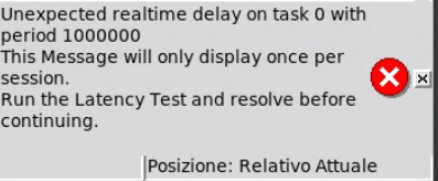

I did a new test 100 windows of glxgears and CPU stresstest active the PC is no longer responsive even the linuxcnc window but the servo continues to go and finishes the job. I don't understand why YouTube goes into error! I must say that today the drivers arrived and the new servos do not make a minimum of noise but I have to check them in the car better.

I did it and the situation gets worse! if I only move the linucnc window the steppers make absurd noises and change the speed of movement, they are not yet on the machine they are free.. I don't dare to think what they could do at work!
do you mean this SERVO_PERIOD = 1000000 ?
I set it to 35000000. in the video with glxgear it is again at 1000000.

Do you get latency warnings when you run LinuxCNC?
Are you still using the same PC discussed here on several topics?
Why do you keep doing the same things and expect different results? Stressing the system beyond it's limits will always fail.
Change the graphic card, get a used one for AMD, or get a used PC.
You had good latency at one point in time, so what happened?
LinuxCNC, one youtube video, no whatever stress test you run, nothing, if that works OK, move on to making chips.

10 May 2025 14:42 #328175 by PCW
Do you have a Ethernet connected motion device?
If so, the latency test is relatively useless for determining the actual
LinuxCNC latency.
A simple ping test is much more informative:
sudo chrt 99 ping -i .001 -q -c 60000 [Device_IP]
(will run 1 minute and print out timing statistics)
Where device _IP is the IP address of your Ethernet motion control interface.
The following user(s) said Thank You: rodw, DarkPhoinix

Yes, at start
Yes i change NVIDIA with ATI and is better, but error of junction with "Community test youtube video" still occurs.
www.youtube.com/shorts/mWCeSrF2TUM
Whith stress test and 100 GLXGEARS the work go at end with machine not responsive! But one youtube video give me junction error.
Yes is good youtube video junction error still occurs.

12 May 2025 11:50 #328289 by PCW
Yes PCW, is the same Realtek with dkms driver for fix latency.
Maybe I'm asking the wrong question: is it really necessary to do the test with YouTube?
When you get an error, what does:
halcmd show param *.tmax
(typed in a terminal)
show?

next youtube video start i take junction error.
