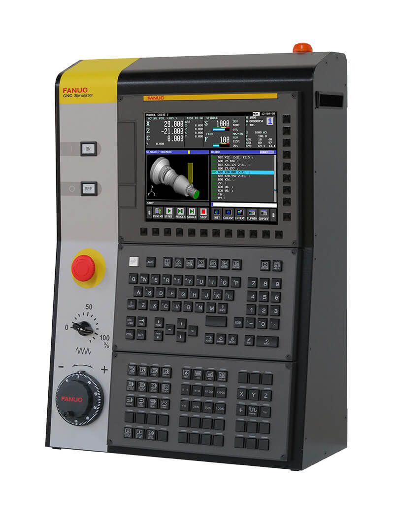

Here is my current attempt to have a fanuc like gui
github.com/cakeslob/regularmac_800
I dont have all the controls mapped to the Tab/arrow keys yet, or a softkey menu
- Not everything needs to be on the screen at the same time.
- I dont think people have a problem with graphics, most stuff is crude text shortforms.
- It uses a combo of hard keys for each menu -(some multi press buttons, ie press offset for tool, press offset again for work offset) and soft keys that change with each menu
- you can load/setup/run the program with like 5 buttons(some soft) + arrow keys
- some modes (ie edit/MDI/Jog/pendant/auto) disable other features , so you cant run a program from edit mode, you can edit a program in MDI mode, you cant jog in auto, etc
-the whole gui is bacically controlled by pg up/down, arrow keys, and function keys
- monitor aspect is usually 1:1 square, but thats uncommon in consumer stuff, so 4:3 is closest
- no axis movement until start button. so any probe routines or toolsets, you need to press cycle start.
I have tested out every gui to find the most similar one. All the GUI could be made to be like fanuc style, The cloest ones to fanuc style workflow were keystick and mini, but its been a long time since I was able to use those so maybe its nostalgia. Qtdragon or the smaller one could be made to work like fanuc style with not to much changes, but it would be more python backend behavior for keyboard behavior/navigation (no mouse needed), and softkey stuff than actual GUI organization, the layout of the small one (woodpecker?) is pretty close to what fanuc stuff looks like .

My preferences are very similar to @cakeslob's post. I think Gmoccapy is the closest current GUI available, although there are quite a few changes I'd make if I were handed a magic wand.What would be a short list of requirements for an industrial screen?
No axis movement without START button?
No graphics?
Mostly text styles or more modern graphical elements?
Multi function soft keys? Hardware only keys.
What target monitor size?
Etc.
- General Layout
- 4:3 or 1:1, although it looks like I have to walk back my previous statement about commercial controls never using 16:9. Siemens, Fanuc, Okuma and others appear to have 16:9 options on their latest controls.
- General concepts/restrictions
- No on-screen controls can cause movement or spindle activation
- This includes probing and tool-change functions
- No axis movement (besides jogging & homing) unless cycle start is pressed.
- i.e. for MDI you have to enter the command and then press cycle start
- Icons/cartoons for function keys optional
- Ideally, a GUI config page would be accessible where each softkey button could be named or have an icon assigned by the user.
- Default to text in the desired language.
- Navigation
- Option 1 - softkeys on bottom & side
- Option 2 - softkeys on bottom, and external hardware buttons or selector switch for different screens/modes (i.e. 840d)
- Option 3 - Haas arrow/page navigation
- Main screen
- No backplot/preview
- Large DRO - gmoccapy's DRO is excellent, although the "R/D" in lathe mode is annoying
- User selects which axes are displayed, and gets to pick one of two 'sizes' to save some space.
- Large G-code window
- User-selectable font and size within window
- No editing g-code inside main run screen
- Spindle & override windows
- No on-screen sliders/buttons. All adjustments made via external hardware.
- No temperature bar for override % - a number is sufficient but a blinking/highlighted function is nice if not at 100%
- Small temp bar for spindle load
- Room enough for multiple spindles
- Jogging
- External hardware only
- Disabled unless jogging 'mode' is selected (i.e. as @cakeslob described)
- Auto
- No run/stop or other motion via softkeys.
- Part counter
- Remaining time (estimate, of course) window/display
- Tool page
- User settings page with checkboxes for which columns are displayed. No digging in a yaml file needed.
- User settings page has 'tool changer installed' checkbox along with number of slots
- If selected, top of page has non-graphical array of the slot numbers plus spindle position, and empty boxes next to them which are automatically updated when a tool change is performed.
- Although the Probe Basic graphics are impressive, I think they're unnecessary. But a simplified display of what's in the tool changer or turret would be helpful.
- Parameters page
- I'd like to see a page with realtime (or nearly) display of all parameters, at least the numbered ones. I really miss this one in LCNC.
