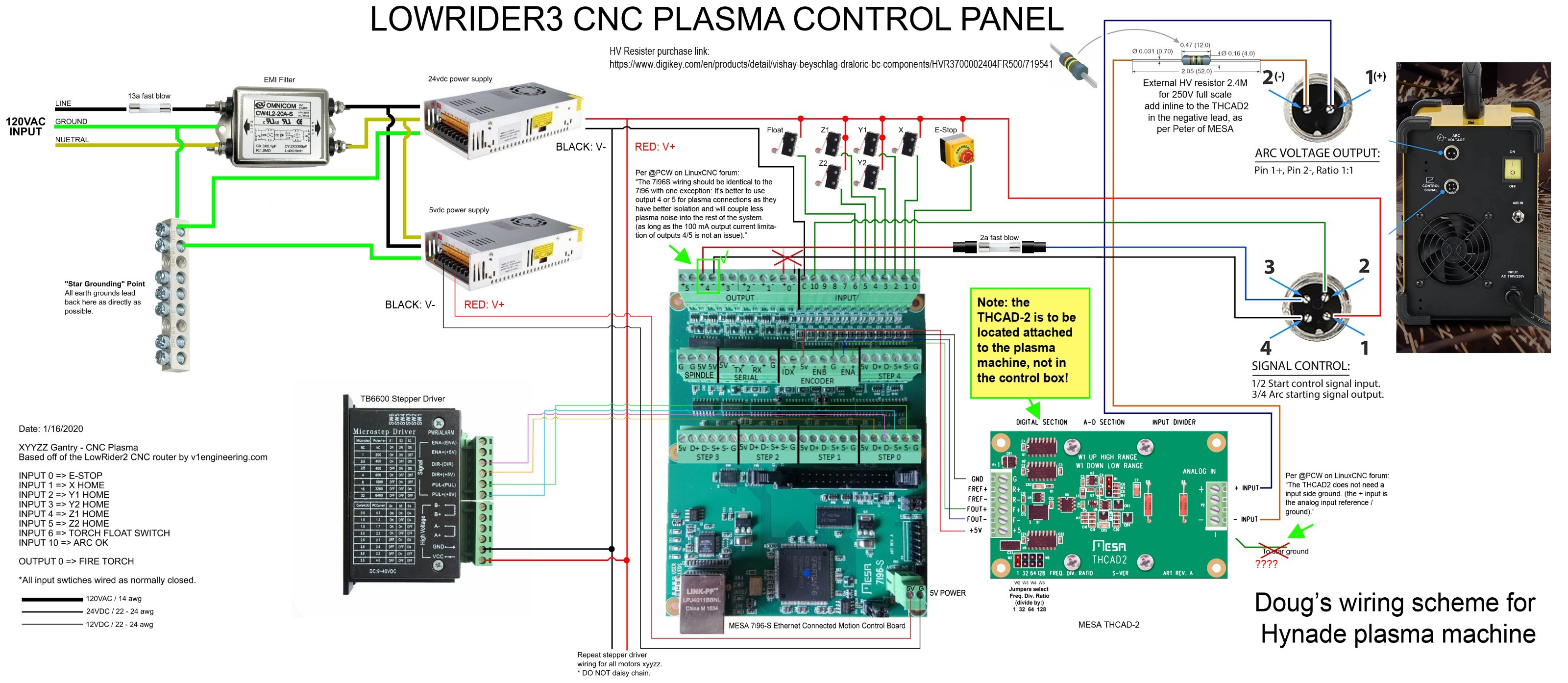

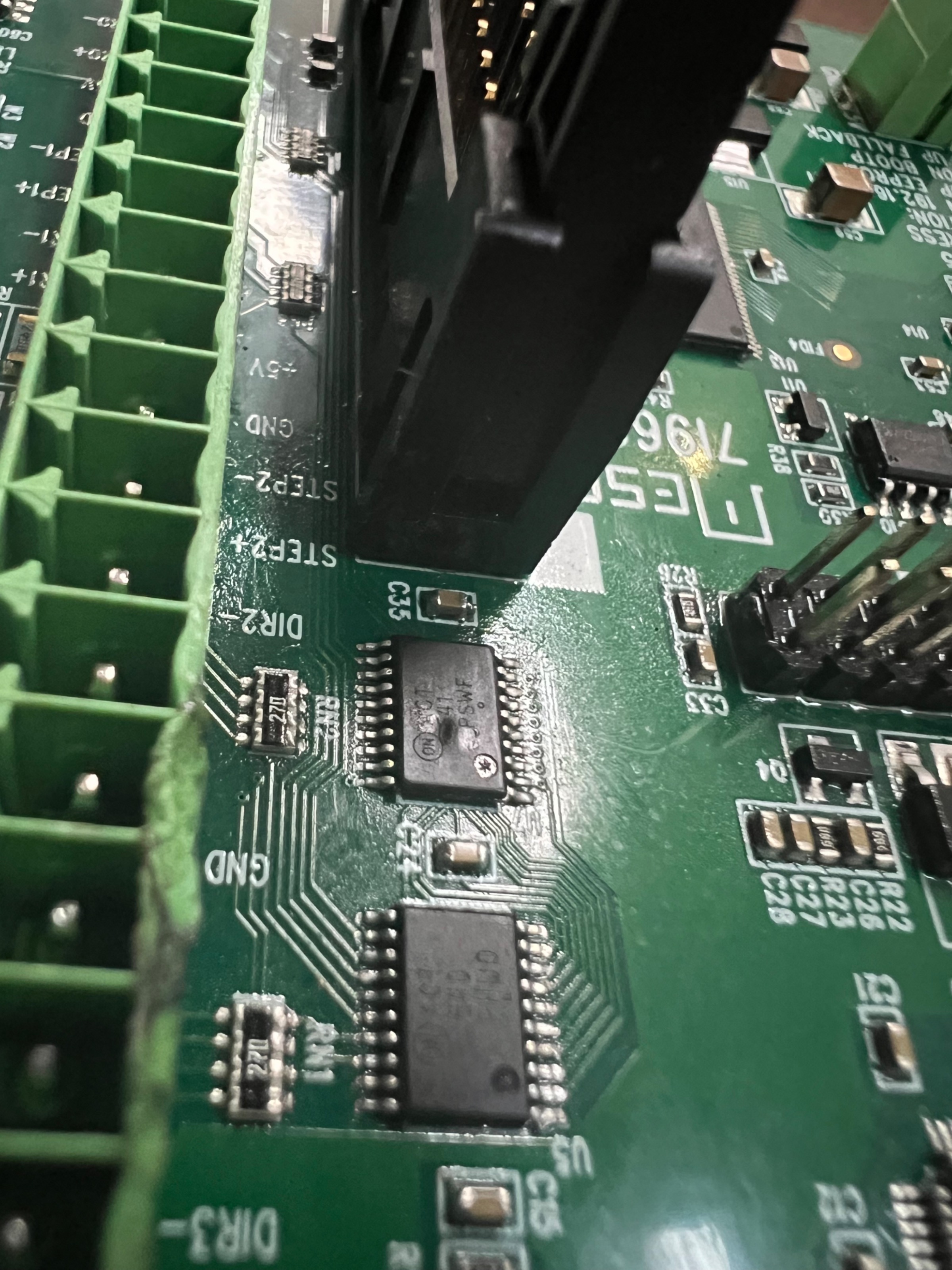

Looks like a maybe a major EMI or grounding issue.
Your odd voltmeter reading also suggests this.
Are the step/dir drives near the 7I96S?
How are step/dir wired to the drives? (single ended or differential)

My guess is that there siginificant coupling of the plasma start transient into the step/dir wires
or perhaps a grounding issue.
If you use single ended connections, the step/dir wiring will be less susceptible to
damage from external RFI/EMI. Another option is to use shielded wiring for step/dir
(with the shield connected to GND only at the 7I96S end)

Tengo cables blindados en todos los cables (motores, encoder, interruptores de limite) y están conectados a tierra solo en el lado de los controles. También tengo cables blindados entre los drivers y la tarjeta mesa 7i96s (no se si son necesarios ya que están dentro de una caja metalica)
Y ahora ya estoy dudándolo creía que la conexión diferencial era menos susceptible a EMI (me podrías decir como lo tengo conectado como en el diagrama que te envié) y si lo tengo conectado de manera equivocada cual es la correcta. No se como es la conexión en single ended.

Differential signaling is more resistant to EMI generating false step/dir signals
but where there is enough EMI to actually damage components, a single ended
connection is more resistant to damage since common mode EMI (applied to both
+ and - signals) is mostly eliminated.
Single ended connections would be:
7I96S GND DRIVE PUL-, DIR-
7I96S STEP+ DRIVE PUL+
7I96S DIR+ DRIVE DIR+
