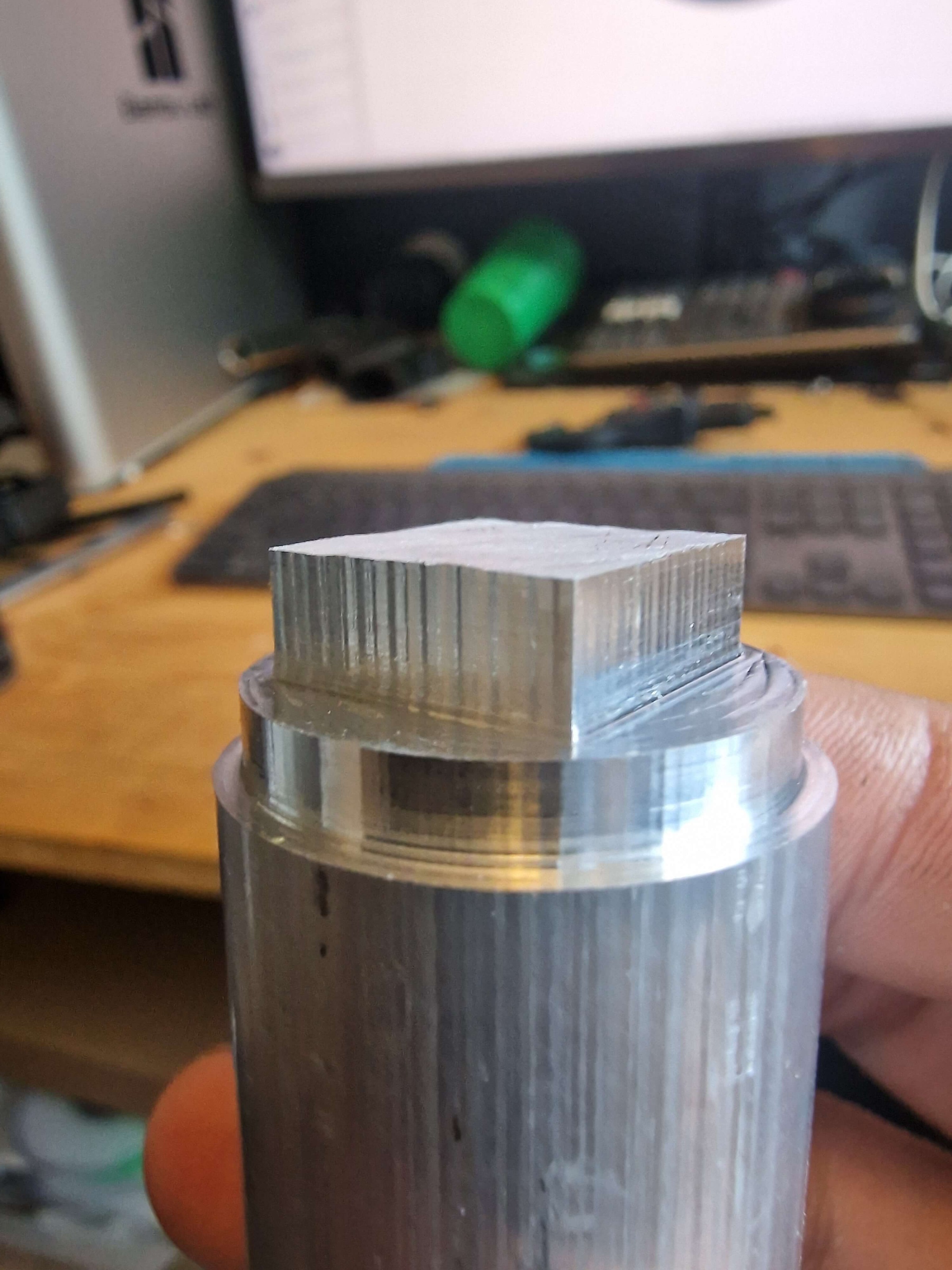

poor surface quality
- Sternfox
- Posts: 41
- Thank you received: 7
09 Jul 2025 17:11 #331599
by Sternfox
Replied by Sternfox on topic poor surface quality
That's correct. I'm going to try to adjust the gain settings and see if I can get this tighter. Any suggestions what settings to look for? Many thanks
- Posts: 18122
- Thank you received: 5337
09 Jul 2025 18:15 #331603
Replied by PCW on topic poor surface quality
Probably need the drive manual for that...
If it's like a classic motor drive, there will be three nested PID loops:
1. Torque (current) command/feedback --> torque (current) out
2. Velocity command/feedback --> torque out
3. Position command/feedback --> velocity out
Is there any tuning program available for the drive?

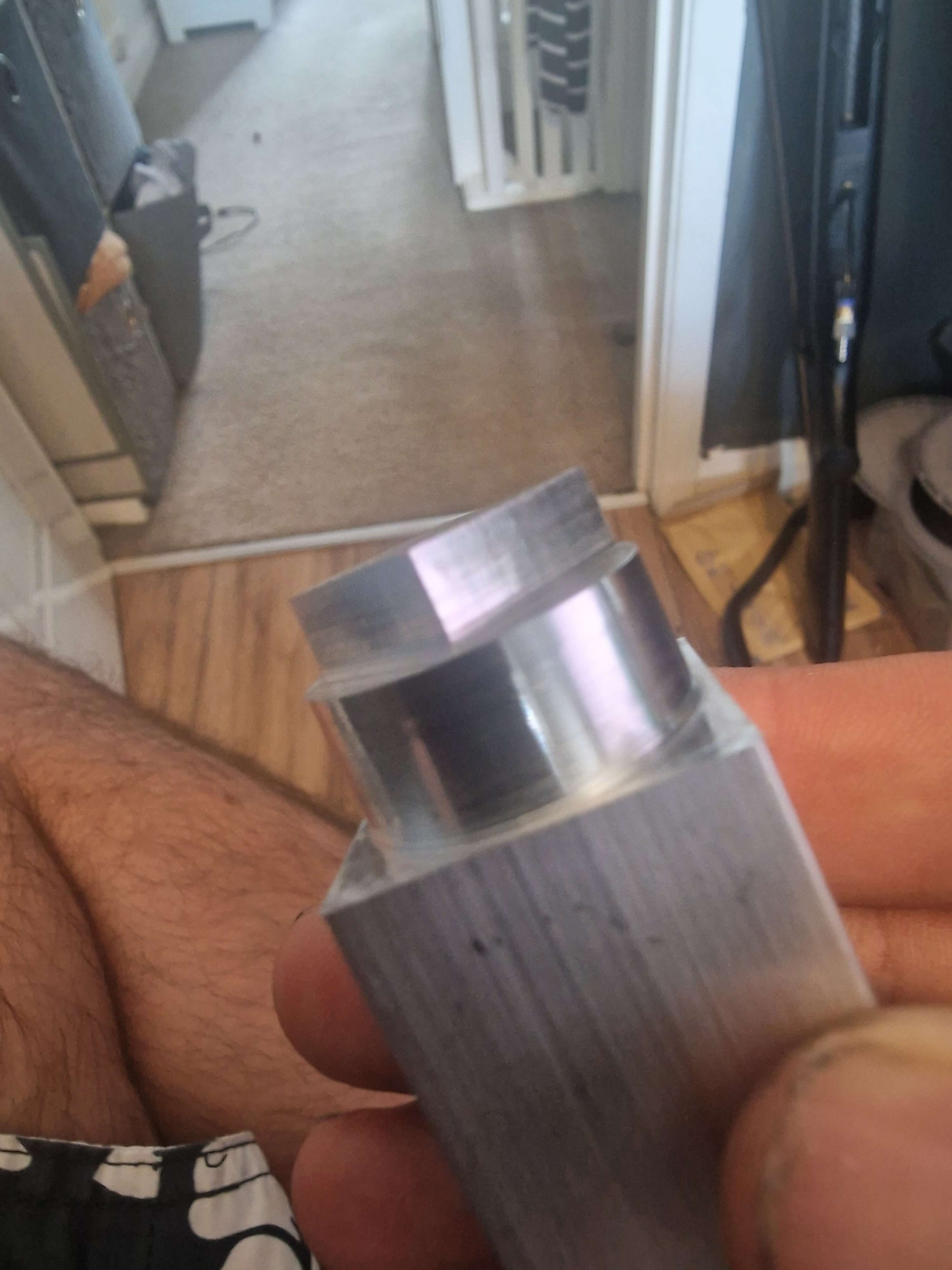

- Sternfox
- Posts: 41
14 Jul 2025 09:29 #331816
by Sternfox
- Posts: 22043
- Thank you received: 7506
14 Jul 2025 09:44 #331817
Replied by tommylight on topic poor surface quality
That looks nice now!
