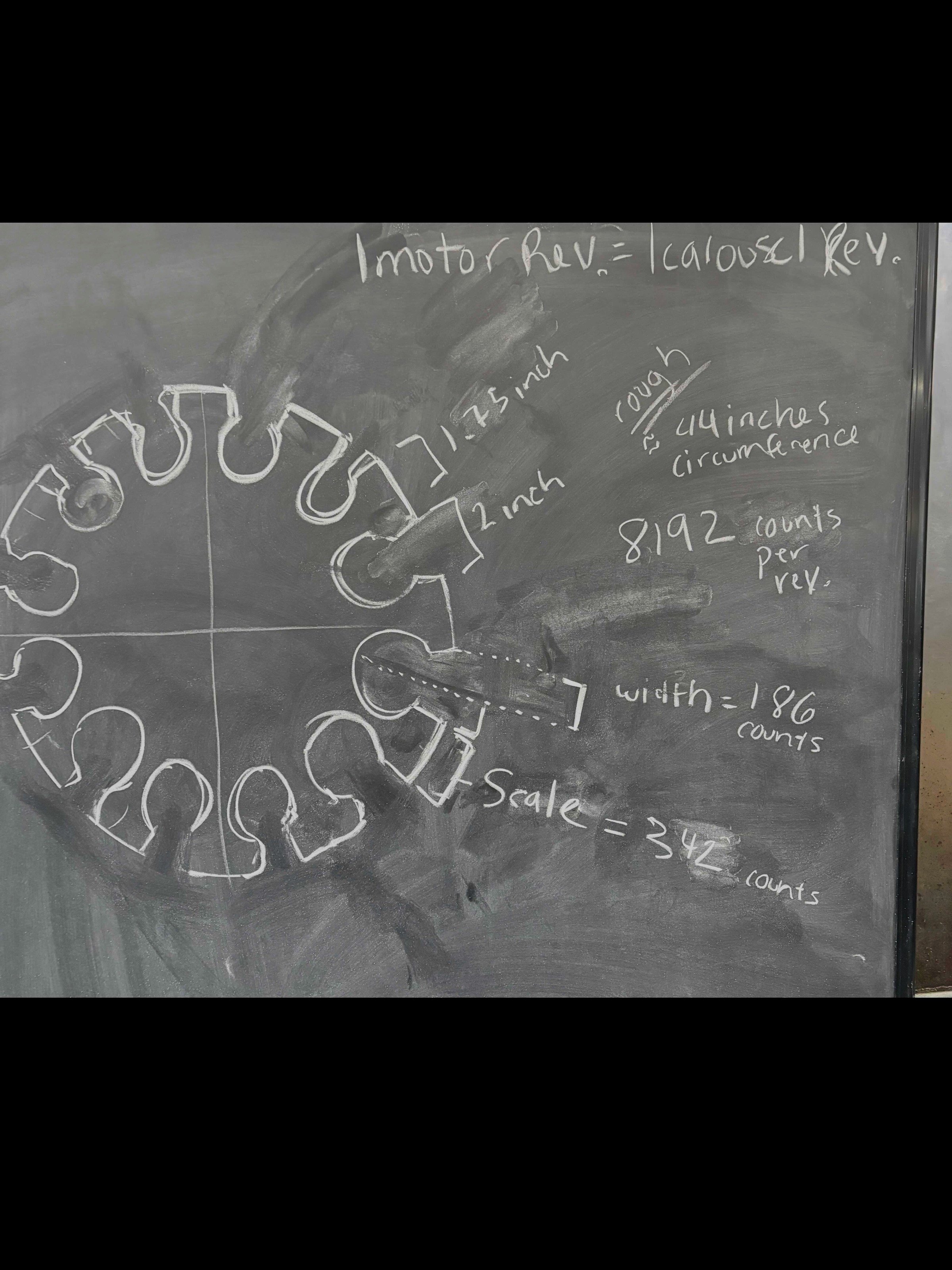

I think I understand the width and scale now, I have illustrated my understanding in the pictures attached. If you could confirm that those measurements are the correct ones for the width and scale parameters that would be amazing.
Our problem is the understanding of how the carousel component integrates with the hardware, for example how come some people leave pins or parameters out. And what is carousel-lock and unlock and how does it relate to the component.

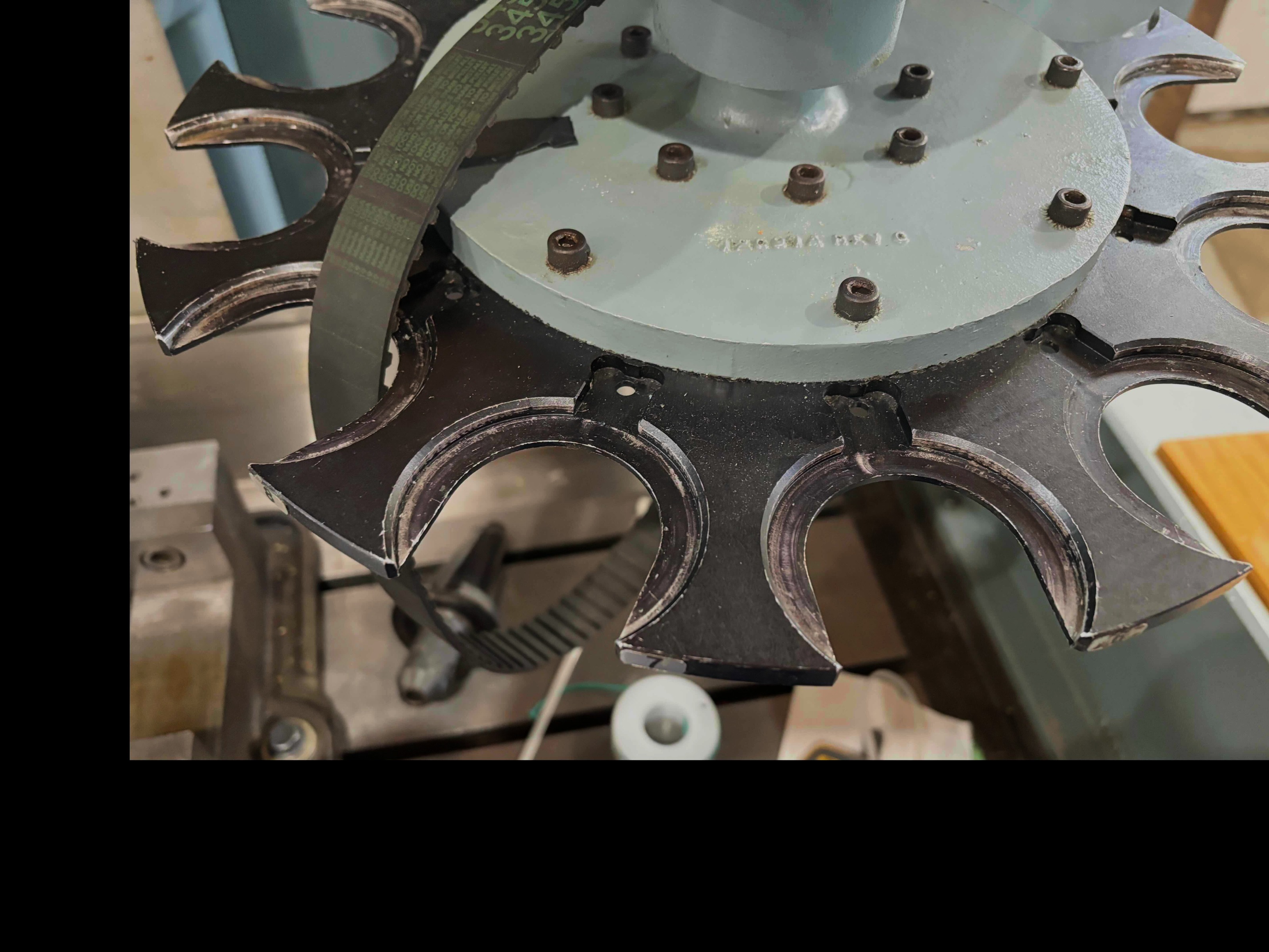

Also my illustration was fast it is not to scale unfortunately, so I included a photo of the actual carousel.

I think that carousel.scale needs to be 8192/12 = 682.666666666 (which is unfortunate, as there is a possibility of rounding errors.
The "width" is how many counts you can be away from the target and still consider the carousel to be aligned. On reflection I might have been able to think of a better name for it. But it corresponds to the "width" of the typical flag or proximity sensor used to detect carousel alignment.
Carousel can be configured in many different ways, and some setups simply don't require certain inputs and outputs.
