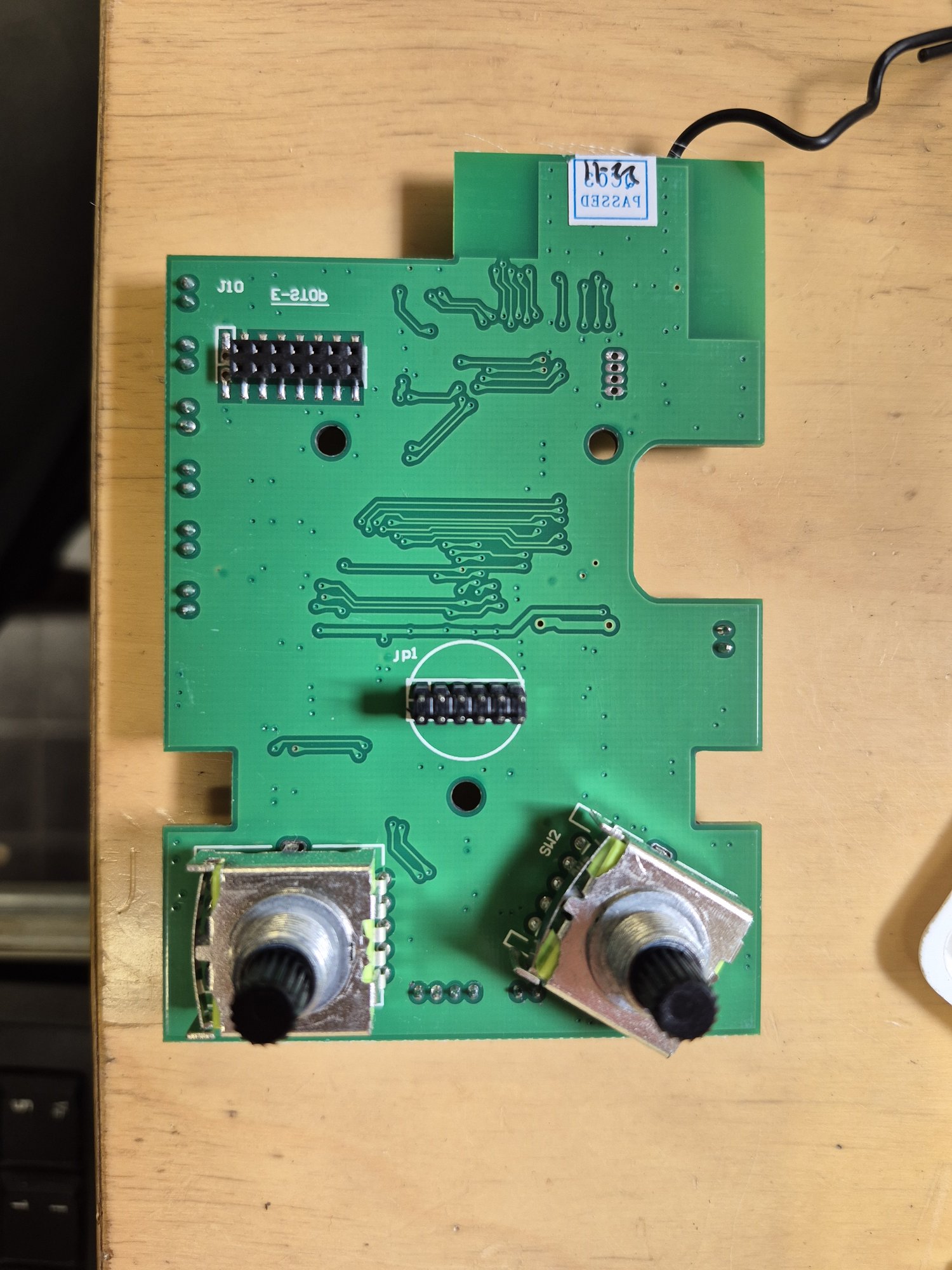

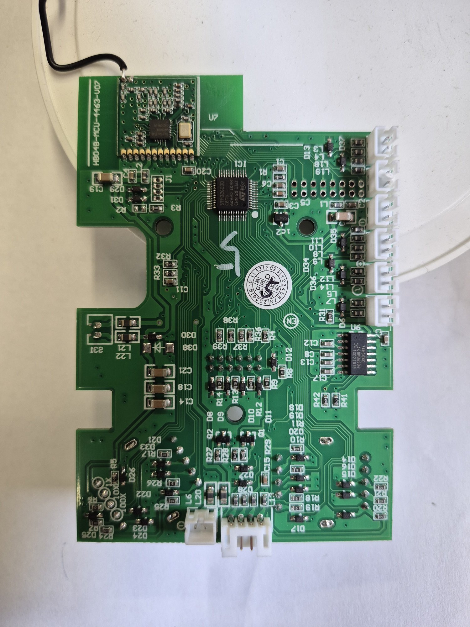

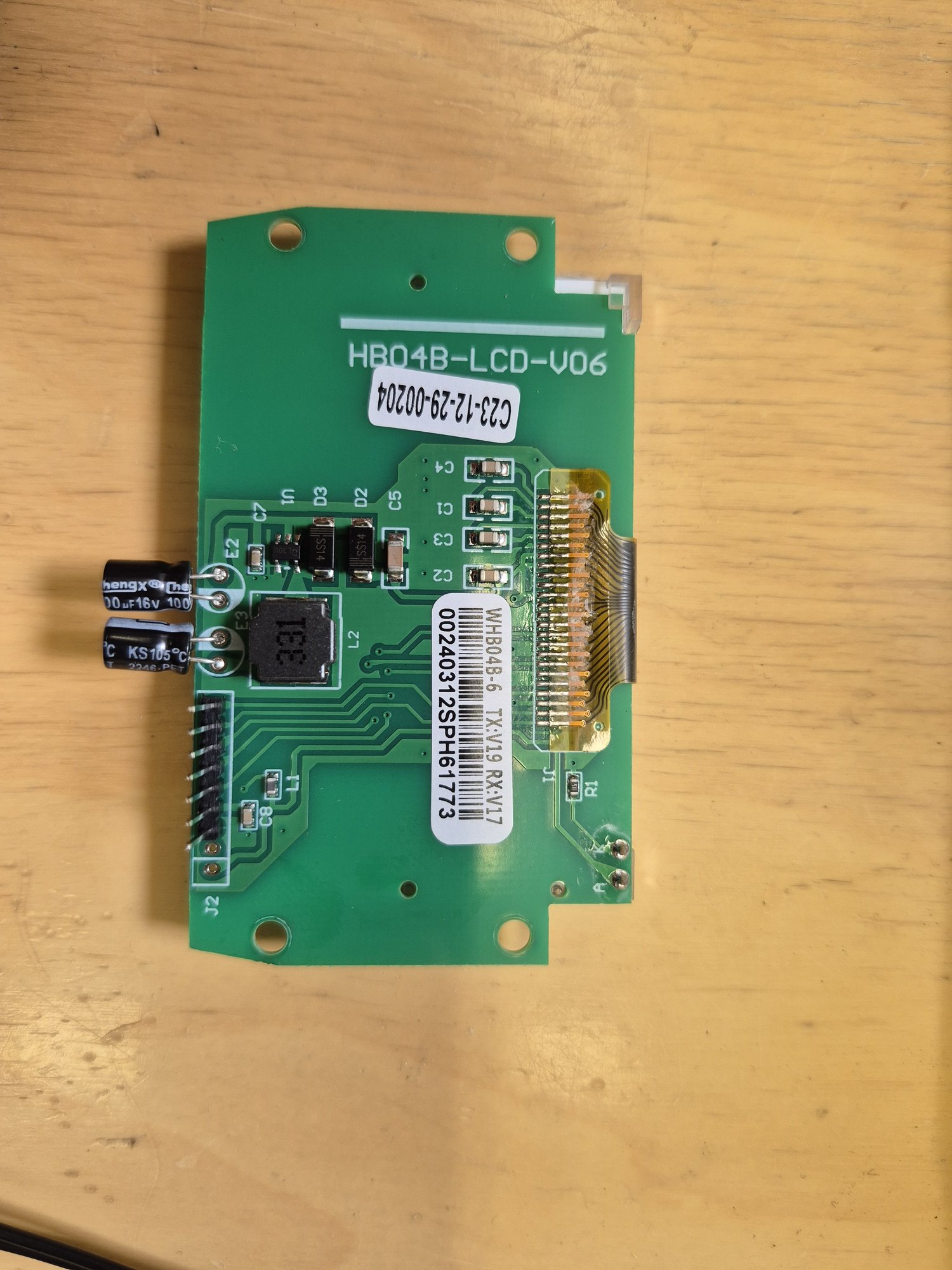

you might try to read the firmware by glitching the voltage, I did that with an STM32F0 part in the past (but another application), I was even able to re-flash the image. I don't know if it also works with the G0, but you might try. Most importantly is to remove the capacitors.
sec-consult.com/blog/detail/secglitcher-...32-microcontrollers/
I will take a photo of the wired USB version later this week since my pendants are in the shop
