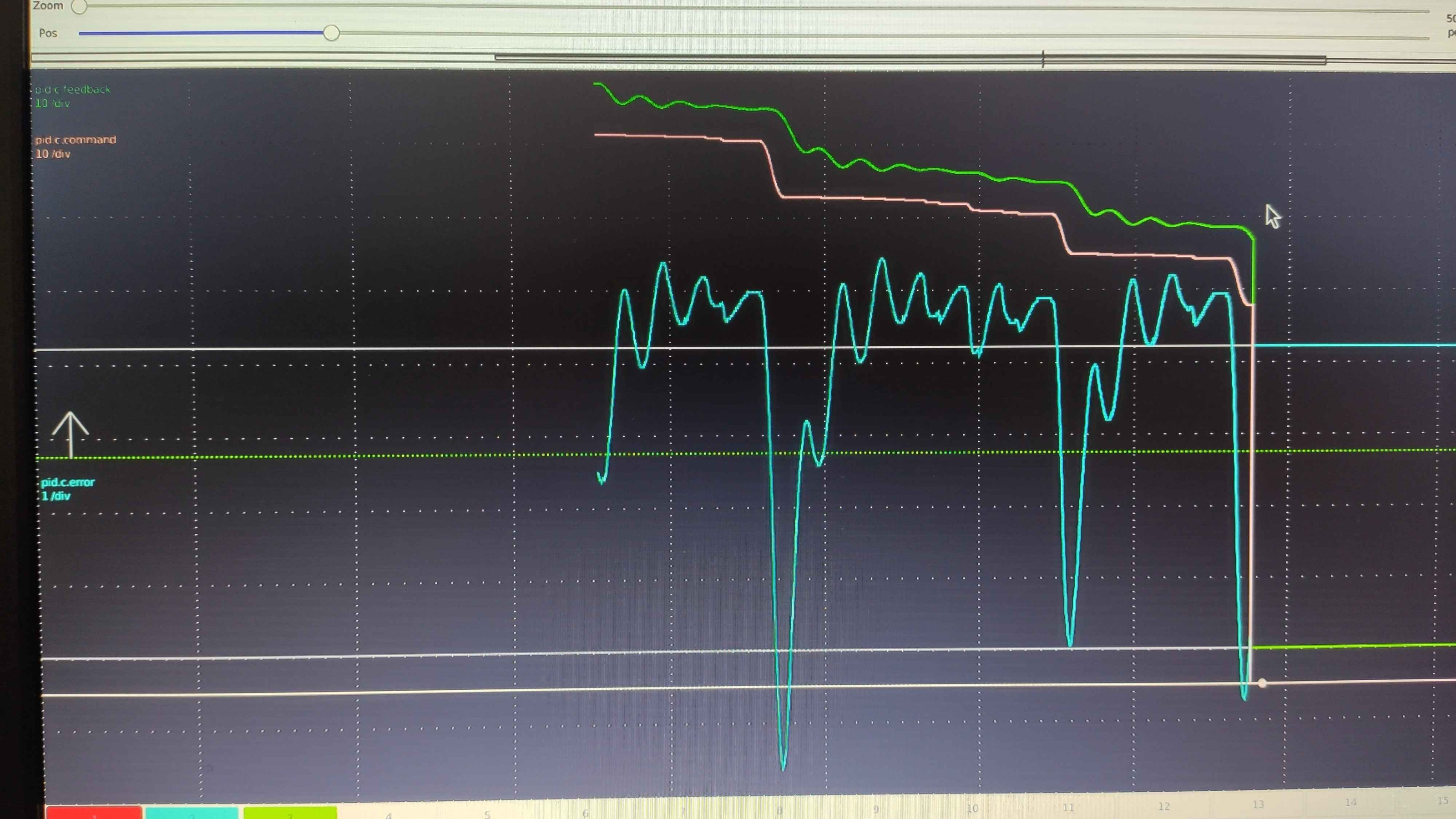

09 Apr 2026 15:09 #345361
by jetbadger
Replied by jetbadger on topic Lathe C axis homing
I suppose having the drive itself in position mode is causing this? The movement is choppy no matter what. I suppose it's because the output is controlling a position step/dir signal rather a speed signal? I wanted to rewire it for speed, but apparently my drive doesn't allow for speed control over digital step/dir signals. I'm sure there must be a way for it to work in position mode though?

09 Apr 2026 18:37 #345369
by jetbadger
The drive is an Astraada SRV-63. There's only analog in and serial for speed mode sadly.
However shouldn't the stepgen treat it like a velocity signal anyway? As in it generates signal until it reaches setpoint, the drive will turn the motor as long as it receives steps, right? I've been breaking my head about this all day and can;t seem to figure out why is even the setpoint from LCNC choppy? The joint.2.motor-pos-cmd is the origin of the signal it seems to me and shouldn't it be a smooth slope, letting the pid loop take care of reaching the values? Can;t seem to find info on what actually happens in LCNC between something like "G0C0" and joint.x.motor-pos-cmd. A bit stumped now :|

- jetbadger
- Posts: 19
09 Apr 2026 22:31 #345379
by jetbadger
I indeed have all the axis stepgens in control_type=1, really all I changed from yours in spindle config are the step and encoder scaling pretty much.
That was sort of a weird for me that other axis work fine, but C axis has this choppy behaviour. Obviously it's the only one with actual feeedback but I tried looping back stepgen pos-fb instead of encoder feedbackk in the hal, which should in my head mirror the setup of x and z axis, however the choppiness still remained. Unless I'm missing something silly again

09 Apr 2026 22:39 - 09 Apr 2026 22:40 #345380
by spumco
Replied by spumco on topic Lathe C axis homing
I really don't know the answers here, but maybe some things you can try while you wait for someone smart to chime in...
Disconnect the encoder feedback and just use the stepgen position - i.e. run it open loop. Still choppy?
EDIT - nevermind, you already did that
Check the step-to-distance values. Do you have really coarse steps per degree/rotation or something? I'd start by:
- Figuring out the maximum input frequency of your drive
- Do some math
- Set the drive's internal steps-per-rotation to as high as possible without exceeding the max input freq at your maximum spindle speed
- Adjust INI & HAL files so the spindle and axis steps-per-whatever match your new drive parameter values
I don't know if either of these will help, but they're free to test.
